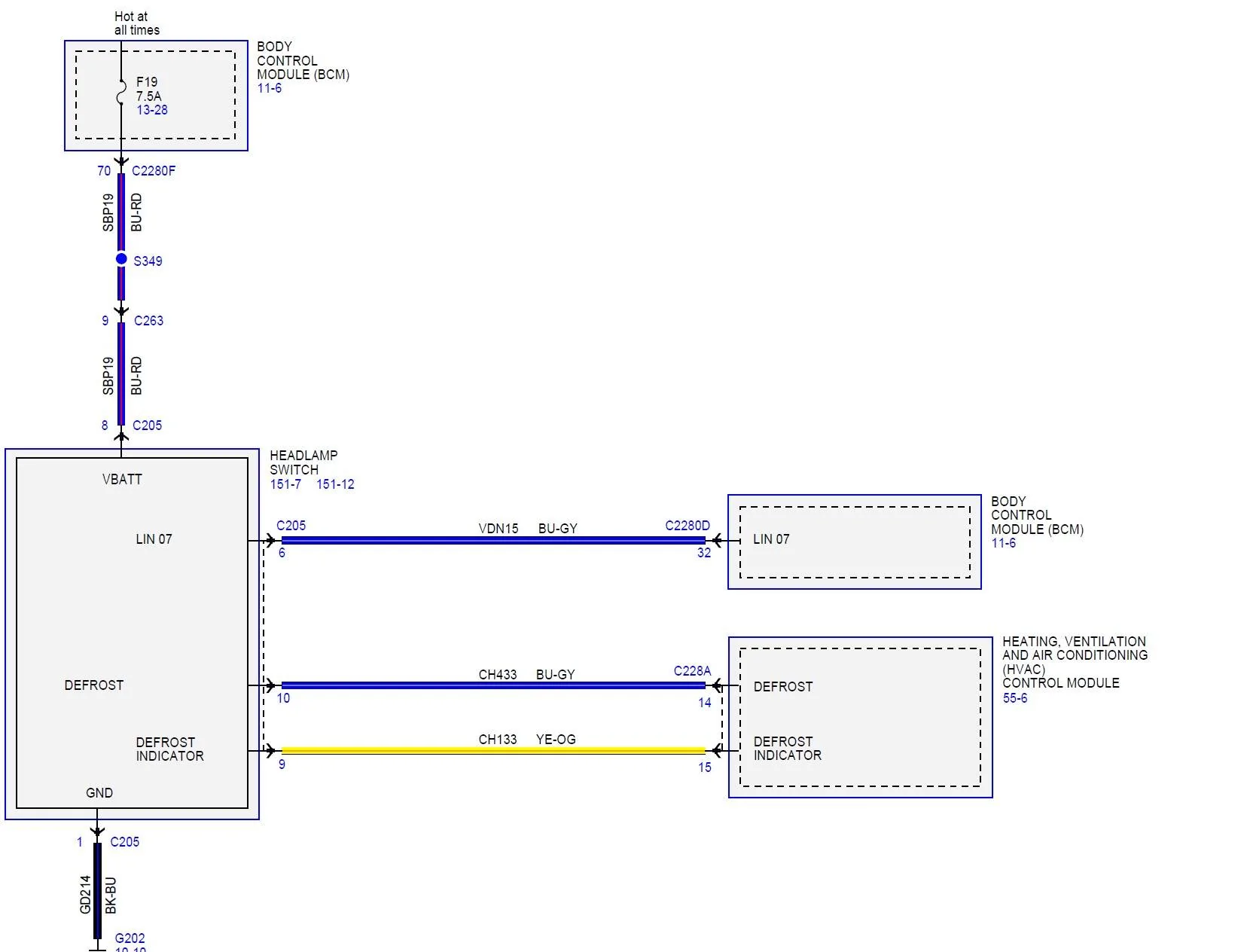

The liftgate switch grounds pin 12, not pin 10.
According to the Mach E wiring diagram, Max Defrost grounds pin 10.

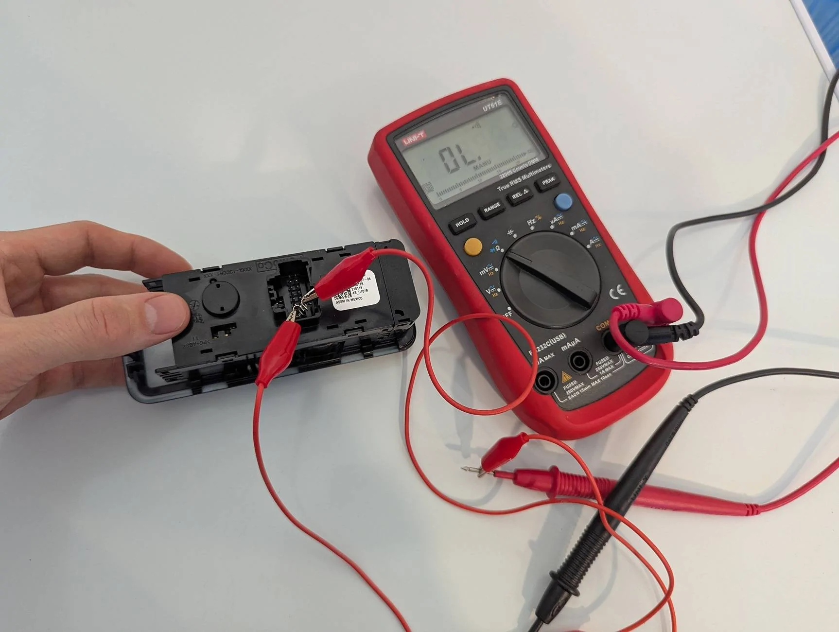

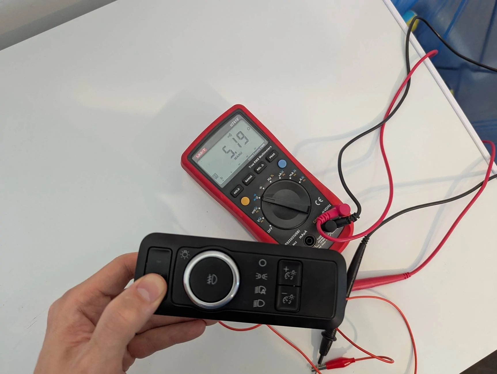

Alright, I hooked up the spare bronco headlight switch to a multimeter with my old max defrost button installed to see what happens when you push the button. I confirm it grounds pin 10. Pics for reference.
