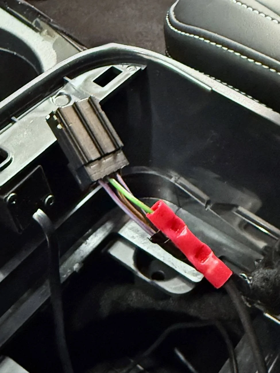

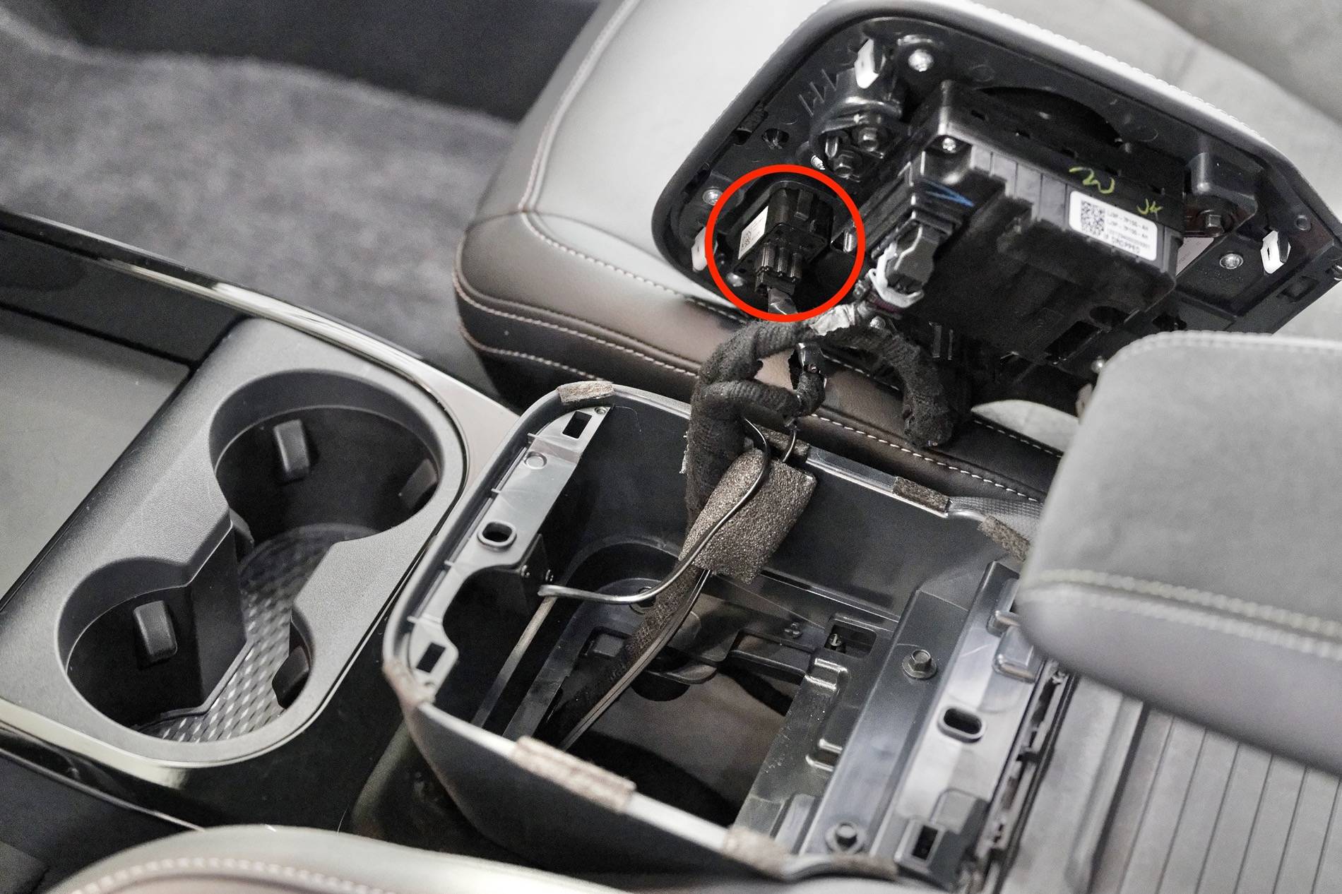

Snakebitten:
In my '21 Premium I installed a momentary hard button under the console (first post in this thread). In my '21 GT I installed an OEM liftgate button in place of the Max defrost button on the headlamp switch assembly (Post 57 in this thread). In my '24 decided to use the useless Parking assist button. It is very simple to do this. I explained in the first post of this thread you need to tap into the single brown wire in the top connector of the BCM and run that wire up to the console. There is a single 4 wire connector under the hazard/park assist switch. Pull the connector and peel back the tape over the wires so you can work with it. Cut the Green/Brown wire and tape off the wire going back into the loom. Connect the wire you ran from the BCM to the Green/Brown wire going into the connector. Plug back in to the switch and you are done. That is it. One wire from the BCM to one wire going into the park assist switch.
If you want more specifics let me know.
Here are two quick photos
Console top off and location of the connector to the hazard/park assist switch.
My black wire coming from BCM connected to the Green/Brown wire going into the hazard/park assist connector before I taped it up.

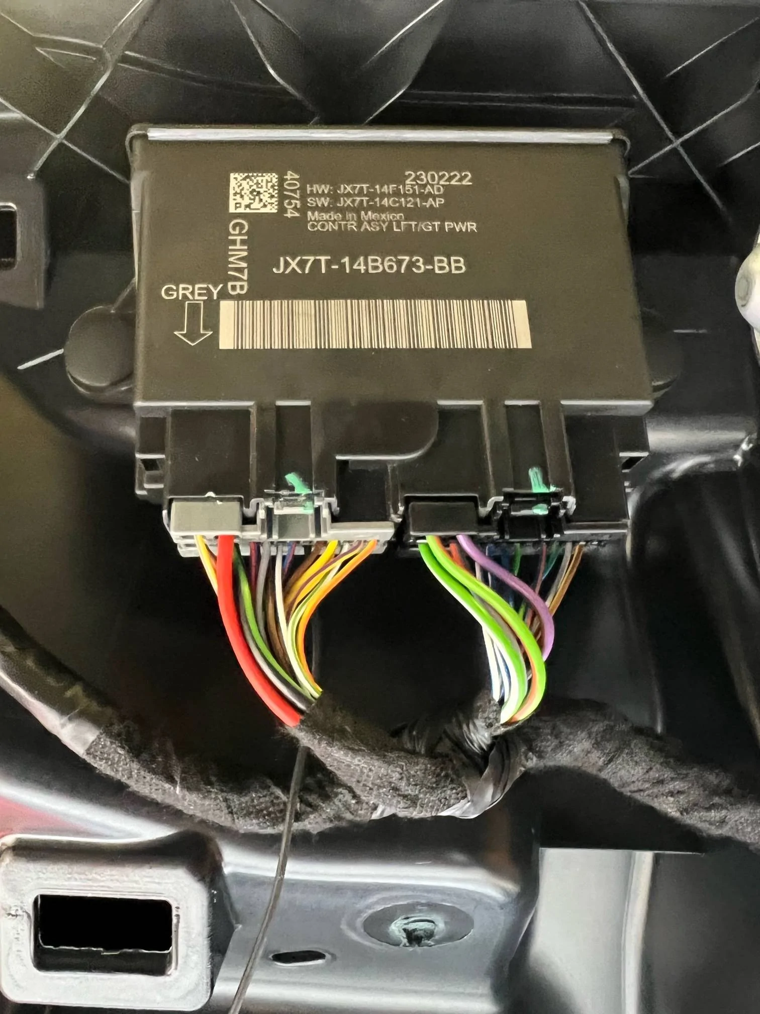

Using a combination of information I got from this site, Reddit and the Mach E wiring diagram I got from easymanuals.co.uk , I added the physical tailgate release button to the headlight switch cluster. This replaced the max defrost button, which I considered to be useless.
At the same time I also added the power liftgate close button to the hatch itself. This button was installed on early Mach Es, but removed by Ford for cost cutting. I also added a front and rear dashcam at this time, but the focus of this thread are the tailgate buttons.

Now that your wire is at the tailgate, zip tie it into place and connect it to another WT1002 pin. This will get inserted into spot 19 on the grey connector of the RGTM module.
Ford Mustang Mach-E Adding a Physical Interior Liftgate Power Switch {filename}
Your front trunk release button should now work. Next I added the rear closer button. This is an illuminated button and power for the light would normally come from the BCM. For ease of installation, I tapped into the tailgate interior light instead (not the license plate lights like a different user, I think the logic for the interior lights is closer to what I wanted). I used wire taps for this, although soldering and heat shrinking would've been neater and in hindsight I should've done this.

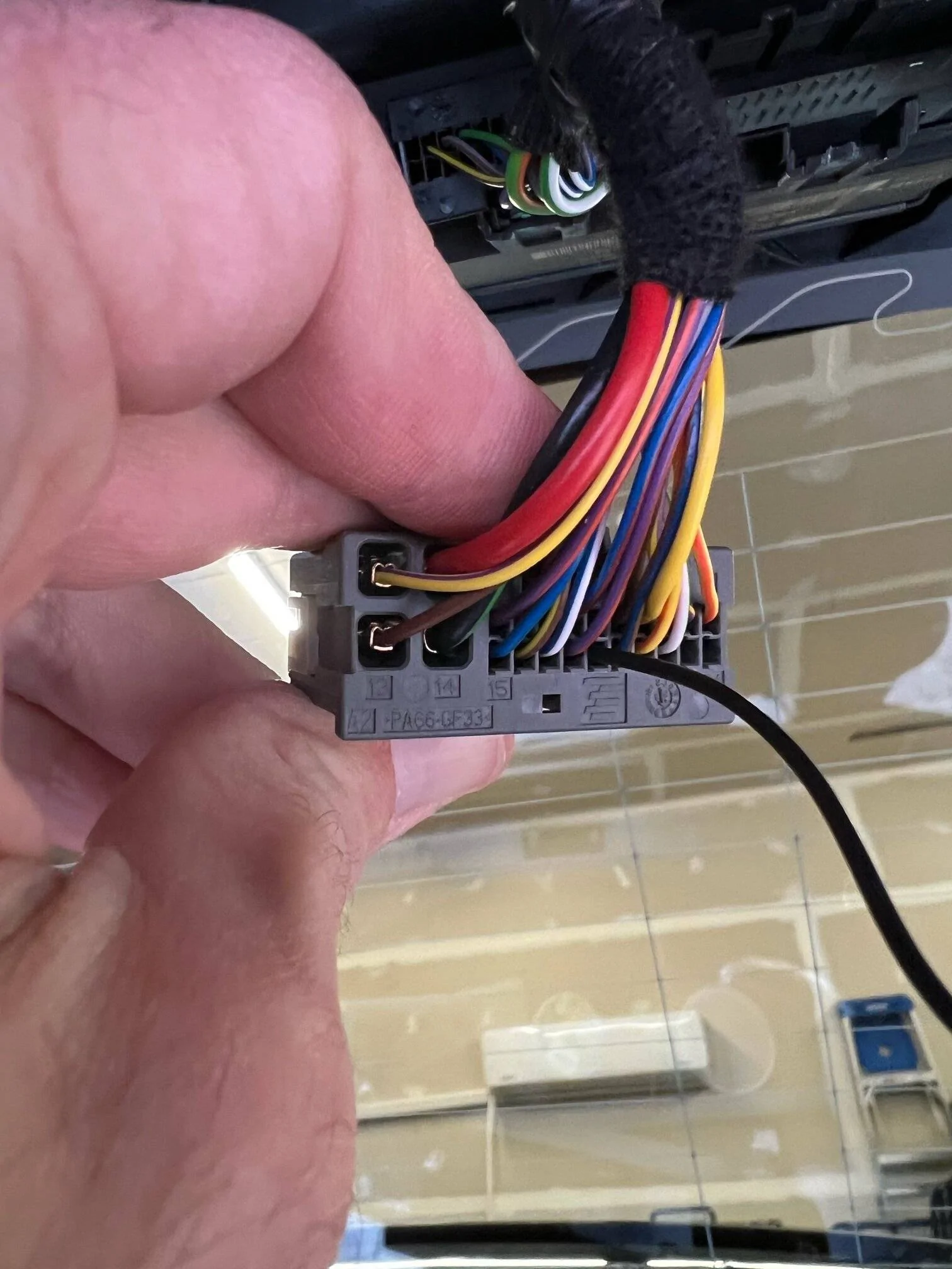

The stock Ford connector for the closer switch is absurdly expensive, so I used generic Amazon pins and a healthy amount of hot glue to connect to the switch and hold and insulate everything in place. You can also use WT1002 pins in place of the Amazon ones.
Pin 6 of the switch goes to pin 20 of the grey connector on the RGTM (right next to the one I added on pin 19 in the previous step). Pin 2 is grounded at the interior light connector as shown above and pin 3 picks up power for the light here as well.
