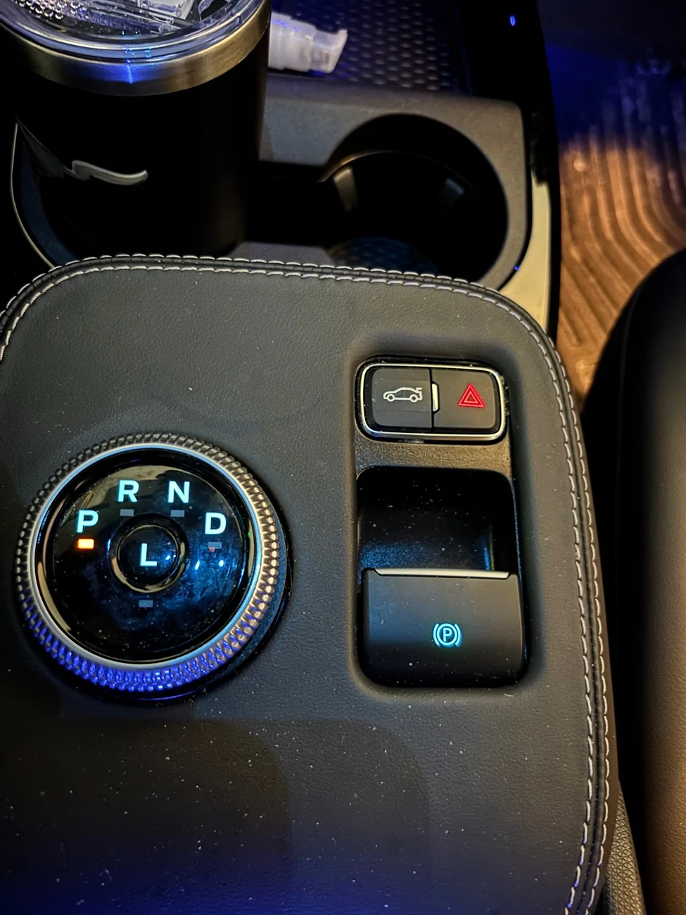

I’ve mentioned in other posts that I repurposed the “Park Assist” switch to open the liftgate by running a wire from the BCM as @markboris had suggested in earlier posts.
I found a sticker on Amazon to show the new function of the switch. Doesn’t match the style of the other icons and it seems to show more of a trunk opening then a liftgate but I think anyone who uses it would get the idea.
One thing that Mark mentioned and is true of this sticker is that it blocks the button from being lit up by the buttons LED.

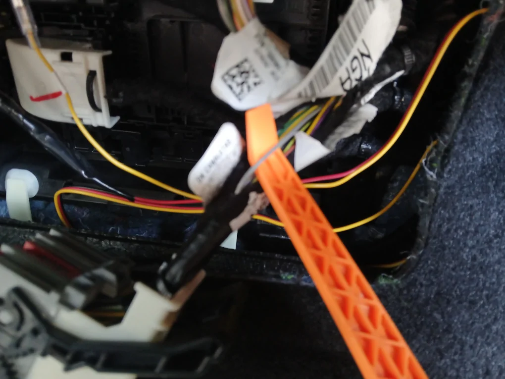

You guys make this sound so easy. :crying:

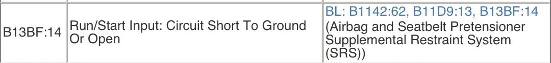

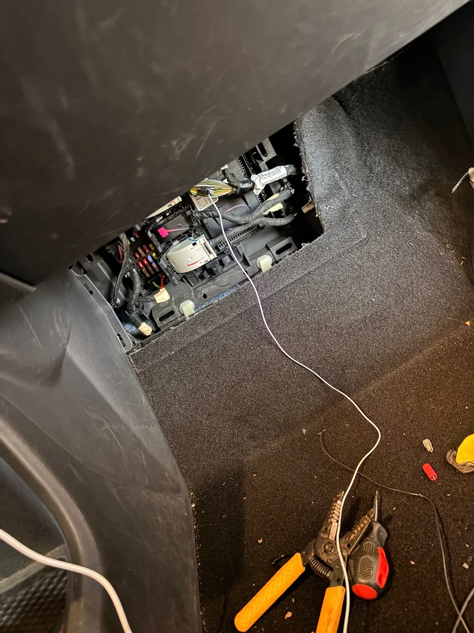

I found what I thought was the correct wire. I checked all the brownish wires and they were all striped. The purplish, tannish, unstriped wire matched what some others have shown, so I tapped it.
To test it, I need to ground the wire, which I think can be accomplished by touching the wire to any exposed metal. I chose the passenger door hinge. The wire sparked, which I did not expect. I touched it again, and it did not spark, so I probably tapped the wrong wire and blew a fuse.
When I turn on the car, it says the passenger door is ajar, even when the door is closed. I checked CarScanner, and the car is now throwing B1142(62) and B13BF(14).
I think this confirms that I blew a fuse, but I don't know which fuse. Help, please!

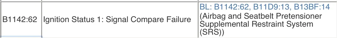

Were you in the correct wire harness? I cannot tell from the photo but that obviously is not the wire.
Here are your code explanations. I will look up the fuses. What year is your car?

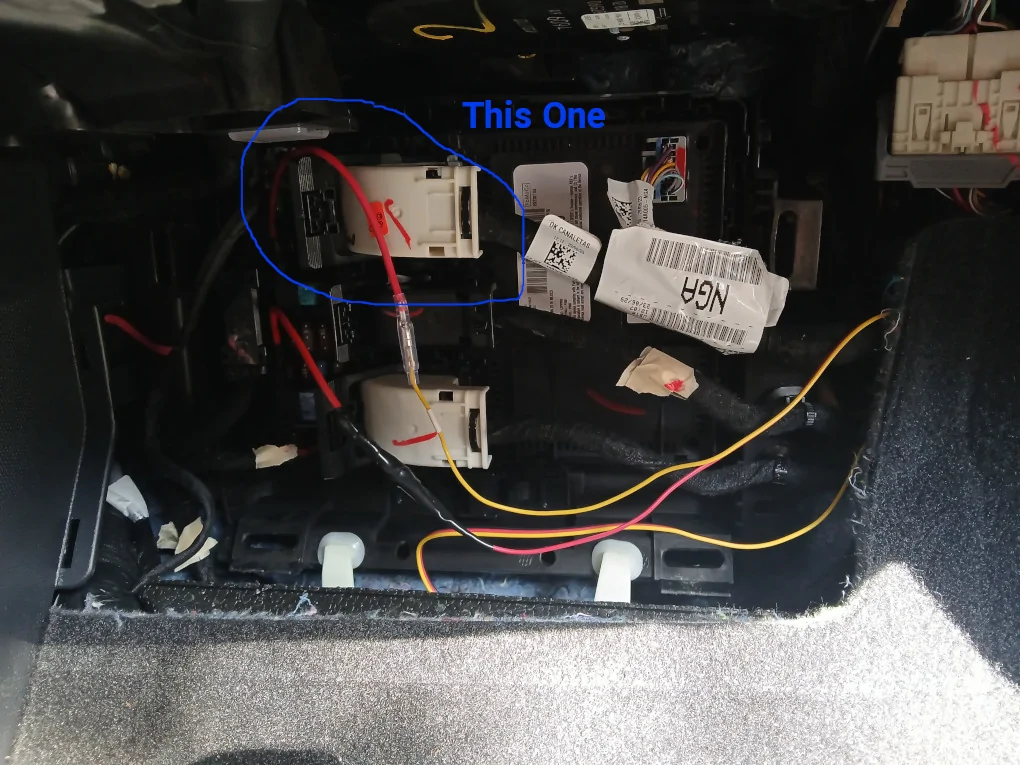

It is the top-most harness in the passenger footwell.
2023.
That is the correct harness. I also remove the little connector to the right of it so it gives more room to pull the entire harness down.

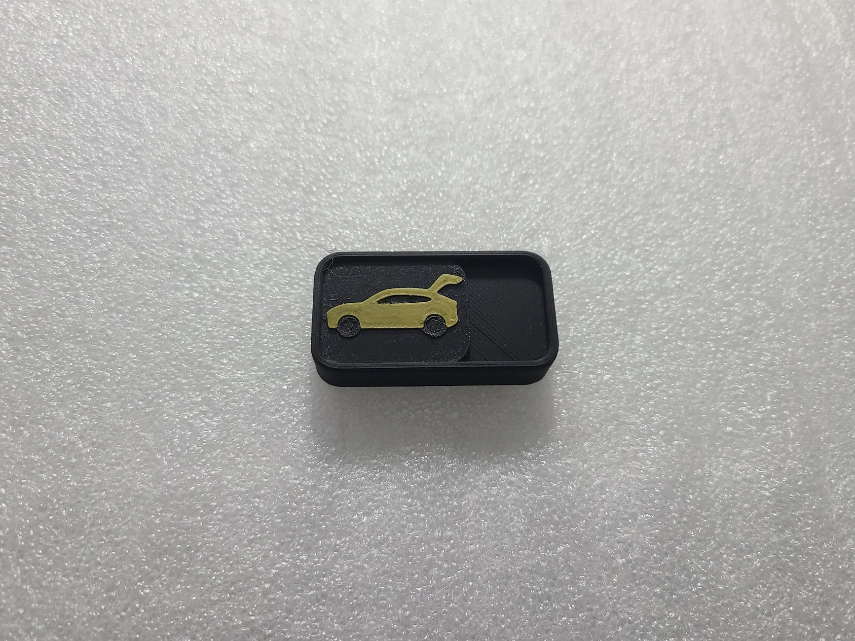

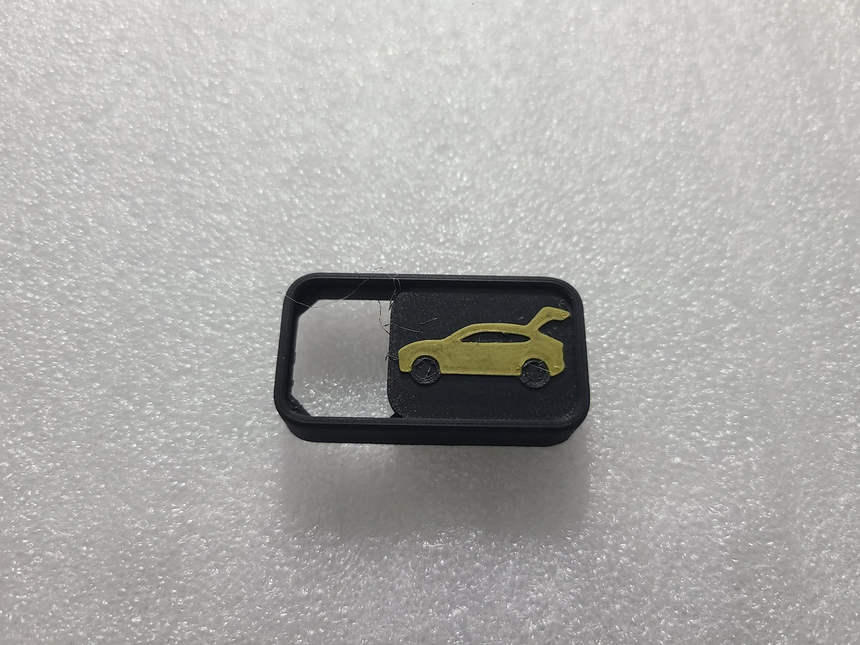

Someone on this forum was asking for a way to block the button from accidental pressing. I am selling a cover for the hazard triangle but that can easily be modified for the park button. I need feedback. What should I do about the wheels and tires when the base color is already black? I raised them a bit, but it still does not seem perfect. Any thoughts?

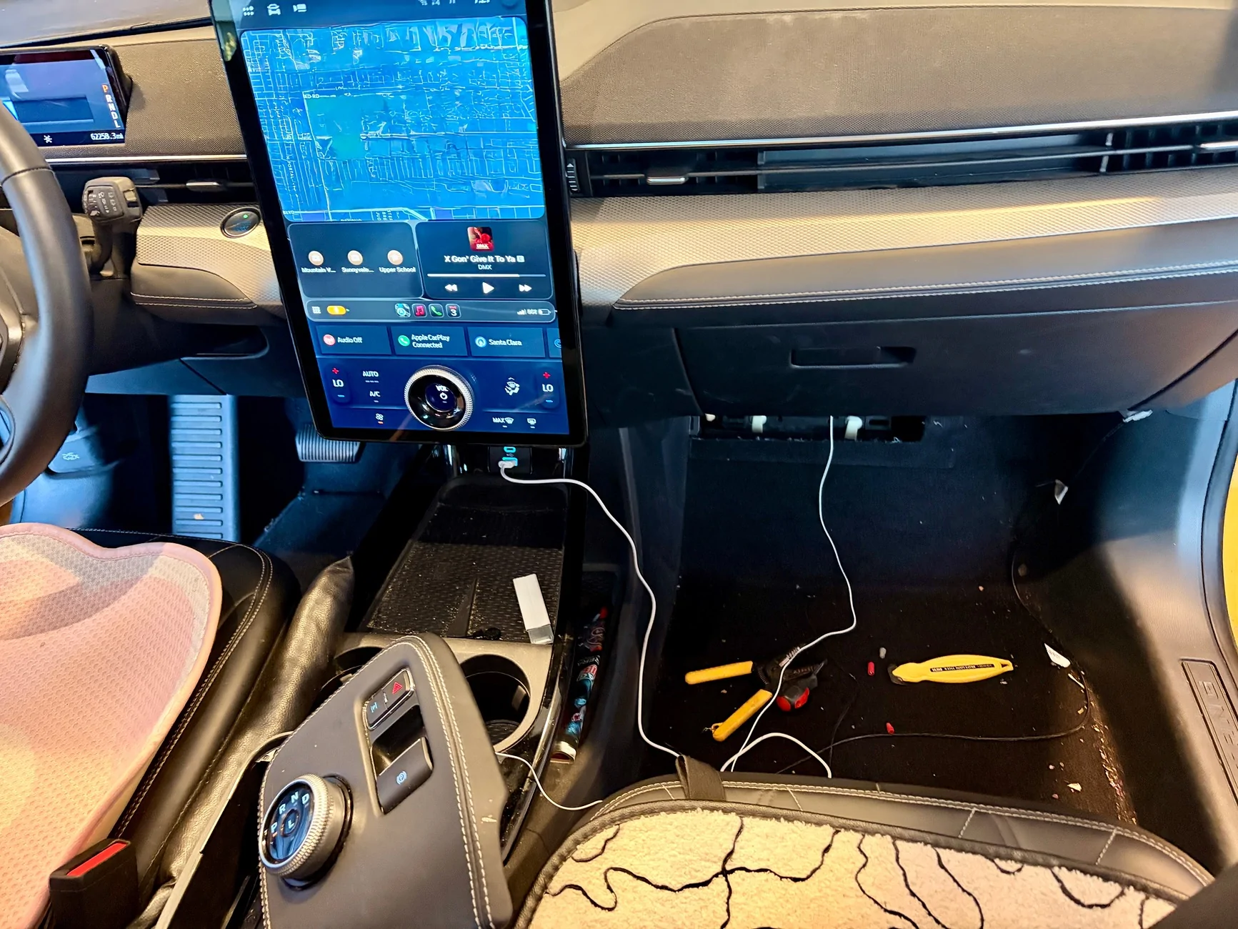

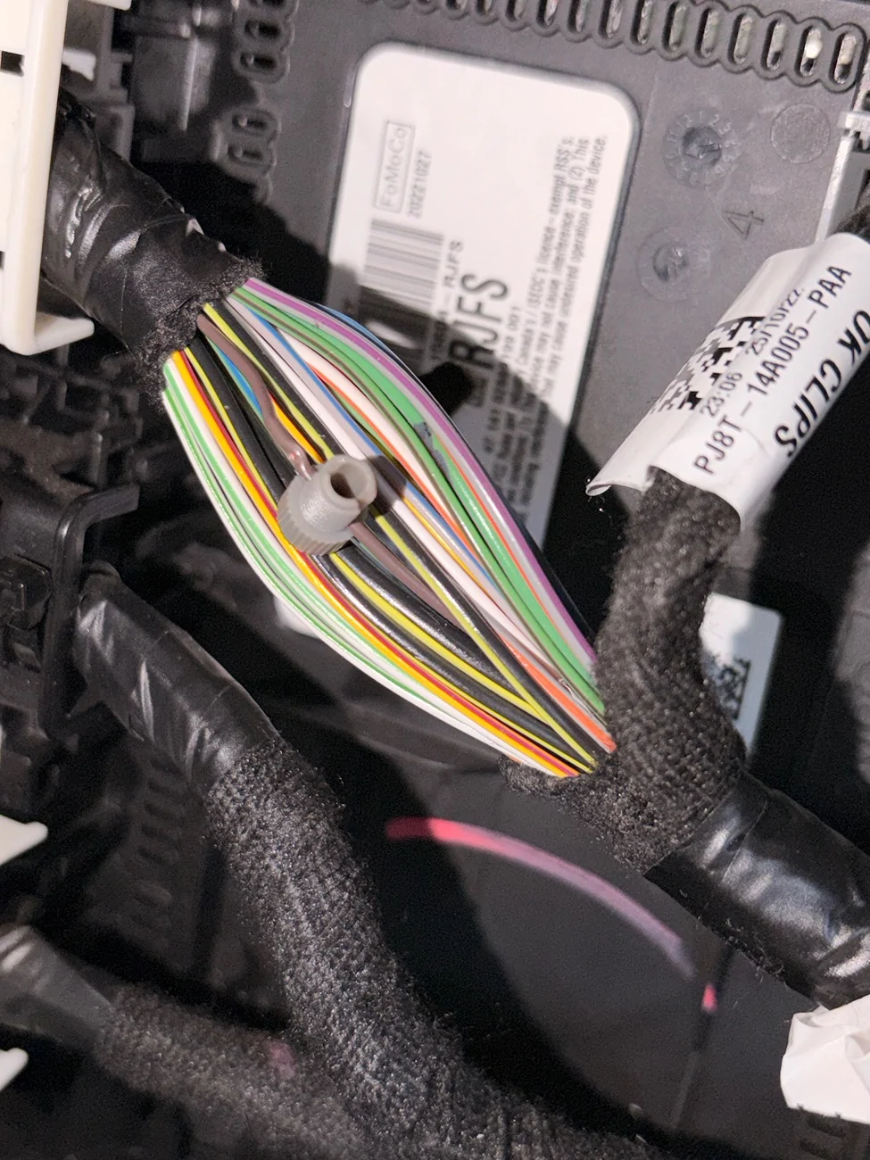

Wired up the useless park assist switch to open the trunk yesterday on my mom's car. I have very little experience actually working with the car (limited to replacing the door latch on the passenger door that broke) but figured it out eventually. Spent 20 minutes trying to figure out how to detach the cable from the BCM, but finding the brown wire wasn't that hard.
Wired it together using the plastic positaps but it didn't work. Thought it might not have been possible since we have the base base model without a power liftgate. Turns out the positaps just weren't making a great connection so I opted for twisting the copper together and some electrical tape.
Works great now, mom will be happy as long as she remembers to shift it into park and unlock the doors
