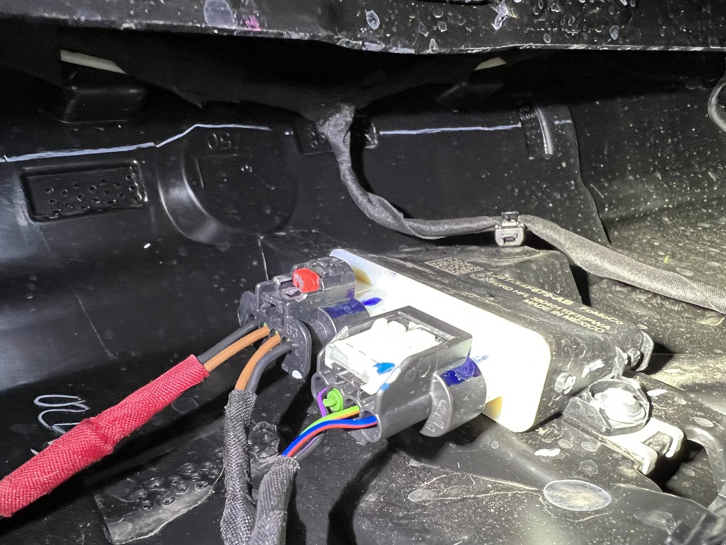

My 2022 Select had a scheduled build date of 10/10/22 and was delivered in early December 2022. Like several others, I did not check for the hardware and just enabled the feature with Forscan. I excitedly went to see if it worked and kicked and waved my foot under the back of the car with no luck. Disappointed, I decided to see if the hardware was installed. I threw a towel on the garage floor and grabbed some tools, stuck my head under the car and heard CLICK, WHRRRRRRRR. The tailgate opened, lol. Just needed to practice my kick I suppose. Works every time now. Can’t believe that the hardware was there and just disabled via software. Thank goodness for the helpful folks on this forum.
