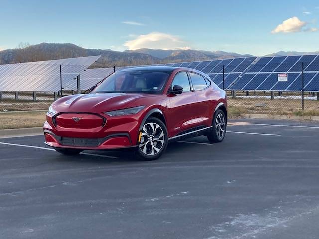

We installed a 10kw system about a year ago and just added the Mach E to our garage. Thrilled to be driving solar powered miles! Have not charged at a public charger yet.

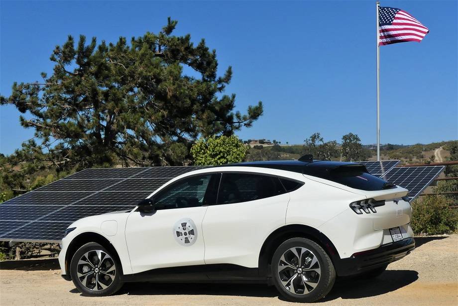

We have a 7.5 kw system that produces a peak of 51 kWh daily in summer and a low of 29 kWh in winter. I charge up once a week to 95% on one of my days off (whichever is sunnier) with our pool equipment turned off, and have yet to use a public charger. I'm not tech savvy enough to know what percentage of the charge is coming from the solar panels, but I'm confident it is very high.
We live in an area with a very high percentage of clear sunny days so I feel this setup is a no-brainer and well worth the investment. A Tesla battery provides our nighttime electricity needs and ensures we are not affected by grid power outages.

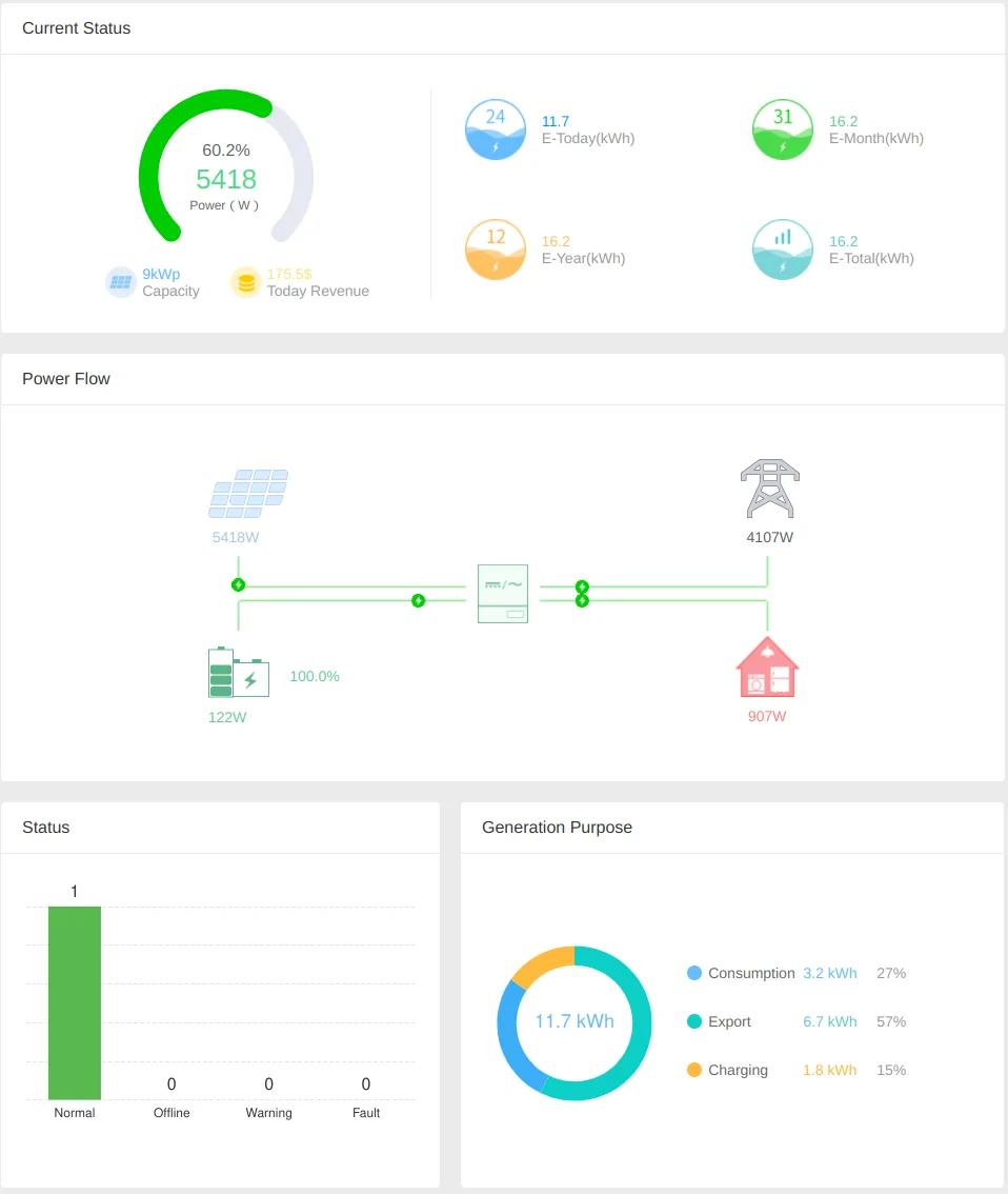

Overproducing in the middle of winter is a fun feeling. We received permission to operate last week and did our final configuration yesterday. So far today, just before noon, we've sent 57% of our generated electricity to the grid. Now we just need to get our Mustang.

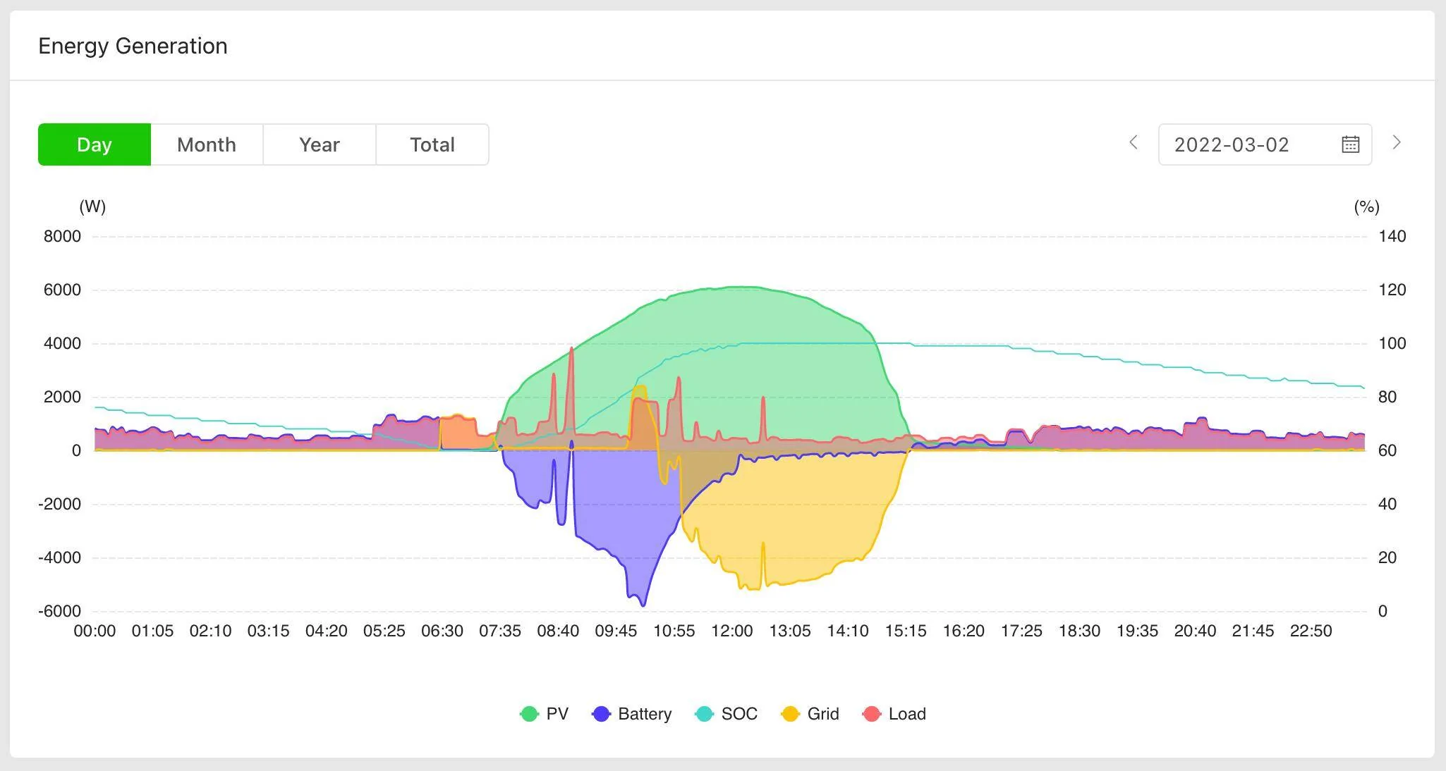

On 2 March we were on solar + battery for 23.5 hours, and this includes charging the Mustang and the house storage.

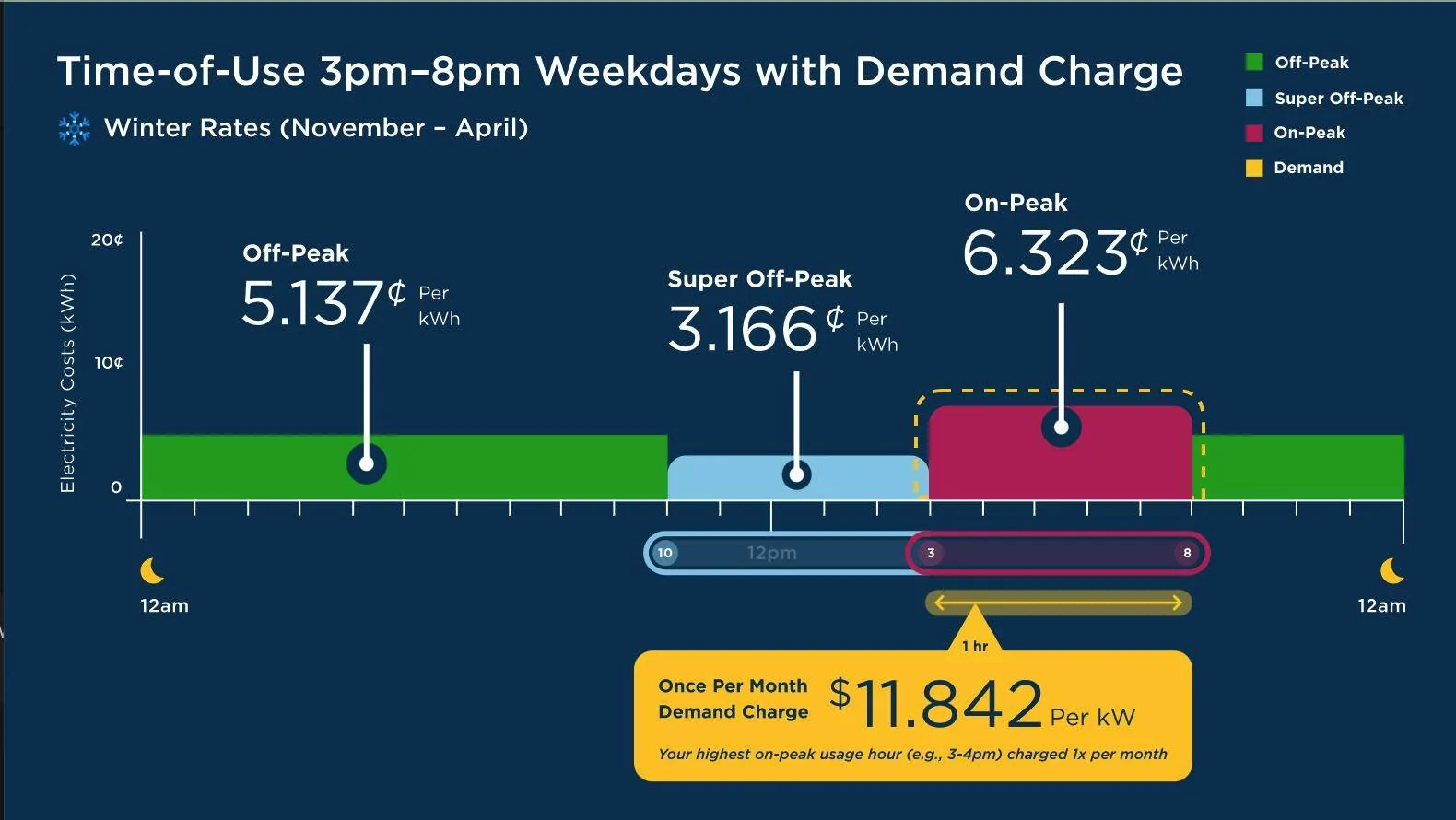

Our utility charges us extra for peak use times and significantly less for super off-peak times.
Summer doesn't have super off-peak and generally higher rates throughout the day.
So, at least in the winter, it's best for us to charge both our Mustang and our battery bank. from 10:00 to 15:00.

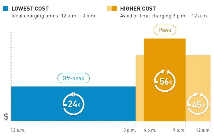

These are the EV2-A and EV-B plans offered by PG&E, which I passed on. It is a good example why so many people are leaving California. I chose a plan that is 31 cents off-peak and 38 cents weekdays 5:00-8:00pm. That is why my charging timing maximizes solar and minimizes sending power back into the grid.

Yeah, that looks super high! Especially if you also pay other costs on top of that. Our average cost before we installed solar was about $0.25/kWh, despite the advertised costs of less than $0.10/kWh. Much of that is "generating fee" or "meter reading fee" even though the meters are on a mesh network and read themselves.
