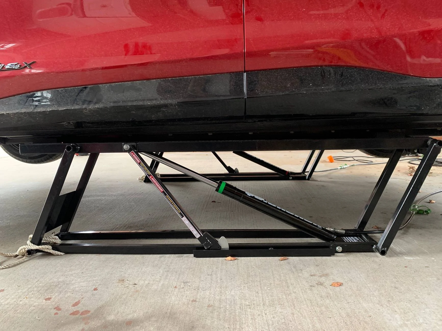

They've only been sitting on my garage floor for about a month. These are the 7k lb version, if you're wondering.

Thanks for posting! I've been looking into getting a set for a while now. I've got a decent floor jack and stands, but this looks just so much more convenient.

Ya, the Mach-E is just such an oddball to lift (like any other EV, I assume) with the battery that I wanted an easier way to get it up in the air. So far so good. The other option I tried was Harbor Freight's floor jack cross beam. That would let me lift in the middle of each side and still get jack stands into the proper spots to get the whole car in the air. It works... but again, with the clearances needed, it's cumbersome.
And what are those blocks you are using?
Those are the rubber blocks that came with it - but I think I'm going to find something else. These work, but I have to stack the "medium" and "tall" blocks that come with it to get the clearance from the battery rails (the medium is 2" and the tall is 3"). The manual says that's OK but I'm not a huge fan of the two piece setup. So I want to measure what I would REALLY need and get something that's a single piece.
I also bought the pinch weld blocks (mostly for my wife's car) and the SUV pad set (which I have not tried yet). The SUV pad set might be enough but I'll just have to get it in the air again to decide.
Oh... and these things are HEAVY. I had kind of hoped they were slightly more portable so I could maybe take to the race track or something but, holy shit, they are cumbersome to move around. Each side frame is almost 100 lbs - thankfully there are wheels on one end so you can roll them around a bit.

There are two safety latch positions, so the manual instructs you to lift past one of these positions to a specific point in order to secure the lift (my photo is currently at the lower of these two positions). You then let it back down onto those stops. It's not going anywhere. I think you could even disconnect the quick connect hoses and move them out of the way if you needed to - and then reconnect again to lower it back down.
