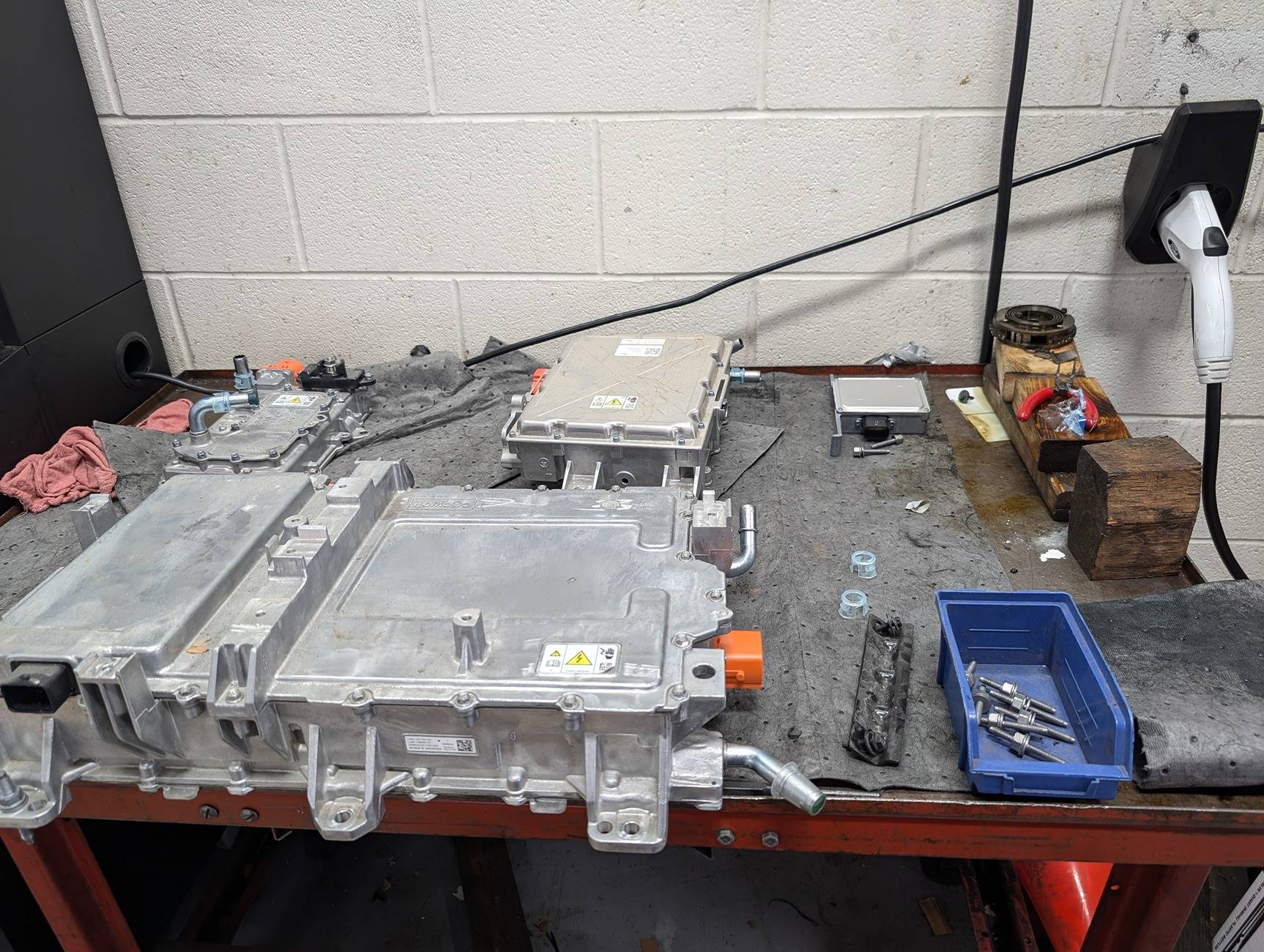

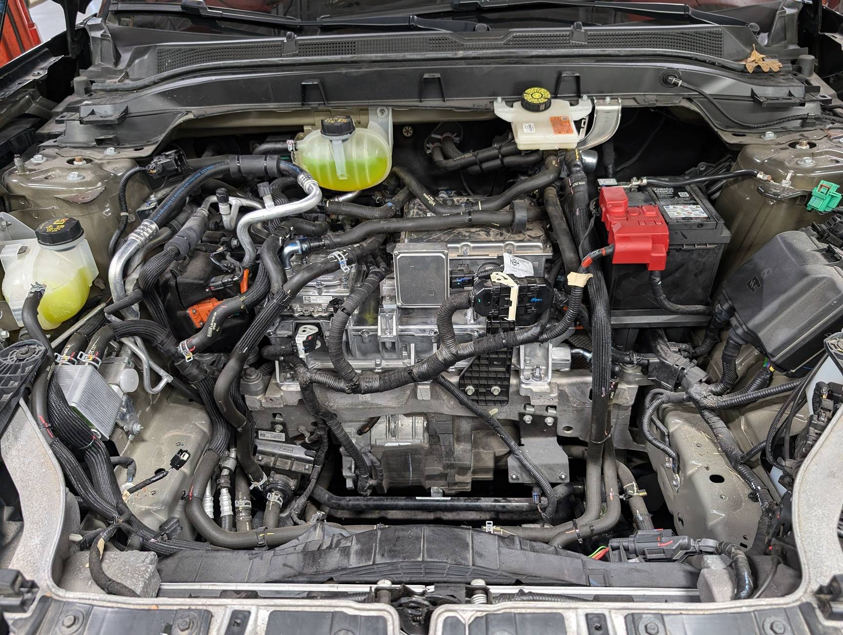

Dealer tech and Mach E owner here, I just replaced an SOBDM under warranty for a customer, an AWD select. I have replaced a handful in the past few years for the same issue, red CSI ring anytime a level 2 is plugged in. I attached some images I took during the repair, the SOBDM is the largest module in the pictures, and is bolted to the top of the front subframe underneath all the other modules. Warranty time was 4 hours. I hope your Mach E is trouble free from here on out! After a few drives it may be worthwhile to open the trunk and pop off the upper trim, and make sure both of the coolant bottles are at the proper level. I lost a lot of coolant doing that repair, and not every tech I have met knows that you need to run a program in the scantool to open the valves and run the pumps to bleed the cooling system completely after a repair.
WOW, that is a significant chunk of the whole assy, and looks like a bit of a bitch to get to!
What would be your best guess as to CAUSE of SOBDM failure ?
I'm wondering what part inside SOBDM is failing that would result in red ring of death on the L2 charger. I'm also wondering if the owners that had the failures used Ford Mobile chargers exclusively, or if they used other EVSEs at higher charge current very often , or not.
heat hot spot from ....? failure in cooling system pump/valve?
All but one of the SOBDM I have replaced set an internal fault DTC, and SSM 51137 directs me to replace the module with no further diagnosis. SSM just notes an 'internal concern'. My guess would be a failed circuit board component or a short circuit like
OP stated. A year or so ago I unbolted the top cover on a failed unit out of curiosity but didn't see anything that indicated a failure. Further disassembly looked difficult and a bit spooky so I just bolted it back together :) I have yet to see any failures on modern cooling system pumps or valves. The only electric pump I have ever replaced was on my old 2005 escape hybrid.
