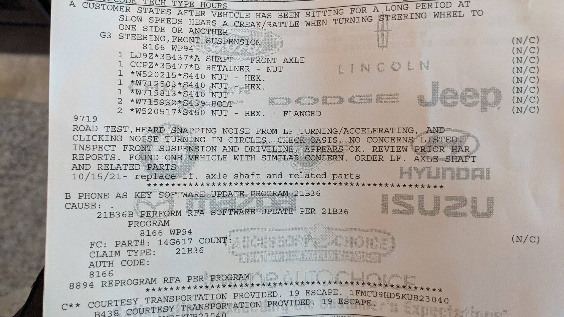

A few months ago I noticed a slight creak in my steering when I'd leave for work in the morning. It would only happen once or twice then go away as I drove further. Well as soon as colder weather hit here in NY, that noise became much worse and even worrisome. Sounded like something was going to break at times.
Immediately got it into the shop. The noise would come and go but luckily the tech heard what I did. Turns out it was the axle shaft. The note from the dealer states that after some research they had found only one other Mach E to have had this issue. They said there wasn't a concern to keep driving it that way... Just really embarrassing for a nearly 60 grand vehicle.
This is from my First Edition long range.

It was about a week to get the part in and my dealer was able to get it installed within 3 hours.

Did your noise resolve after this fix? Some of us in the other thread are reporting the noise remains even after the axle / drive shaft (halfshaft) was replaced. Myself included. Dealer continues to investigate.

After I posted this, the noise/clunk was still there. I immediately called back the dealer and got it scheduled again, at which time they said it was now the passenger side shaft. I was skeptical at first but I can say that after both shafts were replaced, the noise is now gone.
It took around a month to get the new part in, which was a huge difference from the few days that it initially took the driver side to come in. In the period that I was waiting, the noise got even worse. I went from occasionally hearing it after the car sat for a while, to literally hearing all the time. Super embarrassing.
