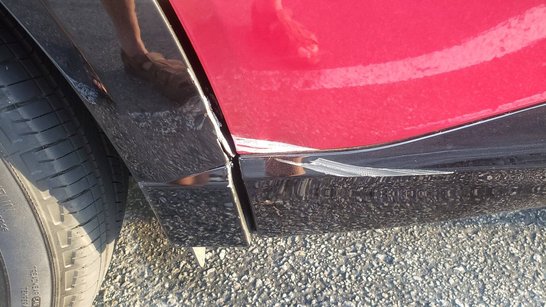

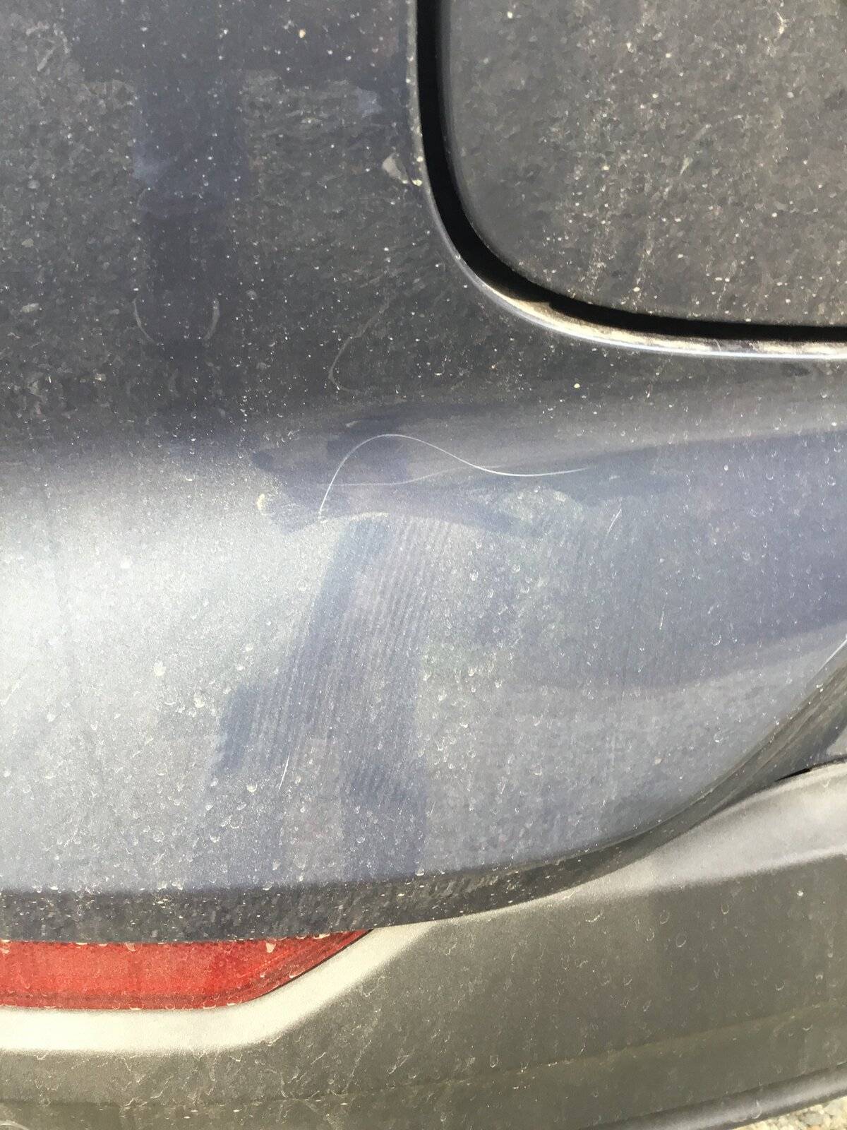

I went away for 12 days. I left my Mach E in the hands of my son, while I took his Jeep to the airport……and when I returned, this.……. And someone knows they did it, as it was wiped off with fingers in the photo….no one has come clean yet.

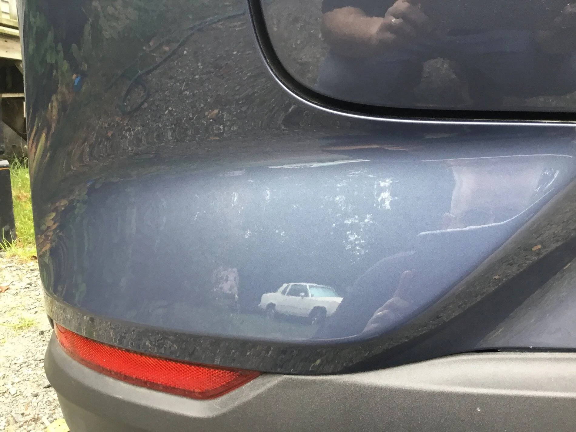

but with about 20 mins of my elbow grease, a microfiber, cotton cloth and some compound, it’s gone. ……. The scratch X not so much, I tried it first for 8 times, it seems to have some oils that fill the scratch, not remove it, but the TW compound seemed to remove it in 2-3 applications, and with a sturdy cotton cloth. Recoated with Hybrid Solutions ceramic and it’s like new again.
