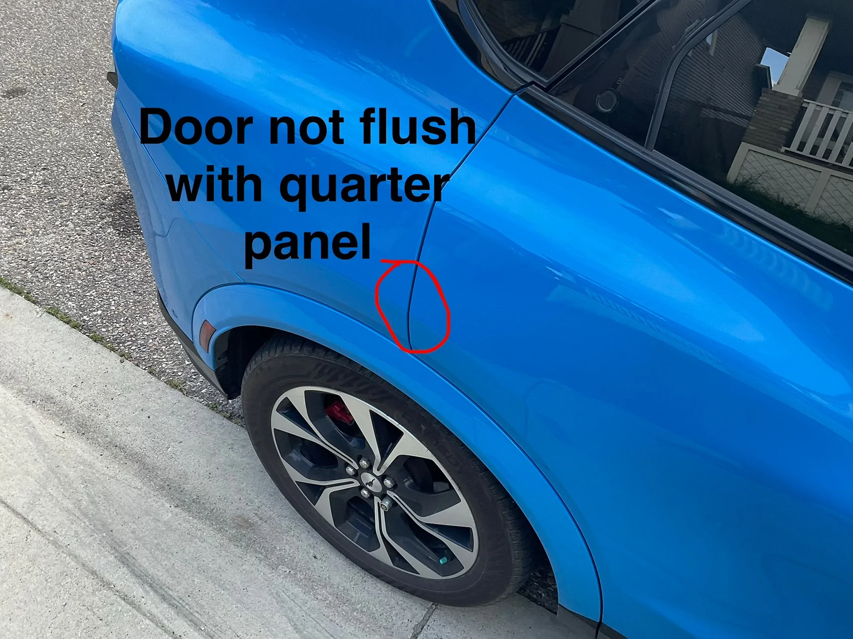

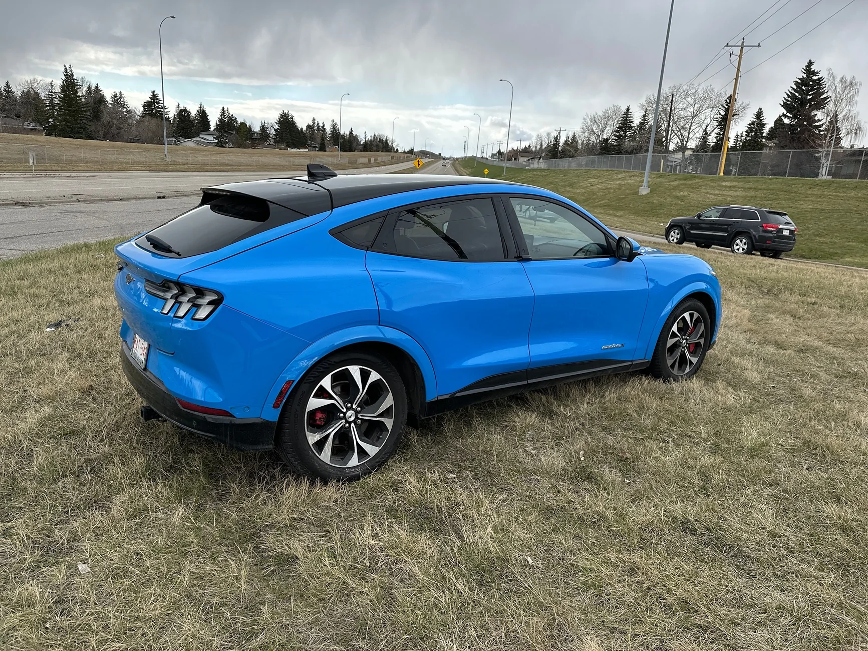

I got in an accident back in April that was recently fixed. It got hit in the lower right quarter panel. I have attached pics of the damage.
I got my MME back and I noticed there are some gap issues.
I am a somewhat neurotic person and tend to notice them more the average person would.
I have requested an appointment to have them fixed.
Are they easily fixable?
Thanks

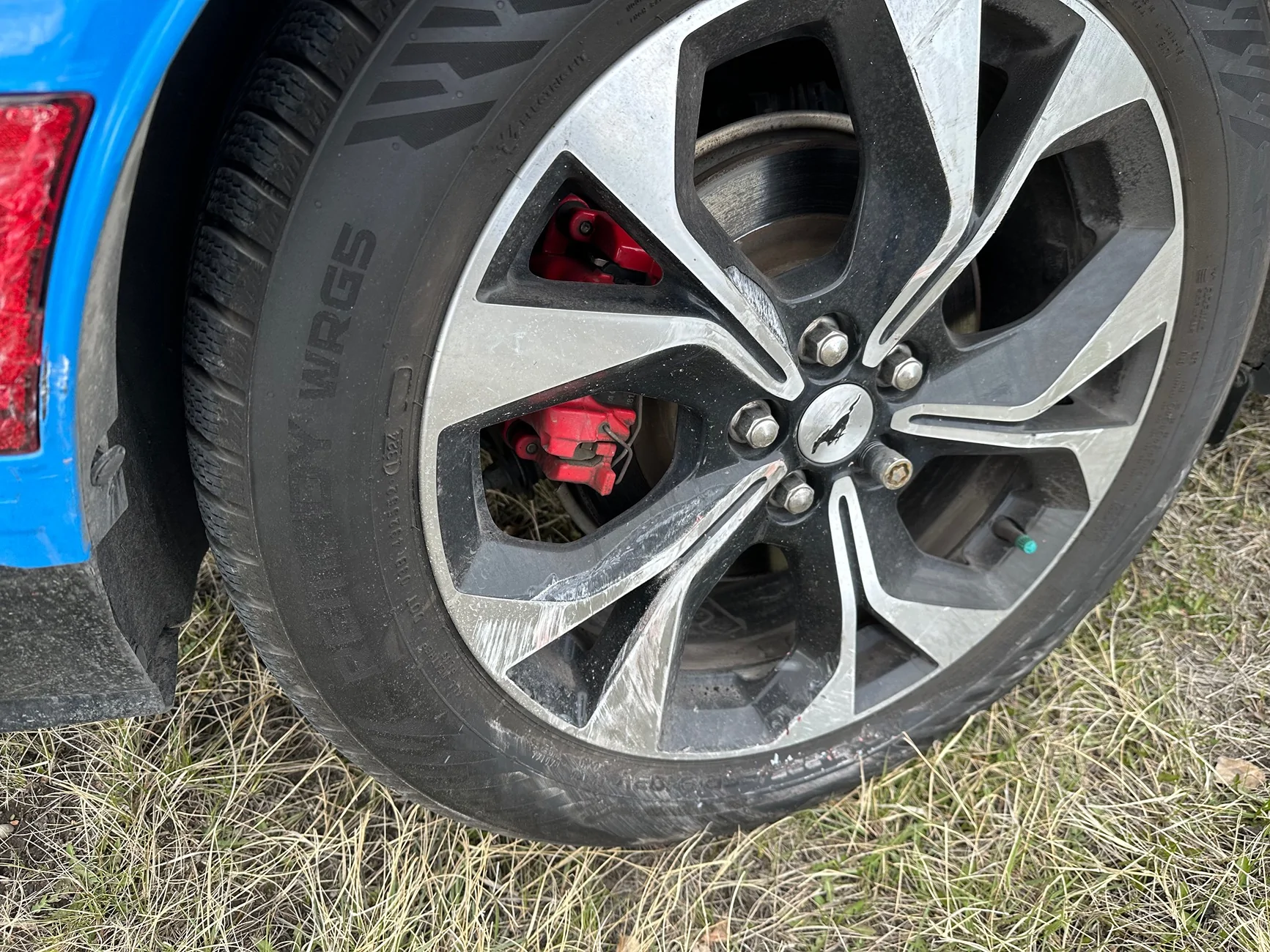

Sadly repairs are not going to be able to keep the same factory quality specs. Some of that you'll sadly have to live with (follow up with the body shop but the door to quarter panel is quite hard to align) I've spent almost 2 hours aligning my rear hatch to get most of the gaps as close to the same as possible. I doubt the body shop has as much drive and OCD as I do.
I do have a 19 inch wheel here but noticed you're in CA so it's cost prohibitive to send you. (edit: just realized after/before pics)

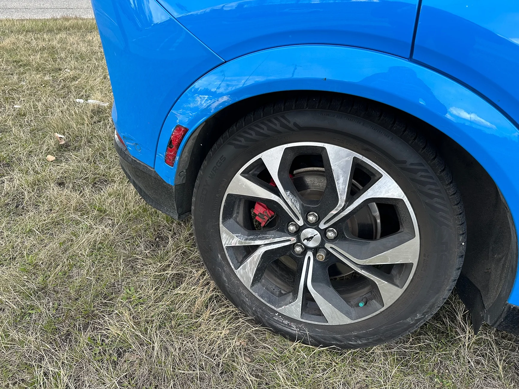

The auto body said they can repair the scuffs on the wheel.
Thanks for your help.

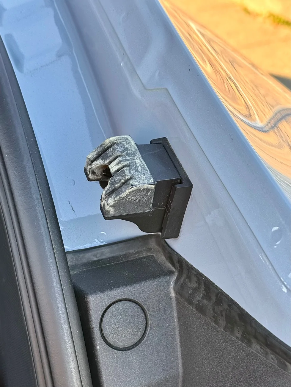

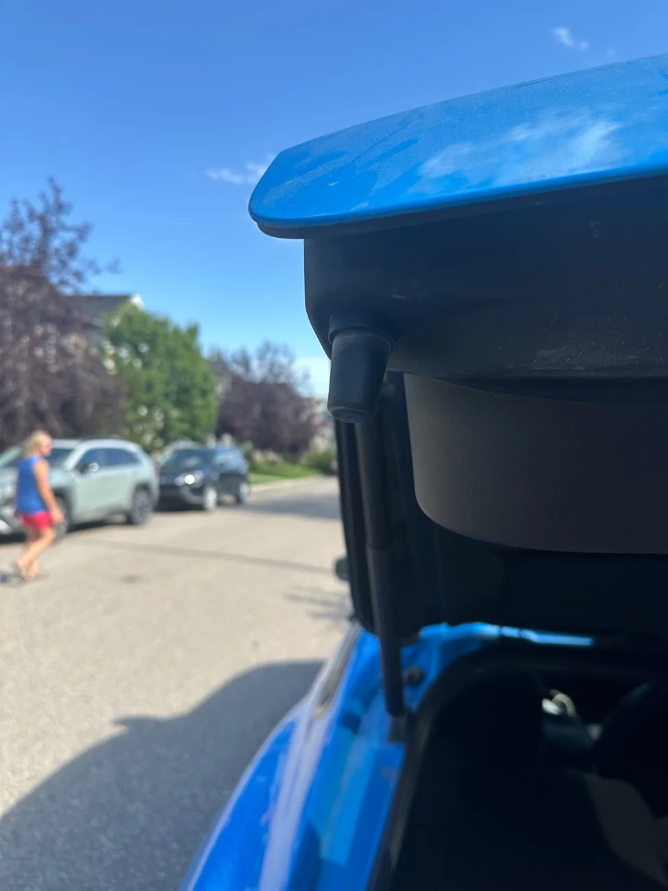

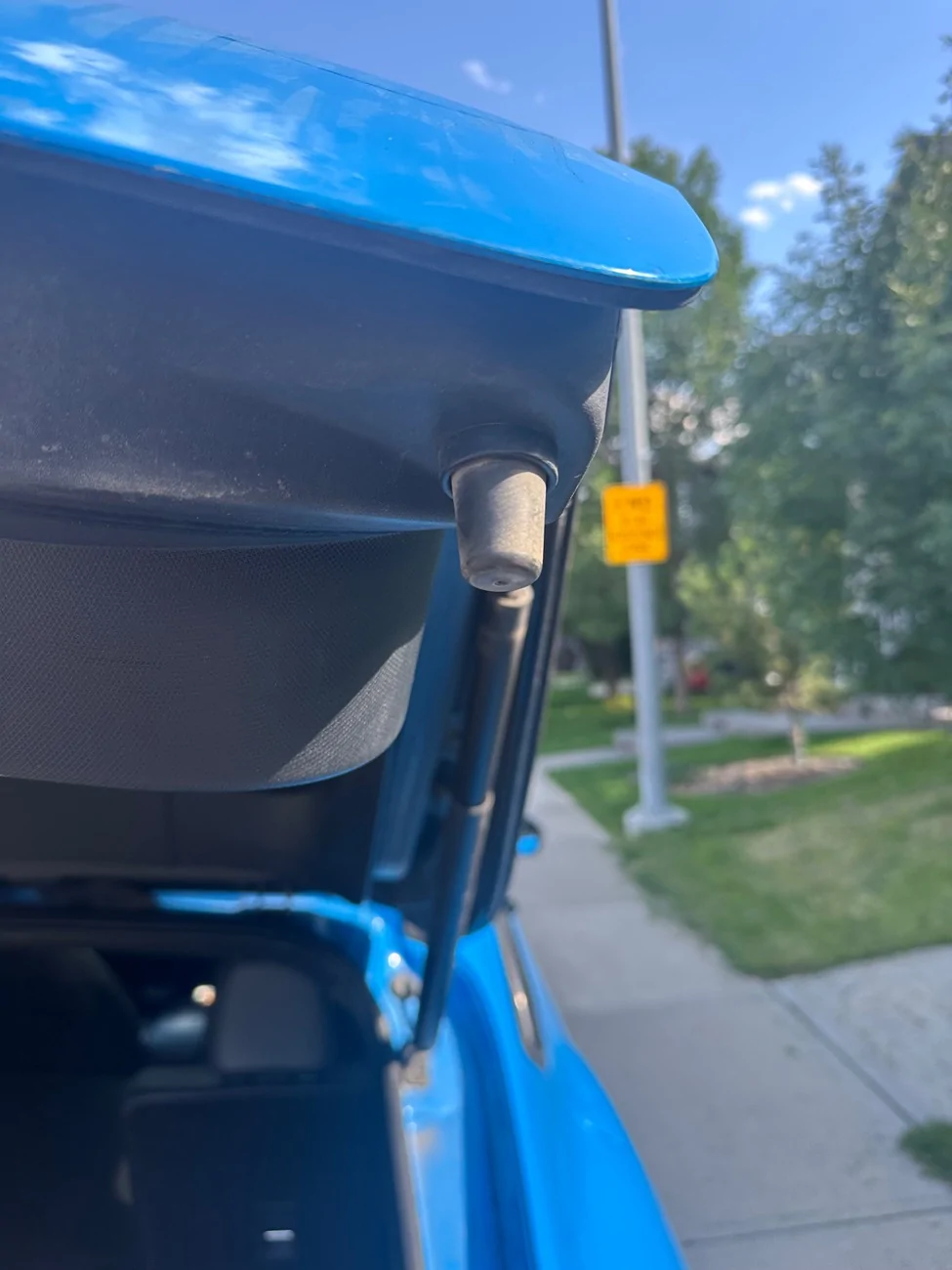

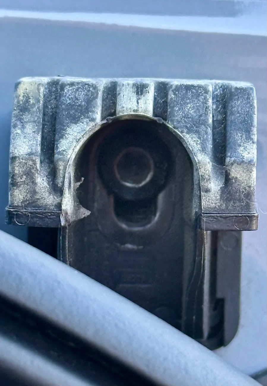

Hey Ed, the gap on your liftgate is easily fixable. There are two bumpers on either side (photos below) of the body. Since you have less of a gap on the right side. Slightly raise that bumper up. You may have to slightly lower the left bumper. Those bumper adjusters will equal out your liftgate gap. There is a bolt inside the bumper. Loosen it, adjust bumper then tighten.
Thank you so very much for your tip. I am going to the body shop tomorrow and I will show them what you told me.
The auto body shoo fixed al the gaps as best as they could and I am okay with the results.
The liftgate gaps were fixed adjusting the bumpers inside the tailgate....see attached pics.

Those bumpers on the liftgate adjust the height of each side. The bumpers I sent photos of yesterday adjust the liftgate side to side.
