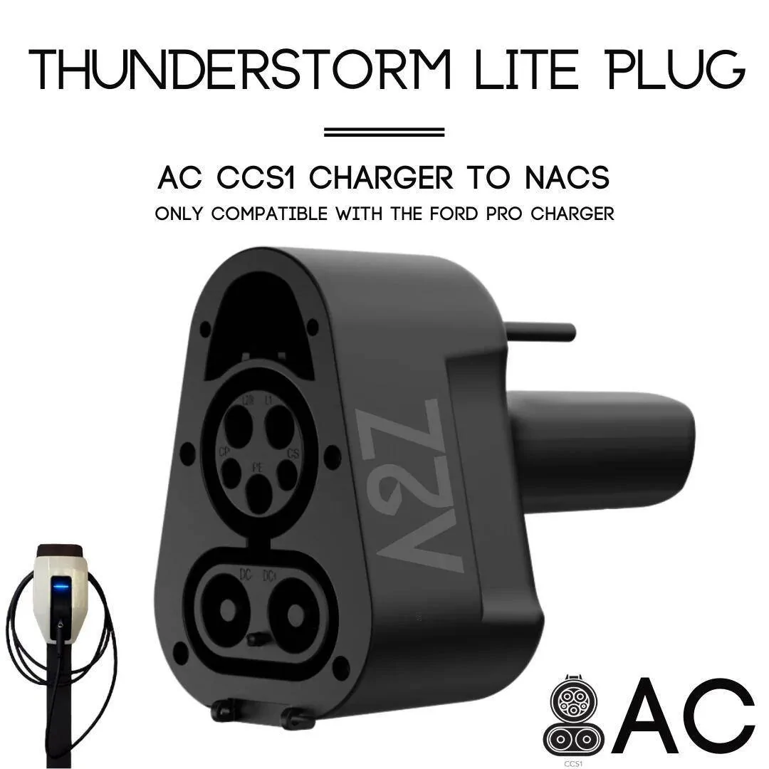

If you have the Ford Charge Station Pro, that's not going to work. You need a CCS to NACS adapter, such as this - https://a2zevshop.com/products/thunderstorm-lite?_pos=1&_sid=be0393063&_ss=r&ref=Typhoon

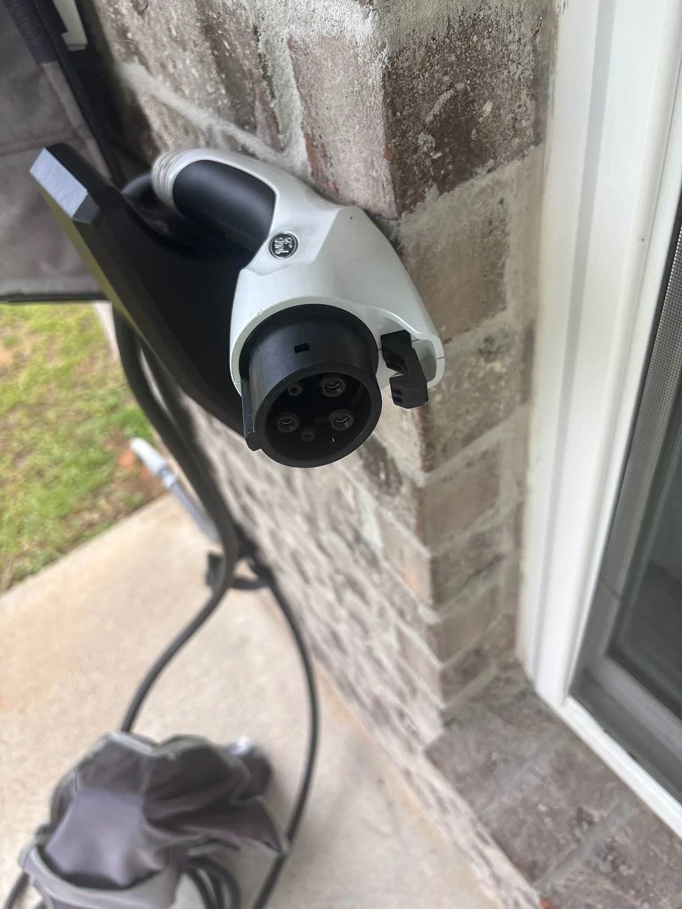

Let me take a look what I got so is that gonna work? i’m guessing what I ordered worked.

You're good! A J1772 to NACS works just fine on your charger.
If you had the Charge Station Pro, it has a CCS connector on it like you would have a DC fast charger. And then the J1772 to NACS adapter wouldn't fit on it because of the lower DC charge pins, which the Charge Station Pro uses for return power from the Ford Lightning to your house. In that case, you either have to modify your J1772 adapter a bit with a Dremel tool or buy an adapter like @RickMachE pointed to.

With the Ford Charge Station Pro you will need a Thunderstorm Lite plug to go from CCS1 to NACS for AC Level 2 if you need to charge a NACS vehicle.
A2Z EV has a adapter for owners with a Ford Charge Station Pro and a Tesla.

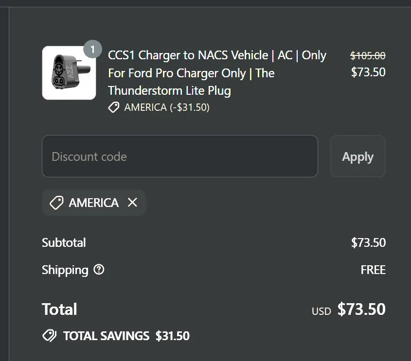

You can click the below link and then use the code "AMERICA" to save 30% off instead of 5% off which is good till July 6th 11:59 PM PST.
CCS1 Charger to NACS Vehicle | AC | Only For Ford Pro Charger Only | The Thunderstorm Lite Plug - Click here and use discount code "AMERICA"
