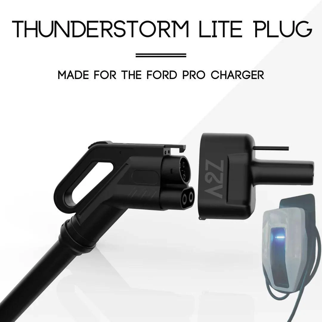

A2Z EV has an adapter for owners with a Ford Charge Station Pro and a Tesla.

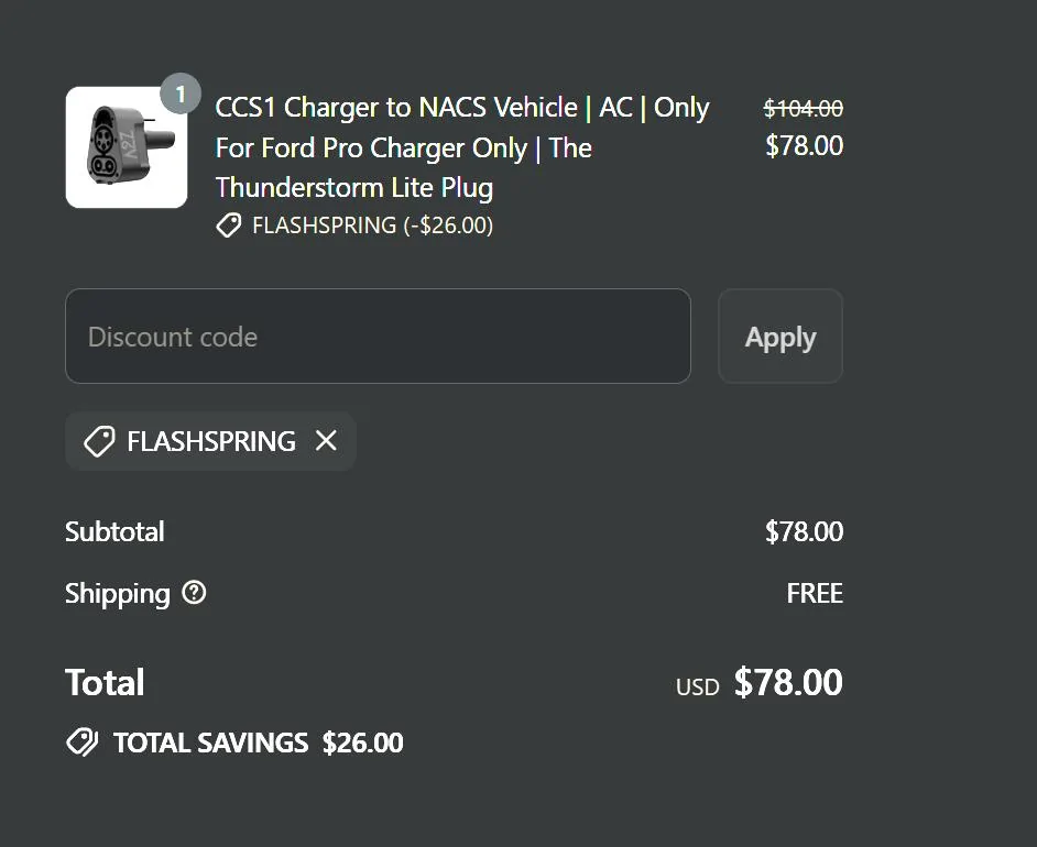

You can click the below link and then use the code "FLASHSPRING" to save 25% off instead of 5% off.
CCS1 Charger to NACS Vehicle | AC | Only For Ford Pro Charger Only | The Thunderstorm Lite Plug - Click here and use discount code "FLASHSPRING"
Description
Important notice : This adapter is specifically compatible with the Ford Pro and GM PowerShift Charger and will only serve with the AC function.
Key Features :
  • Power : AC/Level 1/2 charging
  • Safety and Security: Our adapter locks the CCS latch once fully connected, ensuring no unplanned disconnections or thefts. Includes an interlock safety pin preventing accidental removal of the charging connector while charging. Unplug it with authorization from your car, phone, or charging station's control panel.
  • Protection : IP54 (mating) & IP67 (enclosing). Includes a hard case.
Requirements :
  • For the North American market.
  • AC Ford Pro & GM PowerShift Charger only
  • Tesla model S, 3, X & Y and NACS port equipped vehicles.
Built for Safety: For added safety, the A2Z Thunderstorm Max Plug incorporates two temperature sensor switches. The first sensor derates the charging process upon reaching a certain temperature, while the second sensor halts charging, the temperature are strategically placed within the adapter. Charging can resume once the temperature normalizes and the adapter is reconnected.
Easy to Use: Plug the A2Z Thunderstorm Max Plug into the charging station, then into your vehicle. To unplug, simply authorize from your vehicle or phone

Thanks for this advice. This adapter will probably work with my future cars. I'll have to store this link somewhere where I can find it in three years.
However, it still doesn't allow me to charge the plug in hybrids that I have that only have J1772 receptacles. I guess I could stack adapters and also get one of these: https://a2zevshop.com/products/a2z-stellar-plug, or something similar.
Who knows, maybe the folks at a2z or a competitor will see an opportunity, and design a new adapter. A bit of plastic, and 5 straight through pins doesn't sound too difficult to make.
Honestly, I think a J1772 extension like this one: https://a2zevshop.com/products/j1772-extension-cord-48a-16ft-5m would to the trick. I may get one and try it. That would have the added bonus of allowing the cable to reach out of the garage where the plug-in hybrid lives.
