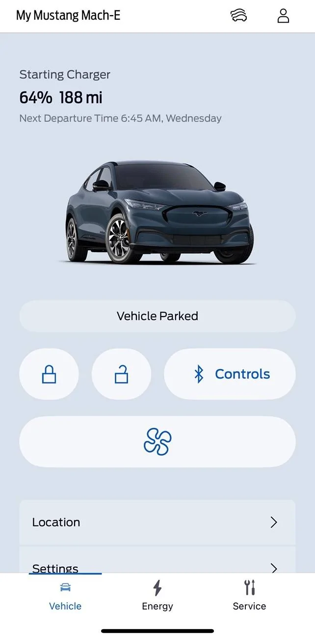

So I noticed something weird on my wife’s car today. Came home today and started hearing clicking noises coming from the Ford mobile charger with with blue and an amber dot light so I checked the app. The app is showing the car looping through “starting charging”, “charging by” and “waiting to charging”. I’ve never seen this before, is the charger on its way out? Car just updated a few nights ago.

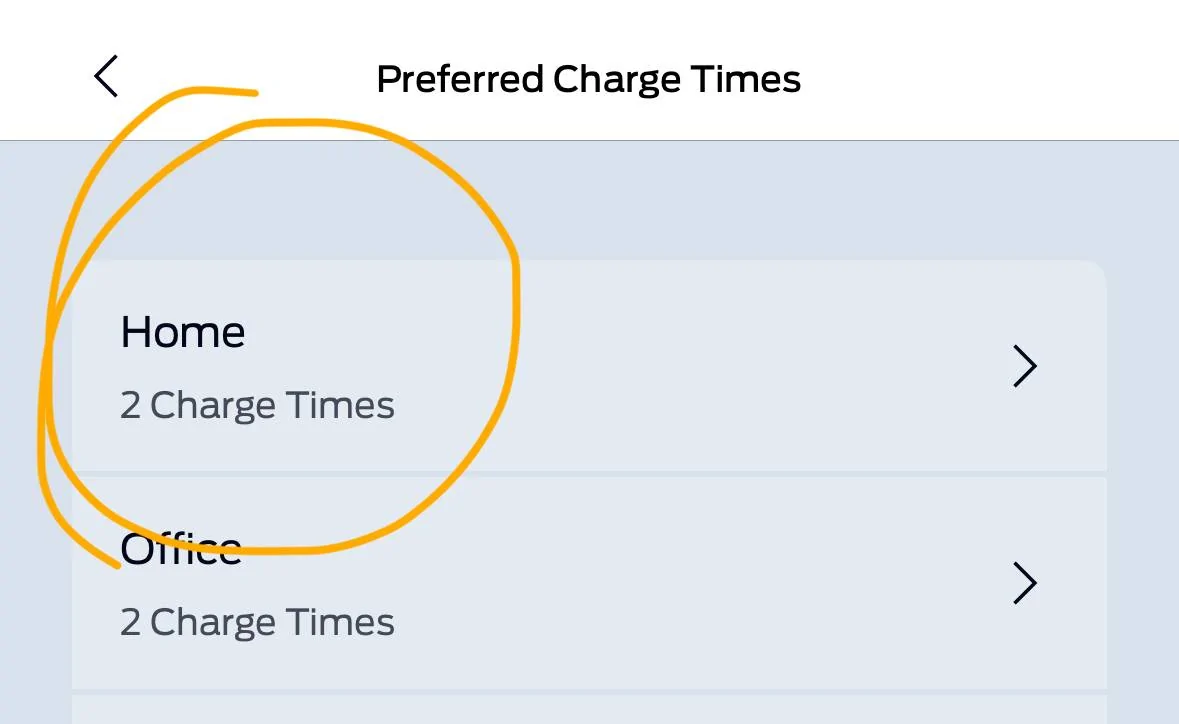

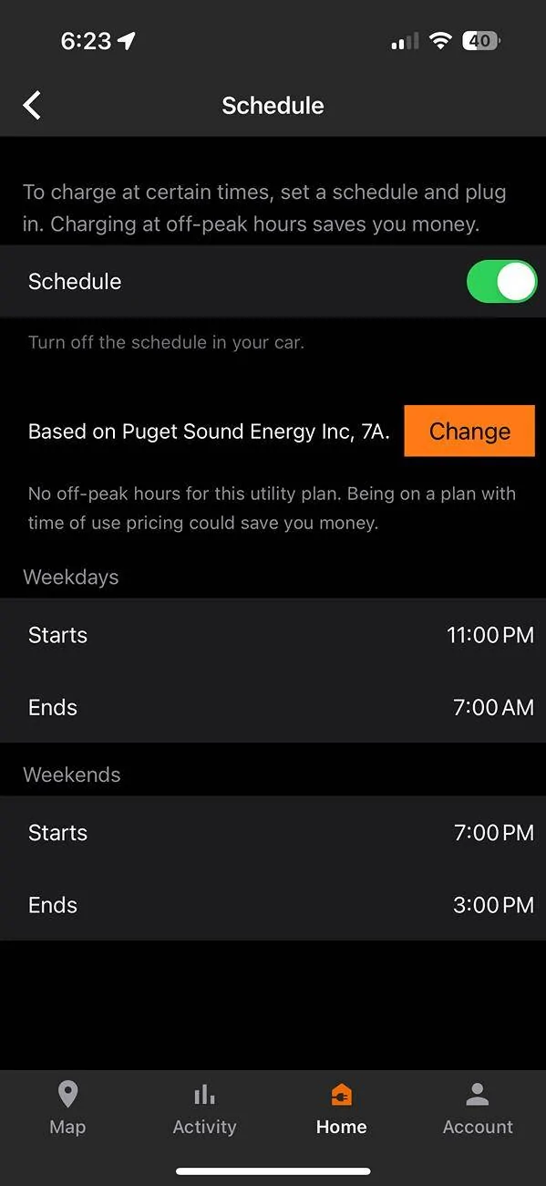

from my experience it happens to me with my ChargePoint home charger. I had to disable the fordPass charge schedule and keep only ChargePoint Schedule that syncs with my electricity provider.
conflicting schedules must be an issue.

Interesting- I do just the opposite; set the schedule in the Ford app and have the ChargePoint schedule disabled.

I’ve had it happen before, I just turned off my schedule charge and let it charge up. Then turned my schedule back on and it hasn’t happened again.
Removed the charging schedules and added them again and all is good. I swear every update does something bad.
