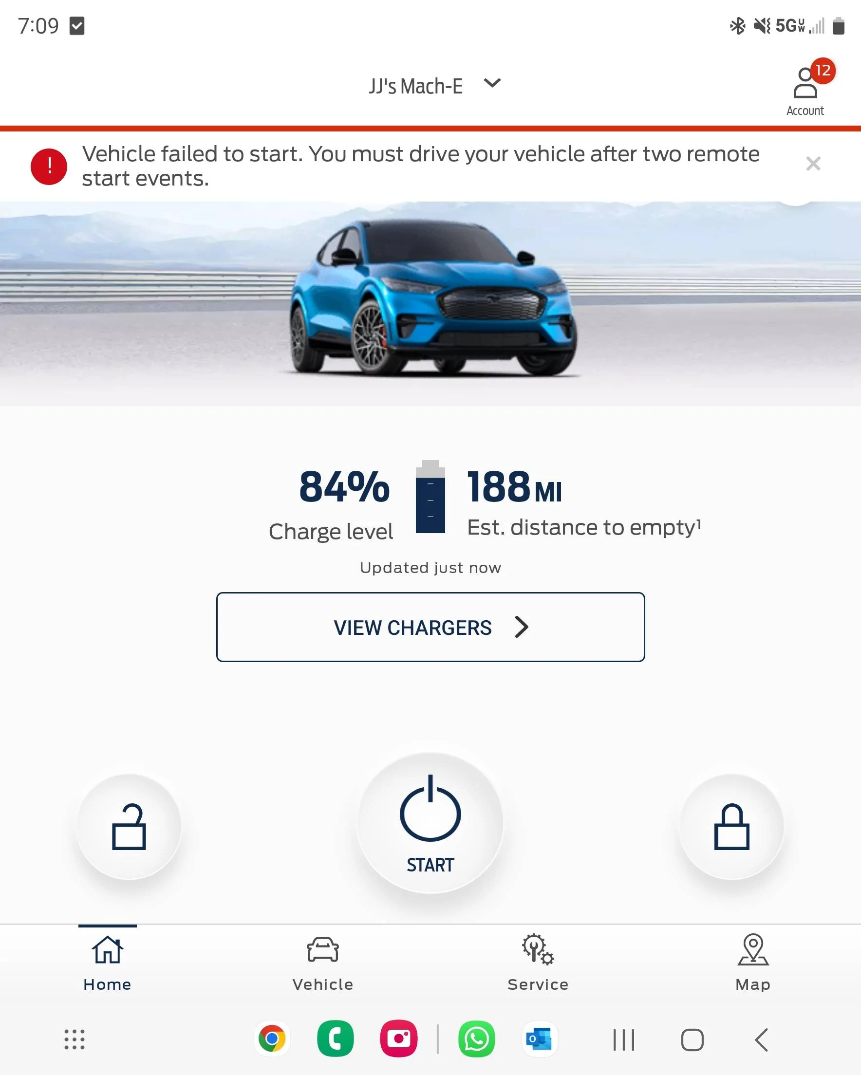

Ok, getting this almost every time I leave town and park my car at the airport. When I come back and try to remote start. Here's what I get.

It means exactly what it says. See post #5.

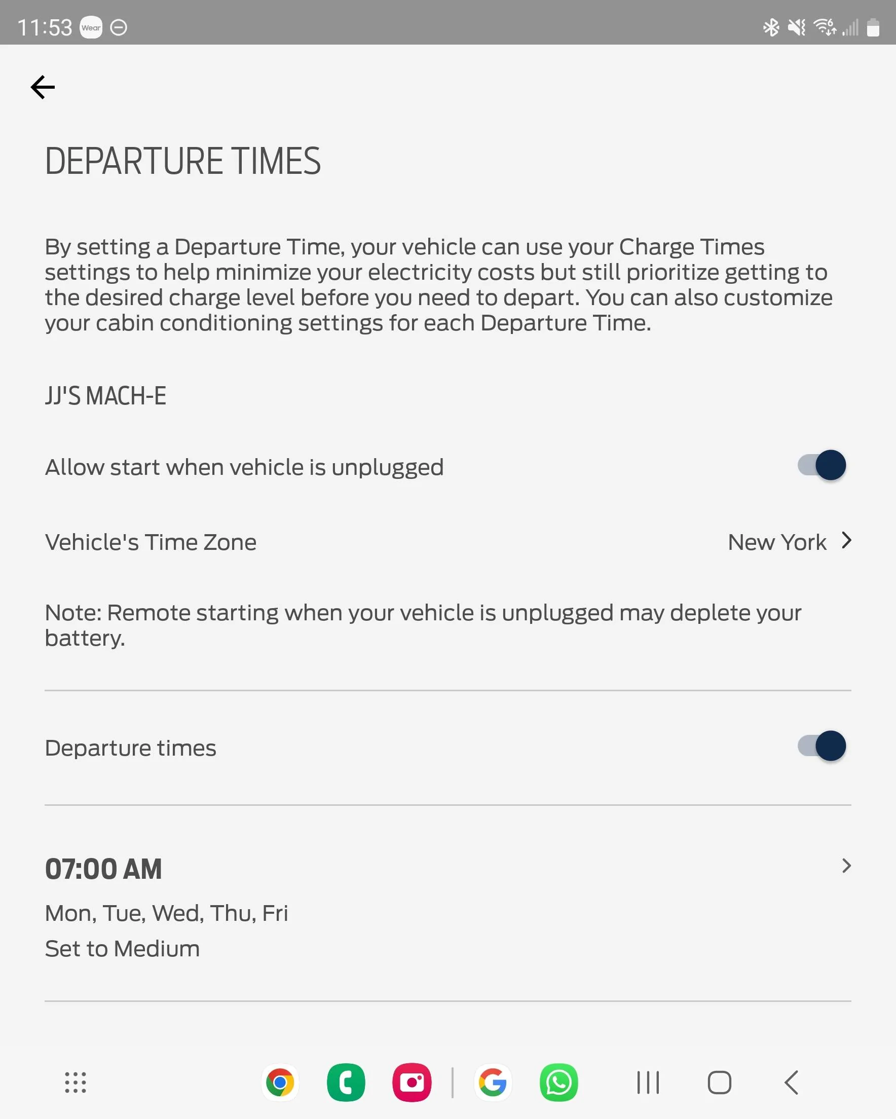

Wow, your reply was so helpful. Nevermind, I figured it out. They've added an "allow start when vehicle is unplugged" switch under departure time. It must have been starting every morning at my set departure time.

You didn't mention that you weren't doing it multiple times yourself. Glad you figured it out.
