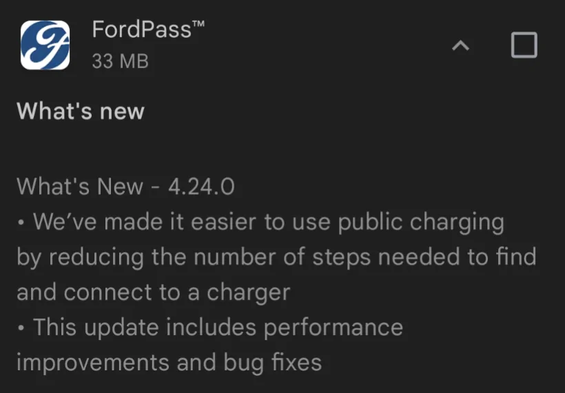

FordPass 4.24.0
Old_Norm
Jan 14, 2023
58
869
1,069
Columbus Ohio
2023 MME Select EAWD, 2023 Maverick Lariat LUX
That screenshot is from Google Playstore - but it might be a staged rollout... (?)
Probably correct. Just cheeked again and no new version. I'm in the US FYI.

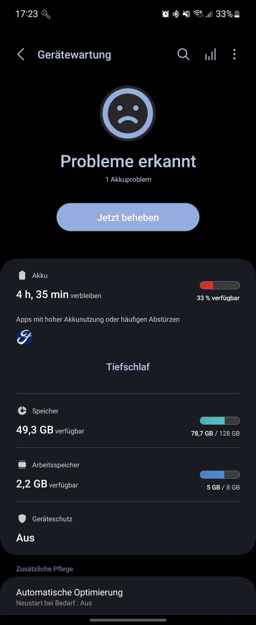

Fordpass 4.24.0 on Android 13 removed my European account login and completely broke Paak, it happened automatically while I was 100km away from home!!!
The backup start passcode never works in my vehicle and the dealer cannot even fix it....
Fortunately I read on the forum that keeping a fob in faraday case hidden in the car can be a life saver ,, which luckily I had used, if not it would have been a real struggle this far .......
Had to manually roll back to apk 4.23.1 and remove Paak from vehicle and phone then setting up again for it to work.
Now the new update 4.24.1 arrived and it keeps force closing occasionally but very frequent, almost on every startup and connection to vehicle..... Very disappointed and frustrating given the price of the car.
Now I'll have to roll back to 4.23.1 again till it's all fixed....
My advice, remove automatic updates in the playstore from fordpass and only do manual updates.

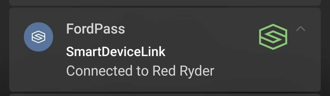

In this version, there's a new always-on notification when connected to the car:
Ford Mustang Mach-E FordPass 4.24.0 1675951961938
SmartDeviceLink is Sync AppLink but opened to other manufacturers as well, e.g. Toyota. If you tap the notification, it takes you to the web site: SmartDeviceLink
I don't recall seeing this notification on earlier versions, although AppLink SmartDeviceLink was there.
If you look at the right time you can see a connection countdown when the phone first connects to Sync through Bluetooth.

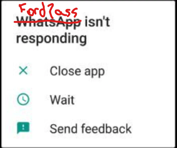

What's the report dialog/box? I don't think I've seen that one in my car.
It's an Android system level dialog box something like this (random search image from the internet)
Ford Mustang Mach-E FordPass 4.24.0 1675957335127
It pops up over everything e.g., if you're in the car and connected and you pull up a web browser or other app it will keep popping up every 5-10 seconds.
Not sure if it is being silently muted for me now but I didn't see it yesterday. Perhaps whatever was happening worked itself out?
Edit: just kidding, still popping up occasionally.
