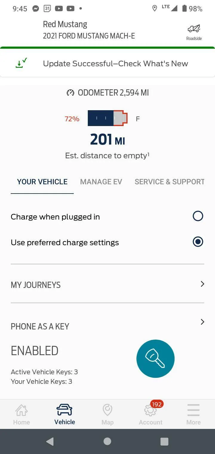

Car is unplugged, why is the battery now red? Does it mean something?
Ford Mustang Mach-E FordPass App Version 3.22.0 is out Screenshot_20210514-094542

I understand that the latest 3.22 FordPass COMBINED WITH the latest OTA update will fix 99.9% of the Phone-as-Key connectivity problems and put it on-par as reliable as Teslas (if not more reliable). Unfortunately, I'm still waiting for my OTA update...

Hesitant to say mine has been working fine the last few days, but it has. Far fewer issues approaching the car.
Where did you read that the latest OTA update contained improvements to PaaK? The SSM for PaaK says the RFA module needs to be updated at the dealer.
I think the SSM was put out to say it must be updated at the dealer because the OTA is taking so long to get out (like maybe months to get to everybody).
Why would you think that? The module updates that are currently available to be installed by the dealer have not yet been included in OTA updates.

That brings up an interesting question regarding OTA updates. Will all of the software that is currently being loaded at the dealers eventually be pushed to the modules that are capable of accepting OTA updates? ?
I would think that most of them will make their way into bundles that will be pushed out OTA eventually.

During the body work, they took Marlin to Koons Ford for their techs and the Field Service Engineer to work on a couple of issues (front USB ports, one door not opening with fob/PaaK). They updated all systems so Marlin is at OTA 2 plus all the other, newer updates that are available. My phone is on 3.22 as well. PaaK is working great. Sure, there are a few times I have to make sure the phone is active or press the button a couple of times. I have found no need to carry the fob in the last week.
