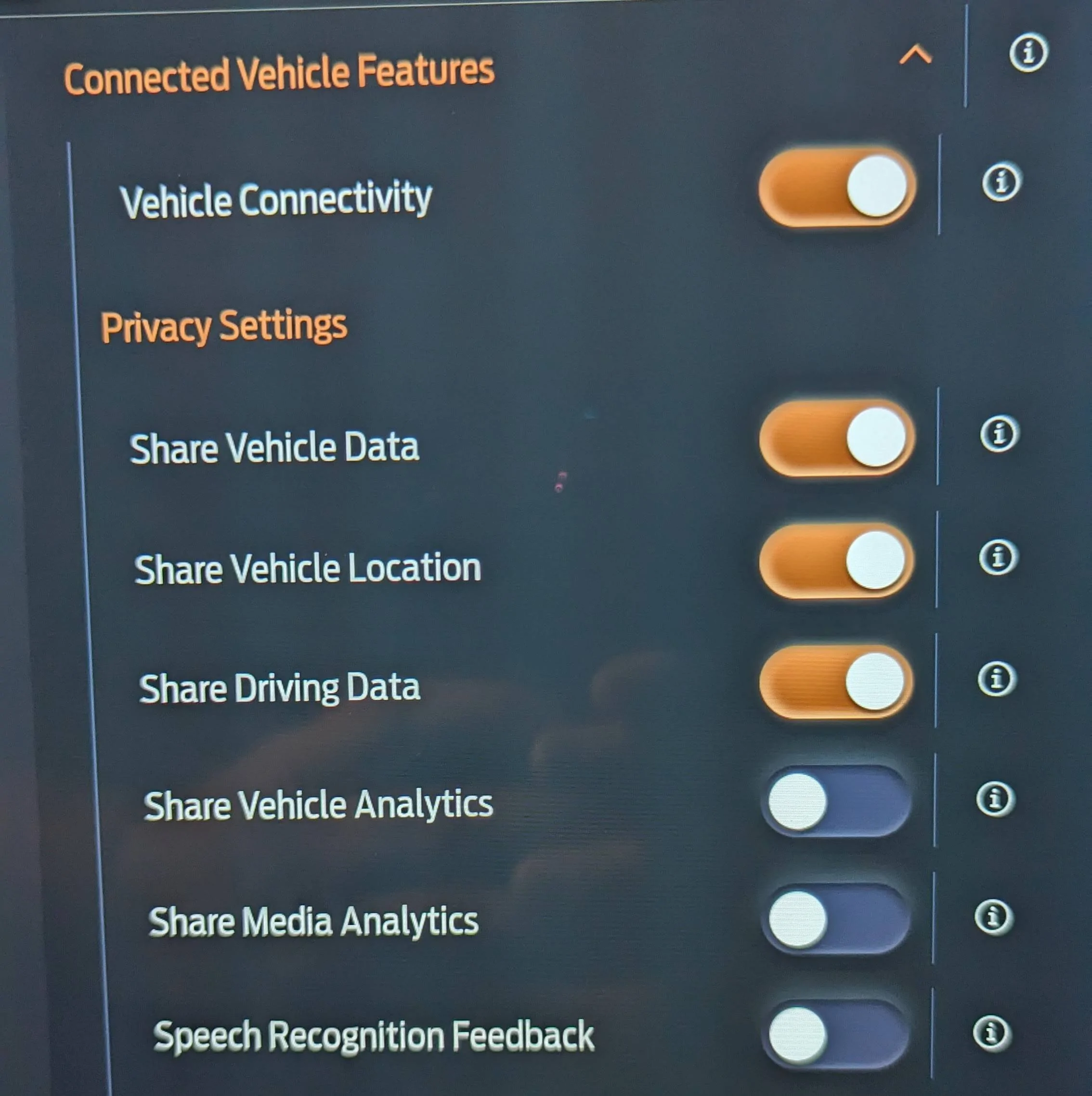

this happened to me last fall after an update and it was due to the "share driving data" setting in the "connected vehicle features" getting turned off. check and make sure at least the following settings are turned on.
When this happened to me, toggling Vehicle Connectivity worked. Just make note of the Privacy Settings and re-enable those as well.

I cleaned the cache early on - no change. All those controls on the big screen are set (and a few more)

Well, it's back. I did two things, so I cannot be sure which fixed it (and it's possible it just "came back" and me dorking around was coincidental)
1) I deleted my charge profile for home
2) I turned the connected vehicle stuff off entirely (master switch)
I THINK (with no emperical proof) it was toggling the connected vehicle thing. I turned it off, power cycled the car and then turned it back on.
Partly I think this may be connected to a 6+ week problem with connected vehicle stuff when I was running the 6.1 powerup (which seemed to have completely broken that for a while). So it may be a side effect of that problem which I didn't notice until my next long trip.
Either way, if I were doing this again, I'd do the connected vehicle/power-cycle toggle first and see if that helped (I did have to completely exit the app and force a refresh afterwards)
