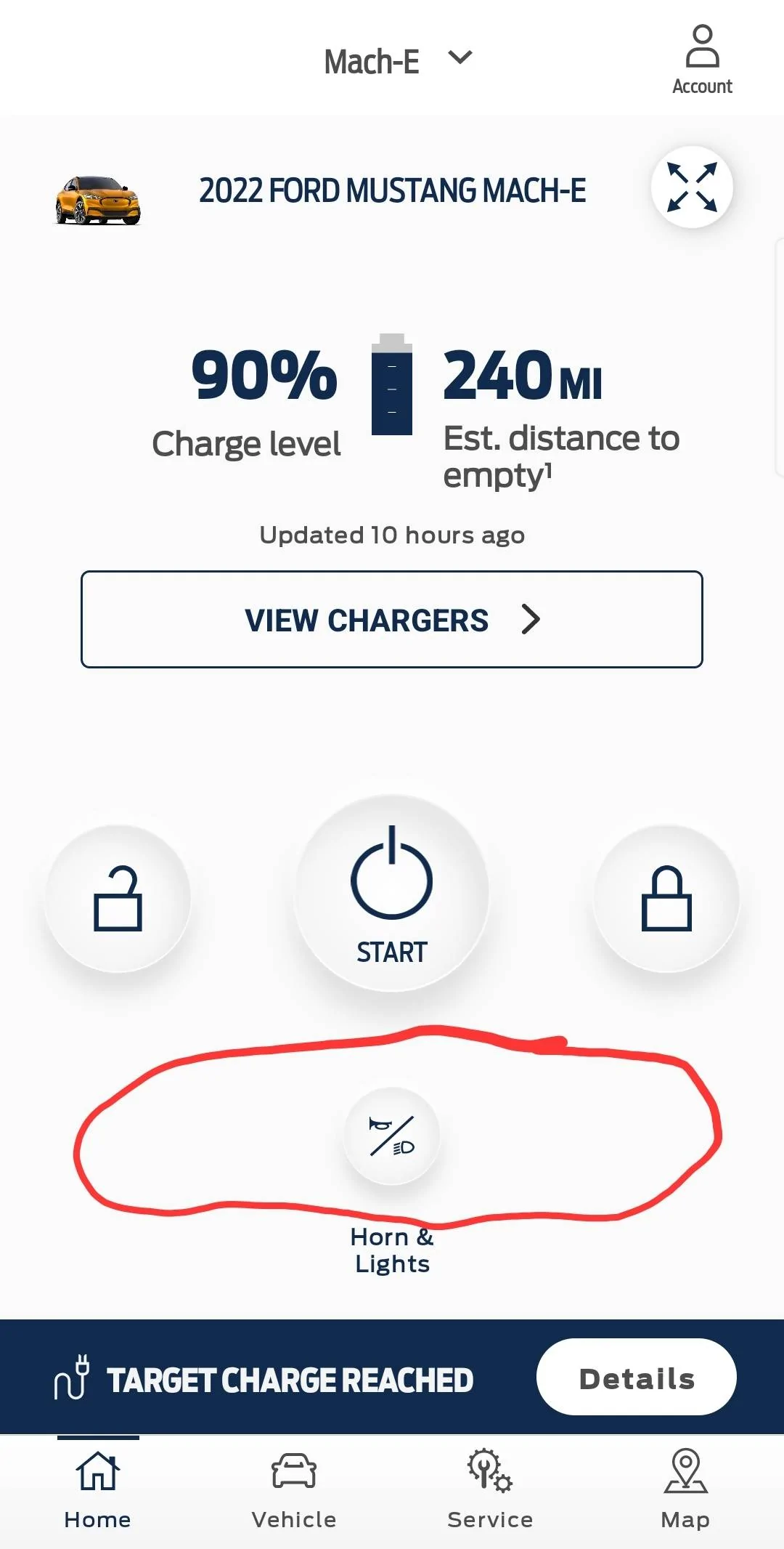

Anyone else suddenly missing all the other options (including frunk release) that used to be here?

Try quitting the app and rebooting your phone. It thinks PAAK isn't set up.
Thanks @Mach-Lee but I have tried a full reinstall. I did get a new phone but it shows up in my PaaK list. I might just have to go through the process a few times until it takes.

Good lord ?. You forgot "kneel facing east at sunset and hold up a live chicken as an offering". Fortunately, removing my phone from the PaaK list and adding it back did the trick.

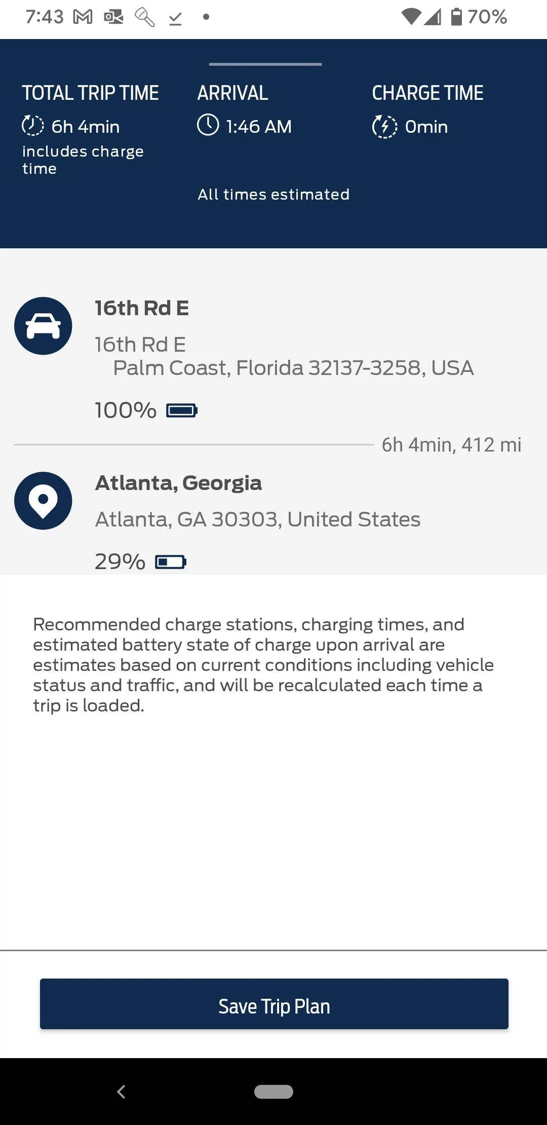

Doubt this has anything to do with server outage, but FordPass has been...optimistic about my range projections recently. Kind of strange, because the trip planner has been surprisingly useful from time to time, in being able to send locations to the car etc.
