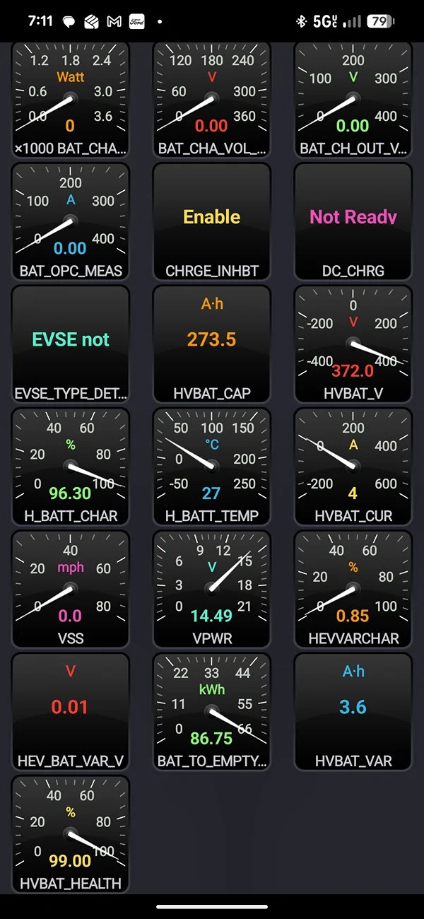

I have a 2025 Mach E Premium ER RWD. I use the OBDLINK MX+ Bluetooth adapter.
My phone is Android.
My Forscan Lite version is 1.5.29
I see version 30 is out there. I'll try to update it tonight.
I'm attaching a screenshot showing data I captured after a rare charge to 100%.
I believe the HVBAT_HEALTH value at the bottom is the SOH.
