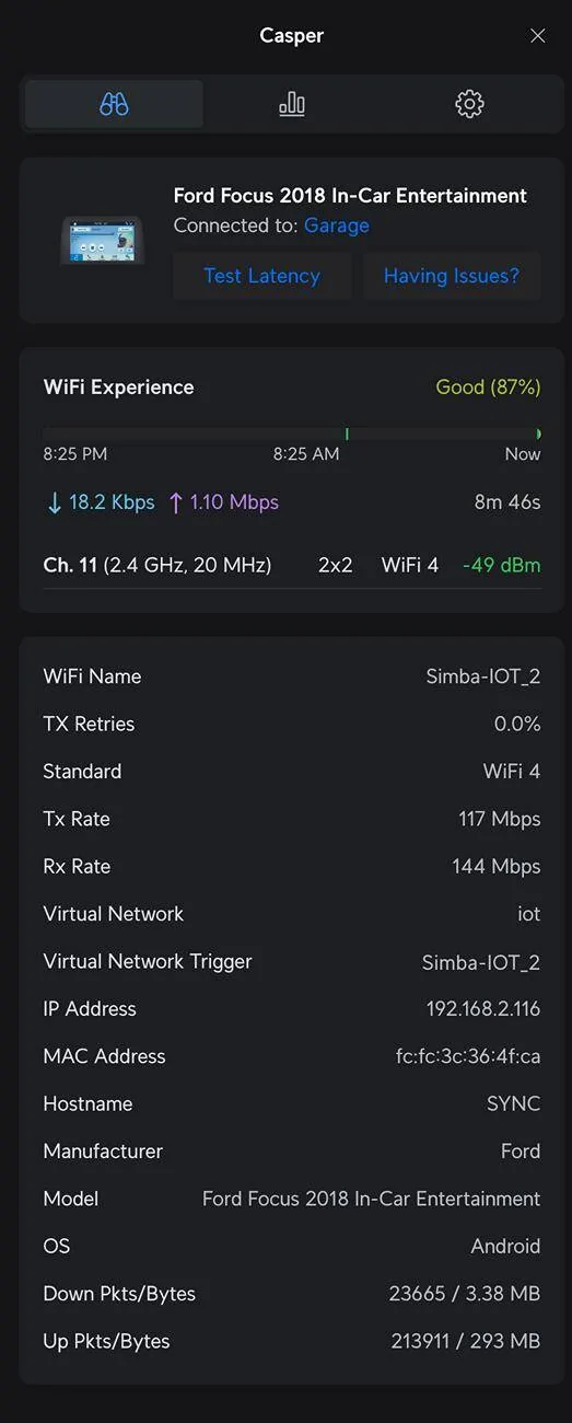

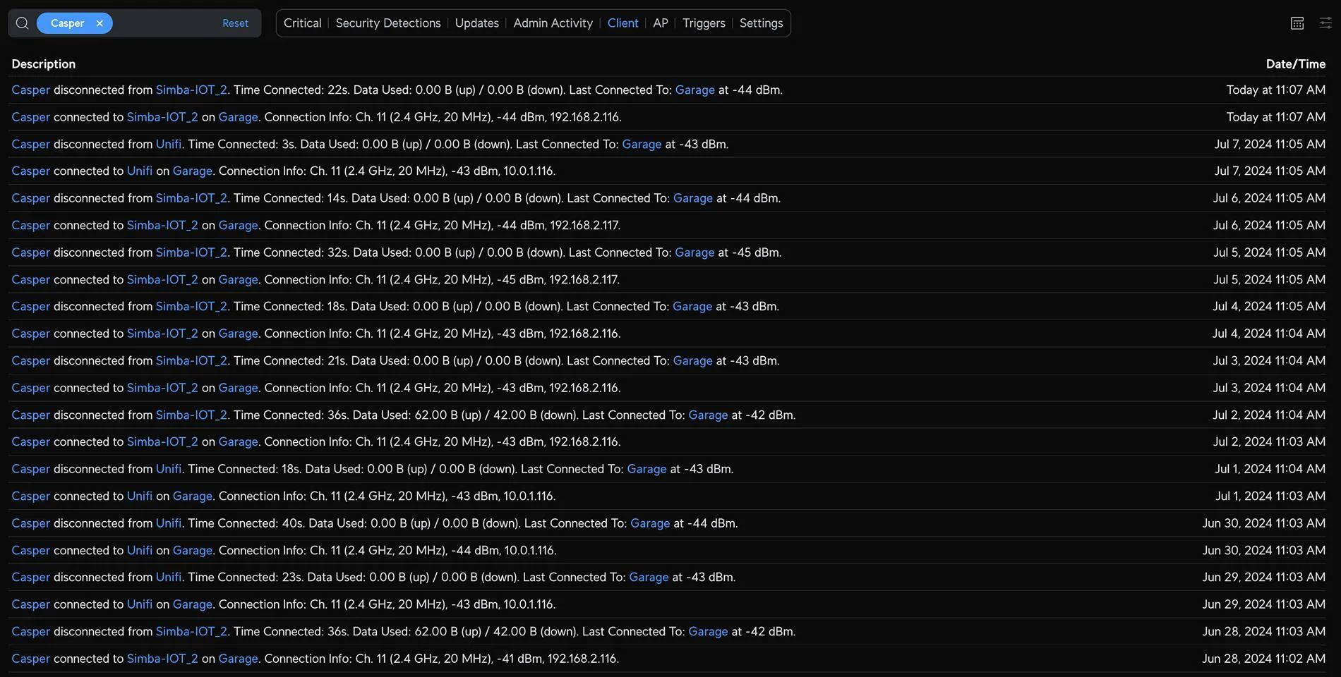

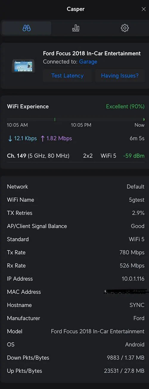

I'm not sure you're seeing download, rather, upload.
Ford Mustang Mach-E 5 Ghz Wifi Capable? Screenshot 2024-07-11 at 8.20.49 PM
So the really interesting thing about my logs are I removed both those SSID's from the cars wifi back in March or so. And wifi is off in the car.
Ford Mustang Mach-E 5 Ghz Wifi Capable? IMG_6741

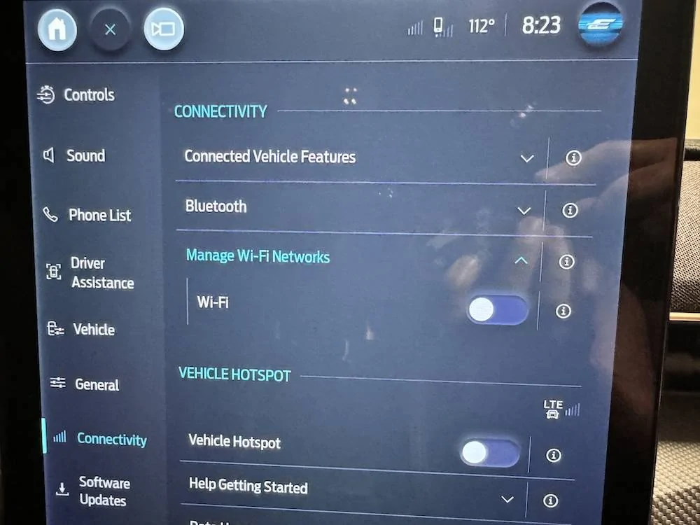

So I'll turn it back on now and watch what happens (and wouldn't you know, I walk in the house after turning wifi back on in the car and my phone stays connected to car play in the MME even though the car is off in the garage)
Ford Mustang Mach-E 5 Ghz Wifi Capable? IMG_6742

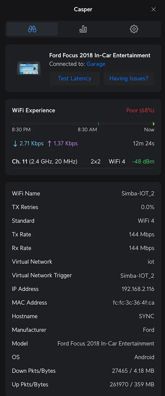

Meanwhile, back at the ranch.
Ford Mustang Mach-E 5 Ghz Wifi Capable? Screenshot 2024-07-11 at 8.32.32 PM

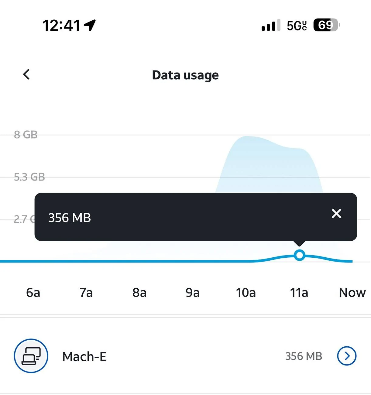

Well, that's odd my car is shoveling data out to somewhere. Not downloading to shipping. I'm also probably bet I 'get' an update though most likely this is pre-install logs or config data, driving data or something but I doubt it's uploading OTA's.
And it stopped at 359MB, looks like what you saw.

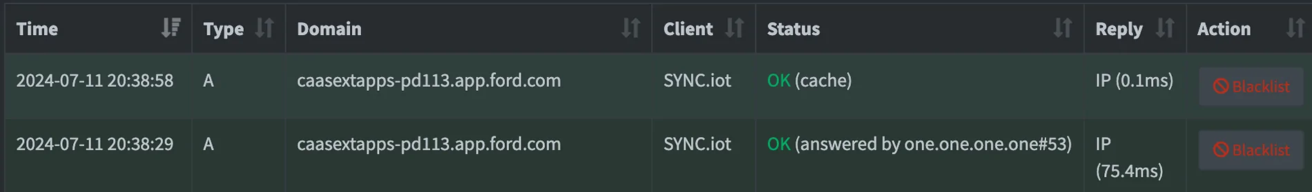

All DNS goes to:

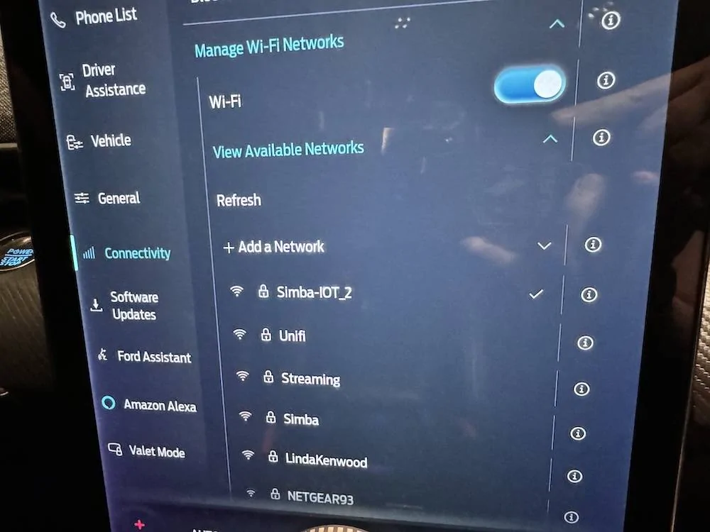

To circle way back around on this, yes it's 5ghz capable, though it doesn't seem to like it it connects just a hair faster than 2.4's gtz max. But remember if your AP is going through a wall or several 2.4 goes through better. I have a AP just in front of the hood in the garage on the ceiling and this is my best. (I'm thinking the antenna is in the sharkfin so it's ~10 ft from the AP.
Ford Mustang Mach-E 5 Ghz Wifi Capable? Screenshot 2024-07-20 at 10.09.57 AM
