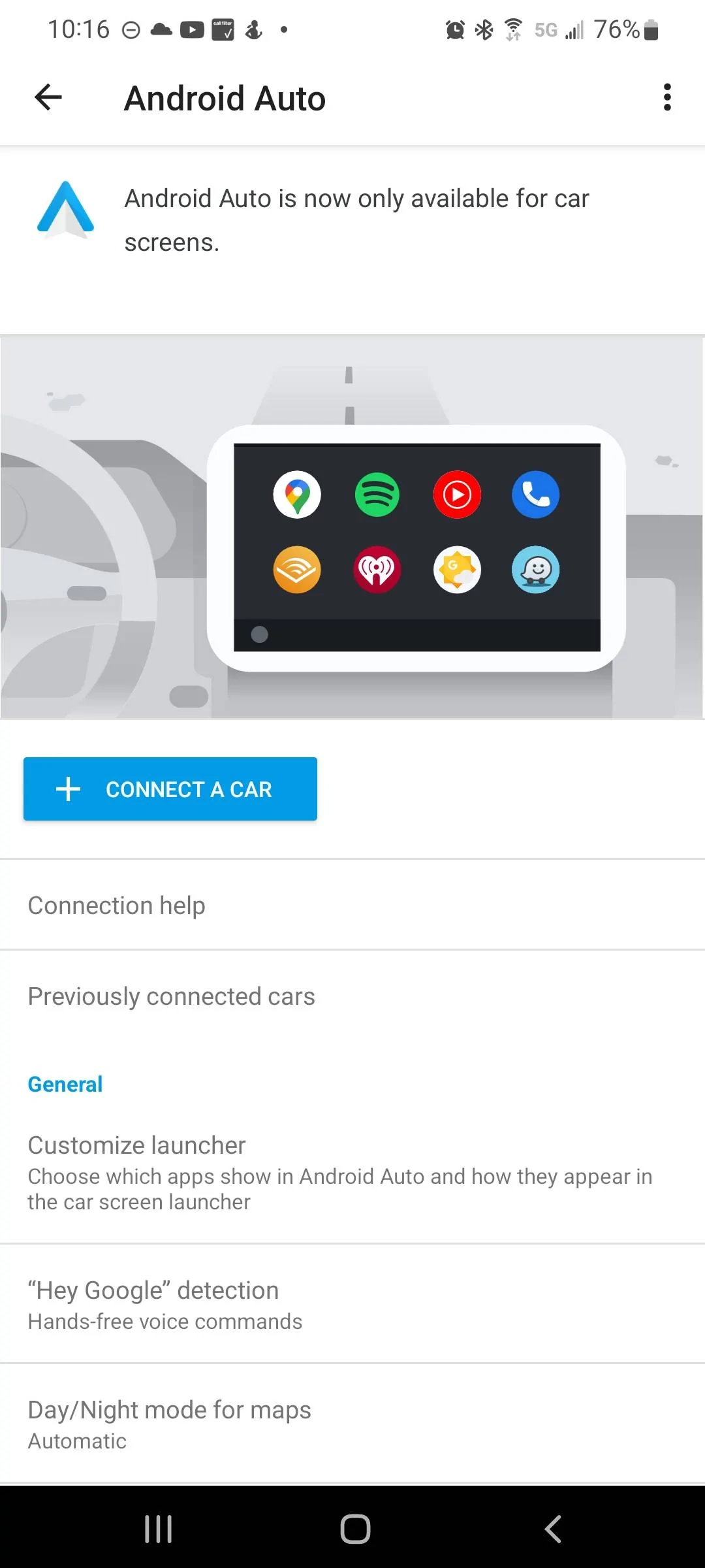

that does not sound like fun. what phone is this with? one of the main problems with Android Auto is the fragmentation of Android versions and phone models from different manfuacturers guarantees incompatibility.
I'm using a Galaxy S21+, all updates installed. Its odd because if I'm in the car and connected my home button works just fine but as soon as I get out and turn off the car my phone home button turns into that AA message unless I go into apps and disable AA or reboot the phone.
This is a good stumper. Are you running Android 12 on your Samsung S21+?
Do you still see an Android Auto separate app that you can run?
Running Android 12 on my S21 Ultra (Sorry I said plus earlier, that was my last phone). I don't see a separate AA app that I can run. I do see it listed in my apps but all I can do is uninstall updates. I just tried removing the phone from the car, uninstalled the AA updates, then went back to the car and reconnected it. When I fired up the AA on the car it talked to the phone which immediately wanted to update the app. I walked through the setup and everything looks great. Phone responded nomally while sitting in the car. As soon as I turned the car off though my phone home button brings up a full page message:

I have to hit the back button on my phone several times to close it out and get back to my actual home screen. Can't find any solid info online about it so I guess I'm special.
That sucks! Definitely a bug. Somehow, the loss of connection to your car is leaving the phone thinking you're trying to launch the Android Auto for phone screens (which Google has killed in favor of a new Google Maps Driving Mode). If you run the phone app these days, you will get this message, and somehow it's being shown to you when it definitely should not be.
I've not had this problem with the Pixel 6. The engineers at Google generally only carry around and test with those phones reguarly....
Do you have another car with Android Auto to see if it does the same thing there? Is it doing the same thing with wired connection, not just wireless AA?
I would post this in the Android Auto support forum, it looks like this is something they should fix.
After re-reading your repro steps, I think your phone is trying to go into car mode itself, which is super-messed up.
Go look here:
and
I think you should start by disabling in Google Maps > Settings > Navigation > Google Assistant settings ----- these two ones:
"When connected to car's Bluetooth" set to "Do nothing"
and
"When driving is detected" set to "Do nothing"
If that doesn't work, follow the steps in the links above to get Google Play Services to stop putting your phone in DND mode perhaps -- I would also scour your Settings for some Samsung-specific crap that is detecting and keeping your phone in car mode.
It's the car mode setting + AA that is causing AA to show that message with no way to escape.
Another alternative here if you are somewhat hacky / technical is to look into using Tasker to run a macro to force the phone out of what's called "car home" mode when you disconnect from your car.
Or you can do what I did and just use CarPlay. It doesn't force users to hack around like this to just have your phone work in a basic way.
