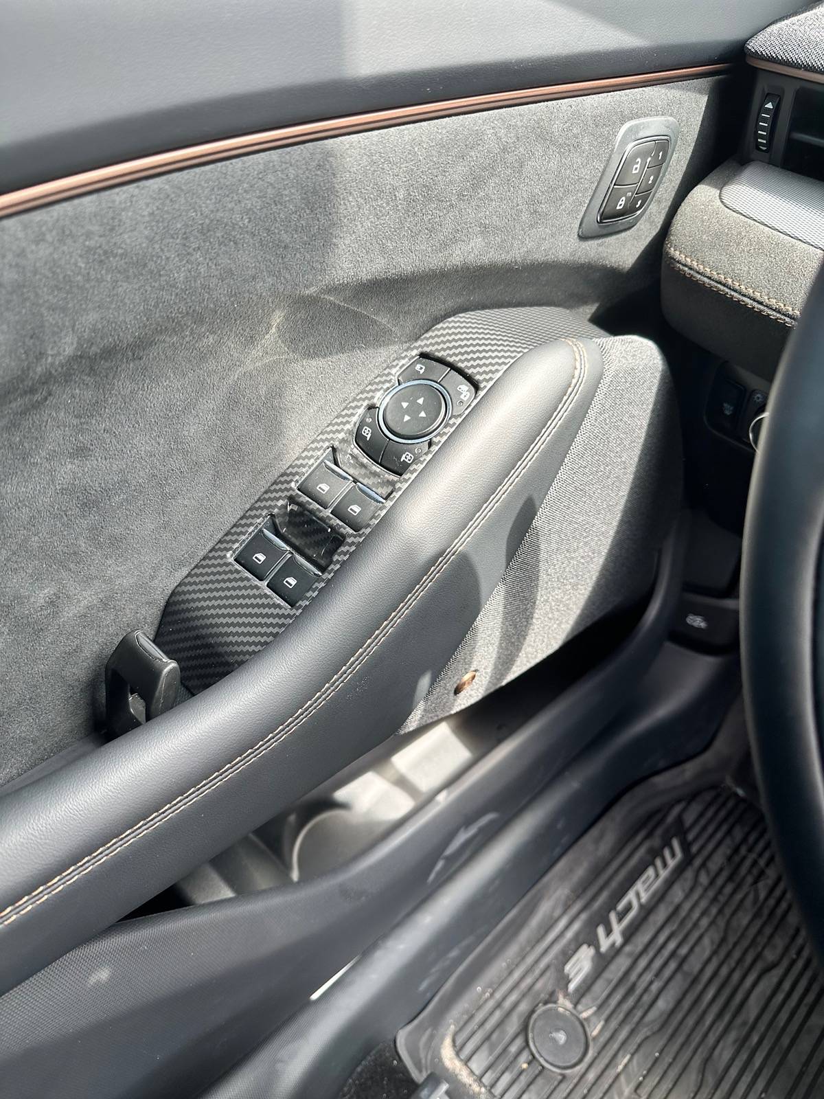

I’ve got the 23 GT, haven’t got any recent updates, but while I was driving through a parking lot today, the front windows went down by themselves and when I tried to put them up, they wouldn’t go up automatically one touch for about 10 seconds and then they went up one touch when I pulled up on the window button, never seen that before!

Not sure on why it went down, unless it went down when you were trying to one touch them up? The window detected resistance so it stops and retracts, thinking it hit something. You then have to raise it manually to show it’s fine and then one touch will work again, I’ve had this happen probably 5 times during my ownership.

Yeah, it’s sort of happened like that. I guess I was going through a drive-through and then I was just coming out. Maybe my elbow is on the window I don’t know. Thanks.

Probably nothing. Every time mine has done it, there has been no obstruction, but I guess this being overly sensitive is preferred!

I was thinking first, maybe it was because I didn’t have that carbon fiber overlay correctly there, but I haven’t had no issues other than that one time.

Put the window down, then spray the seals with silicone spray. Same with your door seals if you live in freezing areas.
