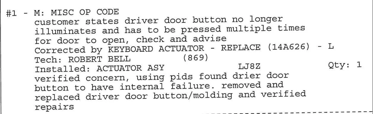

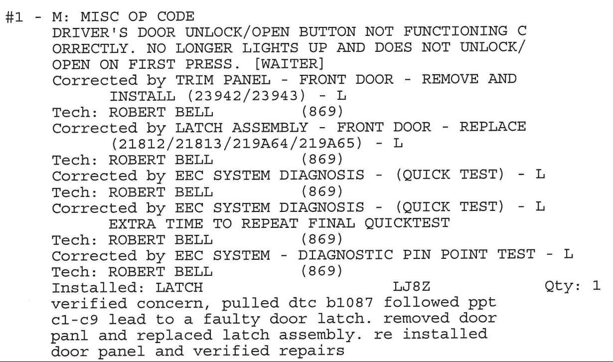

The work order doesn't list the exact part numbers but based on some googling I think it's these:
Latch: LJ8Z-58219A65-H
Actuator assembly: LJ8Z-14A626-AB
Pretty sure they tried the latch first and then had to replace the "actuator assembly" - which actually just appears to be the whole external trim piece with the keyless entry panel and such - but it looks like it has some sensor/module attached to it that was likely the problem. I think the original error they saw said it wasn't communicating with the latch, which is why they tried that first. But I'm wondering if that was just a symptom of the actuator assembly failure and they maybe didn't need to replace the latch. Who knows.
Here's the detail from the work orders if you can make more of it than me:
You had two parts replaced, the door latch inside the door, and the exterior door button/moulding.
