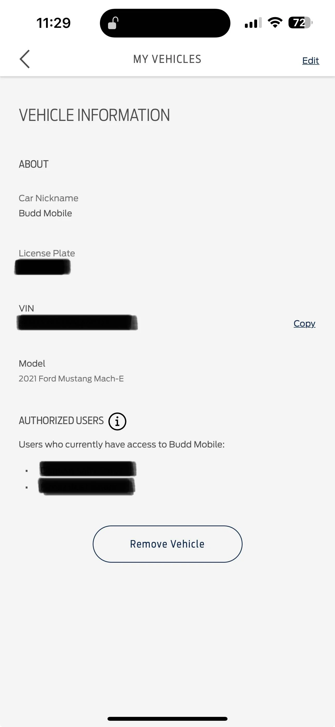

Lol! Ok the sticker is wrong. I am going to sue ford..?
Don't sue ford - they may take away your frunk button ?
Seriously, what is the build date of your vehicle. If it's earlier than June 2021, you have a unicorn and should keep your mouth shut (see above ?)
297
9,541
12,871
Did I put December 22, I meant December 21 LOL I got the car on feb 25, 2022
If your car was built in December 2021 then, you appear to have a very late MY21 Job 2 vehicle. MY21 Job 2 vehicles do have a frunk release in FordPass.
