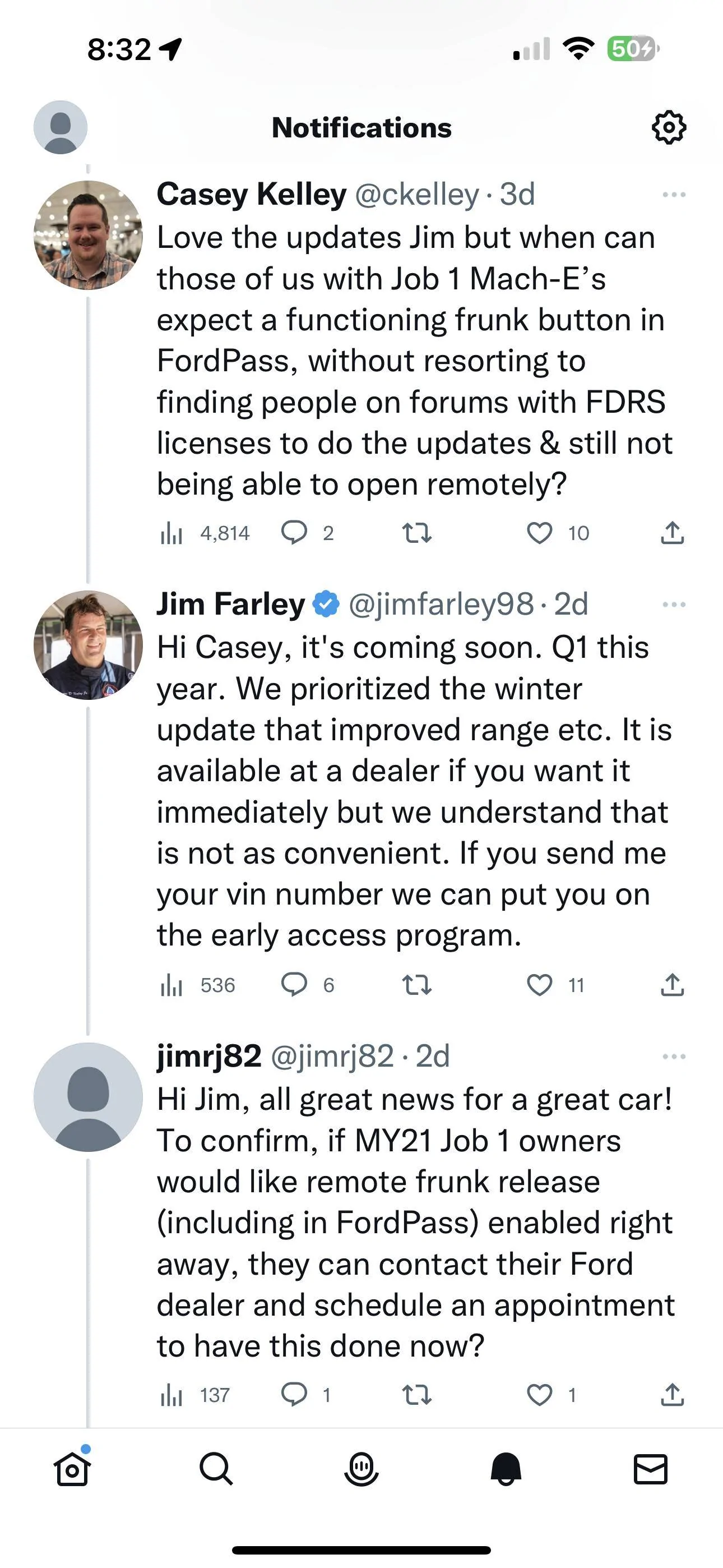

Speculation? Or fact? Remember Fatley’s “late Friday night tweet” that was deleted.
Note that, of course he didn’t respond to my question. ?‍♂
Ford Mustang Mach-E FRUNK IMG_0514
11,490
23,285
It would’ve been released by now if they were going to do it at all. They’re more concerned about their $800 per year BlueCruise 1.2 than they are with a few cars from 2 years ago. The job 1 Frunk OTA was worked on and apparently ready, or close to ready, to be released. Ford actively chose not to release it. I’ll be very surprised if an update becomes available through a CSP.

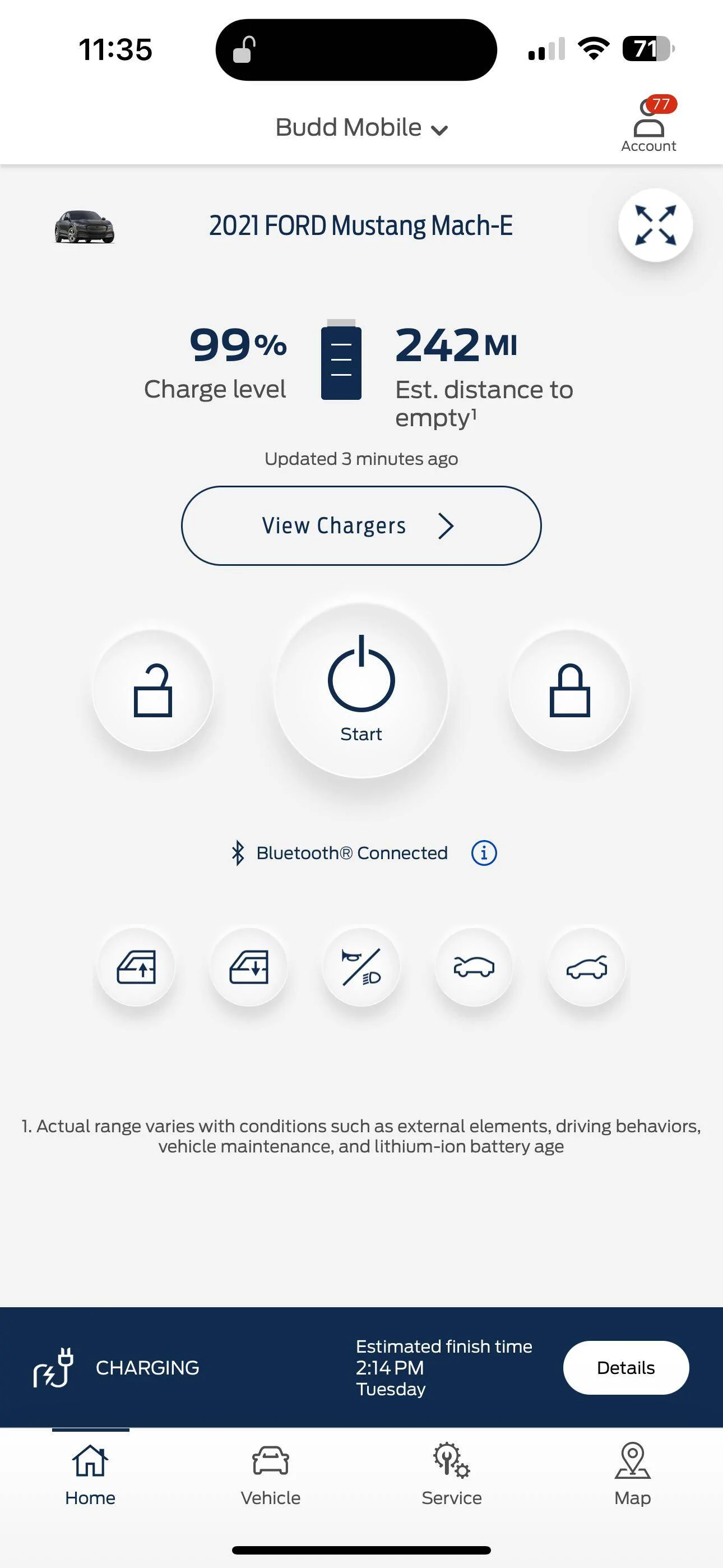

Just got 3rd remote from eBay, programmed it and now works!
Notice the 3rd key fob back looks different ??
I bought the key too. Programmed it and no luck. Job 1 is super screwed smh
