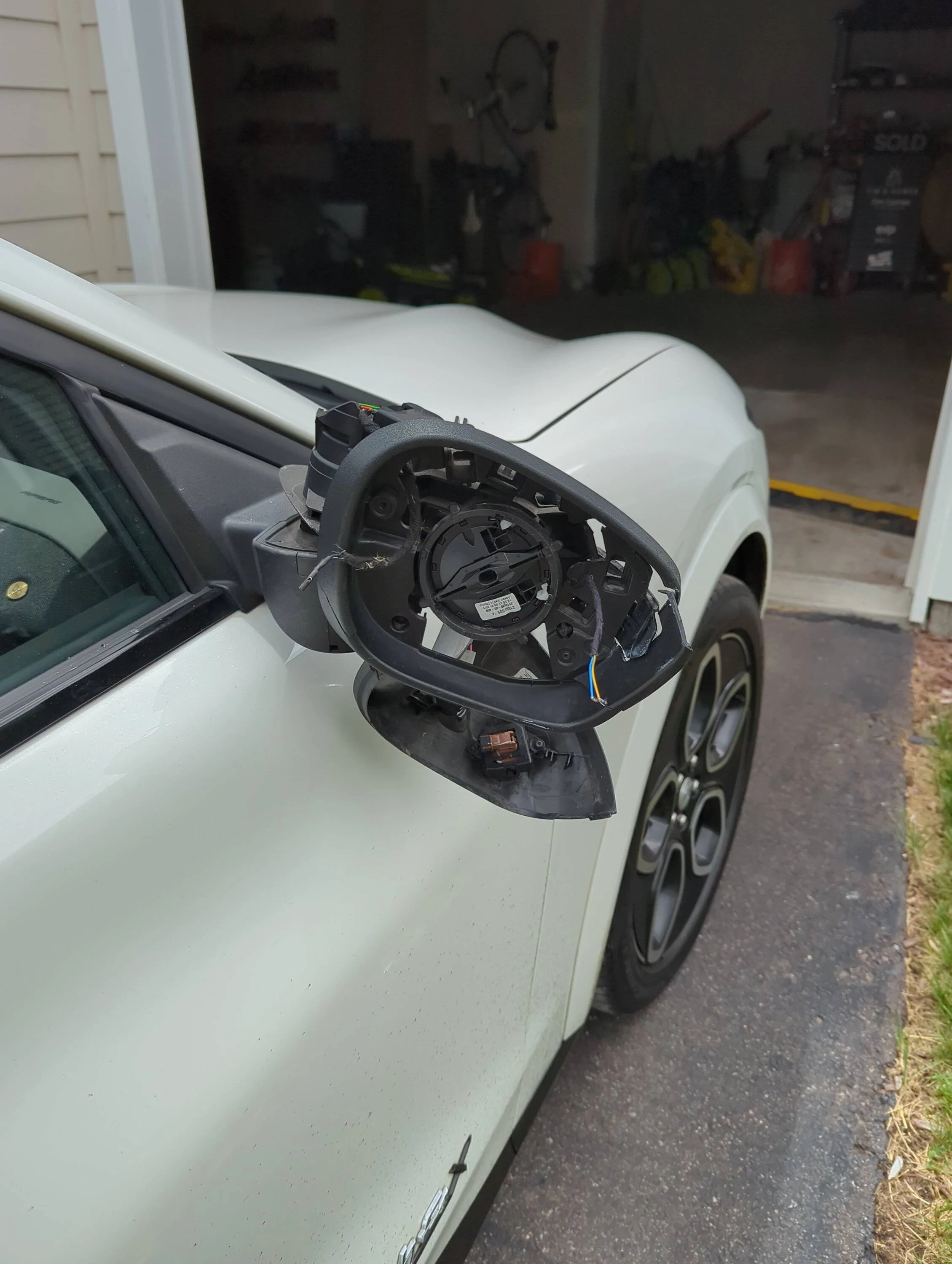

New mirror is on and honestly fairly simple to install. Took forever on my golf.
I did learn that full kit doesn't include the top cover. That is only available in an unprimed black. So I'll find an auto body shop to get it painted up or toss one of those covers on it

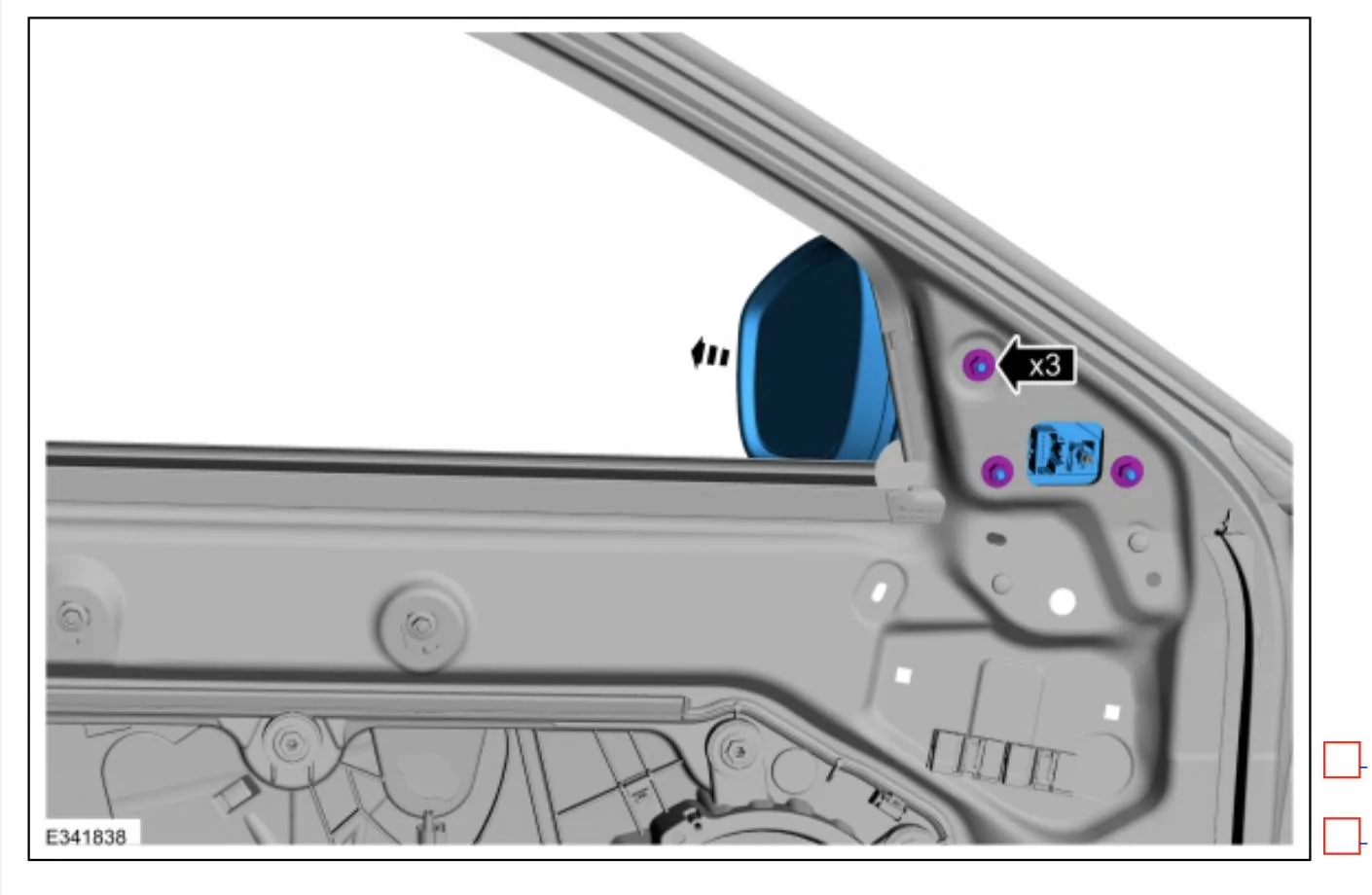

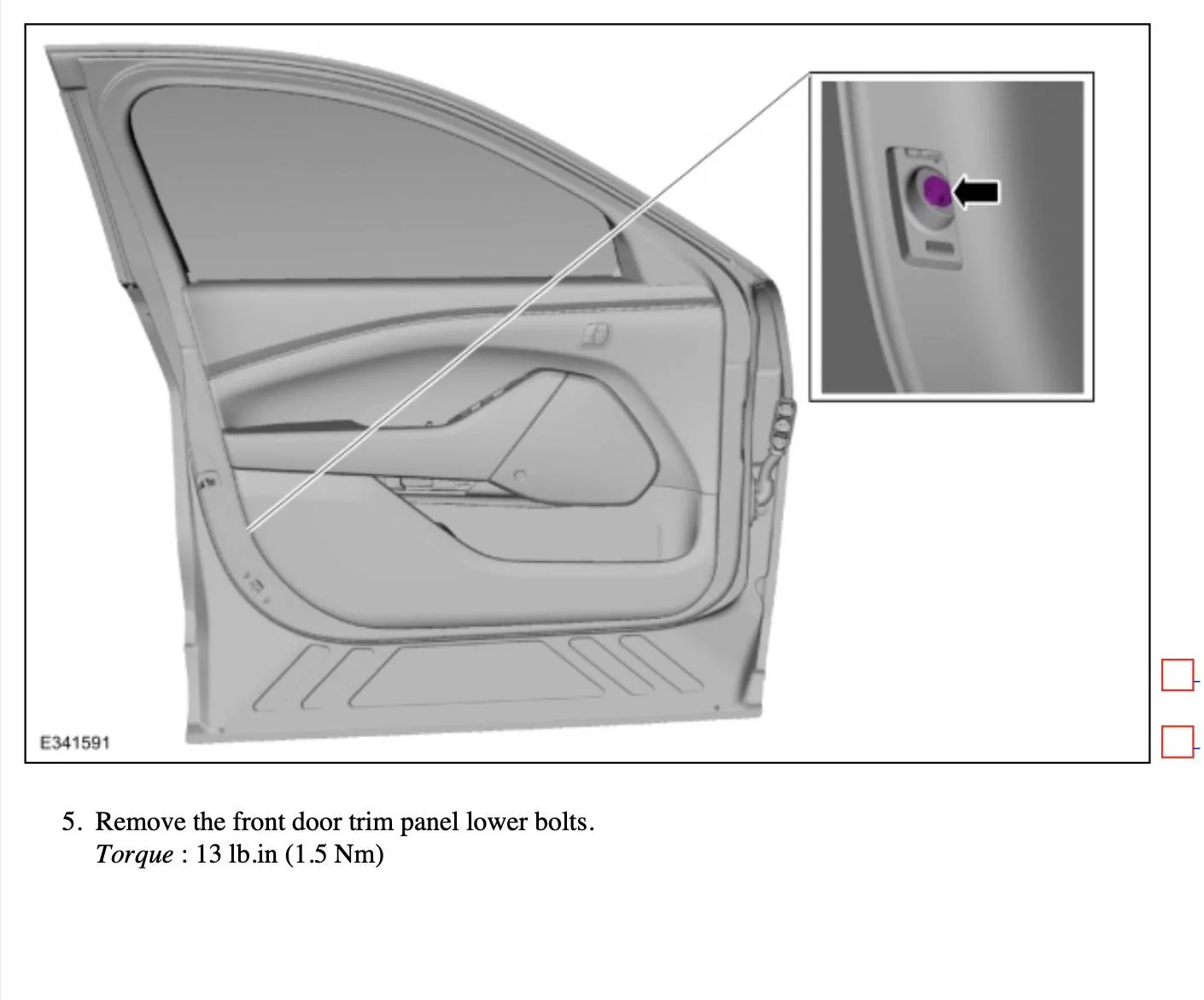

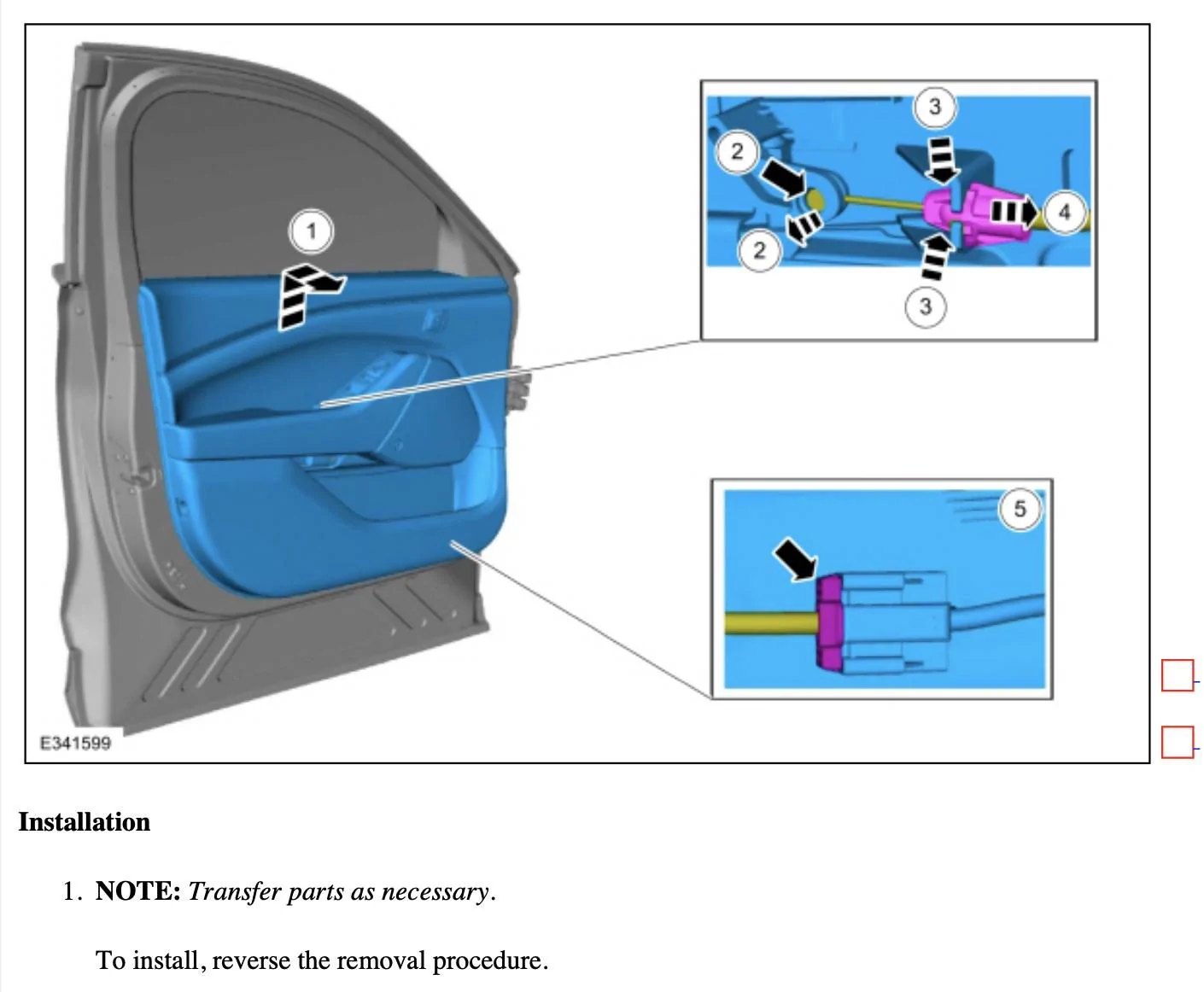

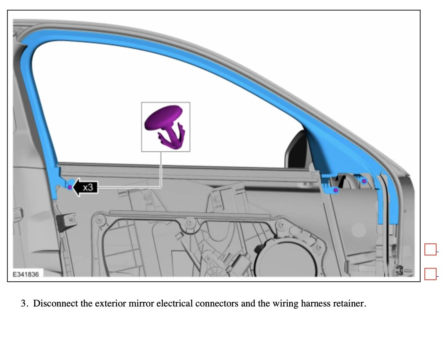

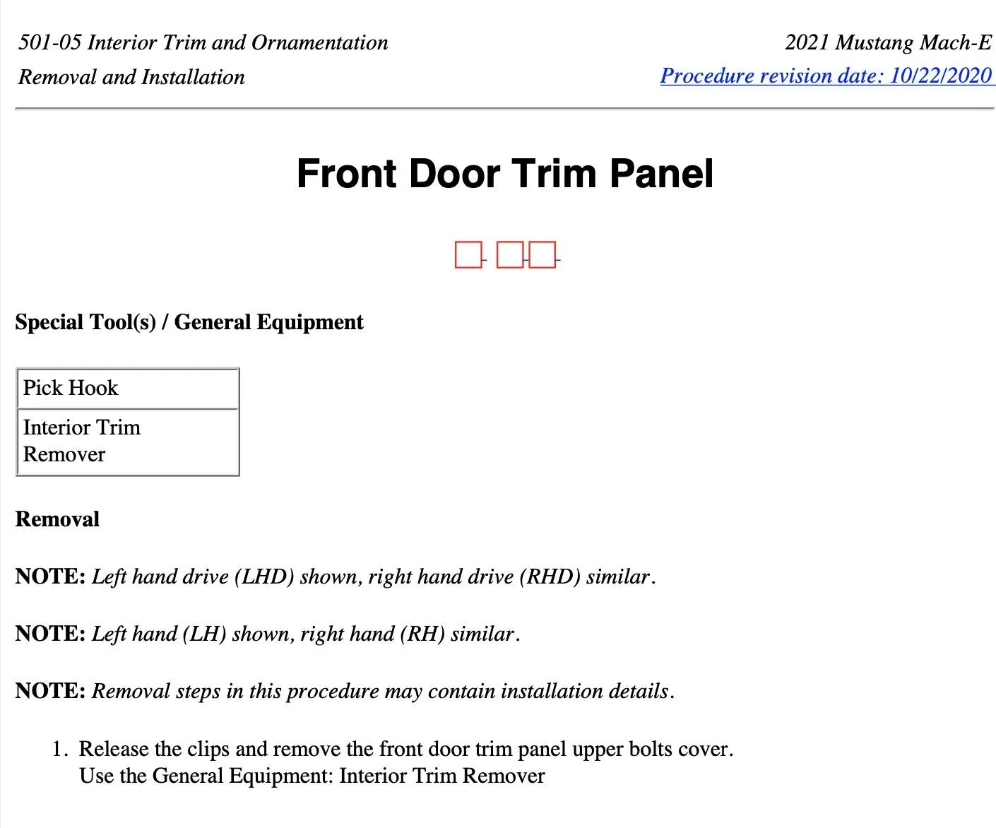

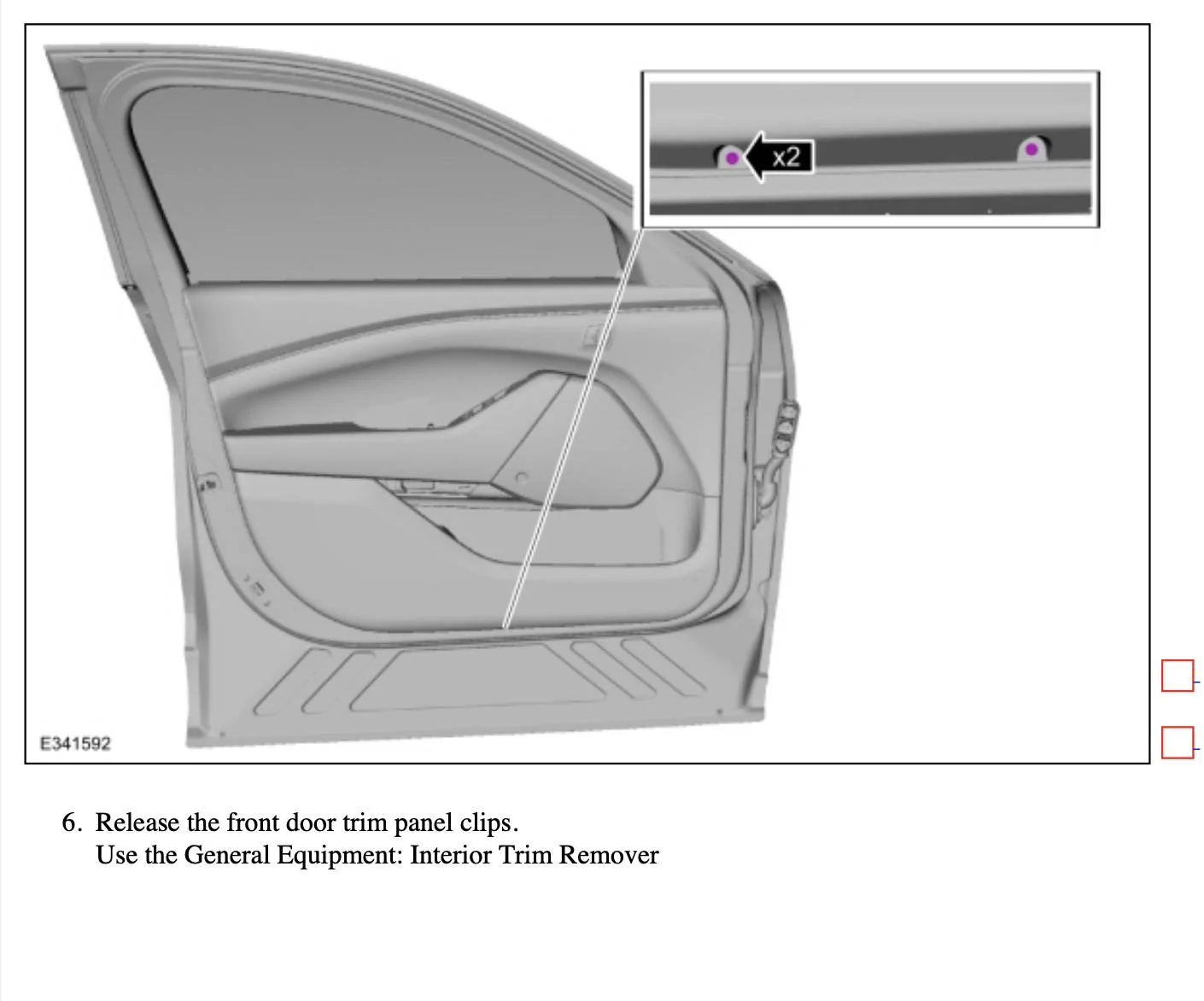

From the Ford Mach-E repair manual.
Removing Exterior Mirror:
Removing Front Door Trim Panel:
