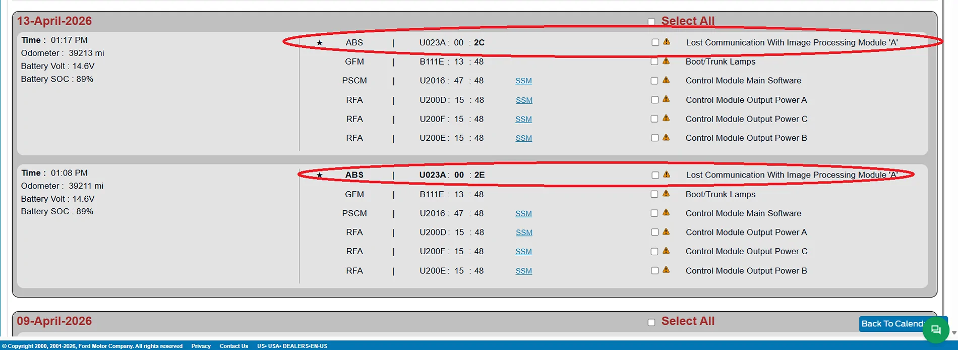

Just another +1, in an existing thread. So proud of myself for not starting a new thread.
Happened twice today. With clear weather, although it had been stormy over the weekend.

Your car reported this code today that does not appear in the code history prior to today. The ABS module lost comms with the IPMA, so you got a warning letting you know that adaptive braking is not functional. Not sure why the module lost comms, but if the issue persists, a dealer visit may be warranted.
All the other codes are stored codes and not active faults; those can be ignored.
