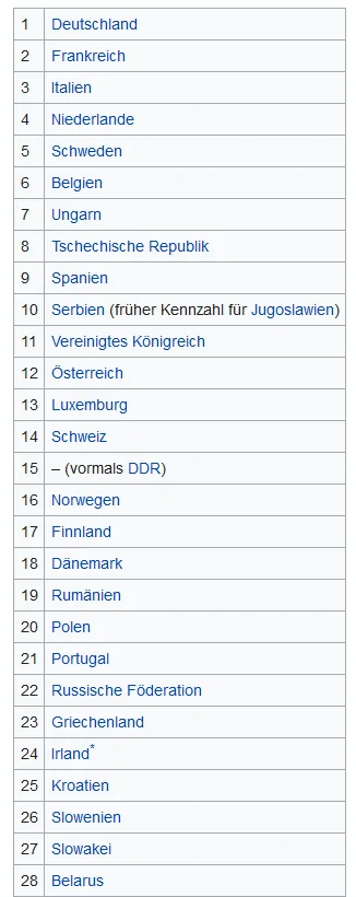

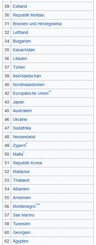

After researching the "High LED" (Select and above trim) which operates GFHB (Glare Free High Beam) in Europe I am convinced:
- The headlight housing/construction & LED photometrics are identical in all markets. (Good ford)
- I believe the difference lies with the LED control module (The aluminum box that is attached to the bottom side of the headlight)(BAD FORD!)
- The "High LED" headlights in Germany, Norway, & Sweden are basically the same PN - less the 2 last letters signifying a revision code
- European versions are "High LED ECE"
- ECE is "group" or whatever you call them that regulates headlights in Europe
- US versions are "High LED SAE"
- SAE is very much an American "thing" I'm surprised is does not say "DOT"
- SAE should be ashamed for having their designation on these US headlights as any "engineer" knows the design could have been much, much SAFER.
- US: LJ8Z-13C788-A
- Europe: LJ8B-13B626-BD ?
