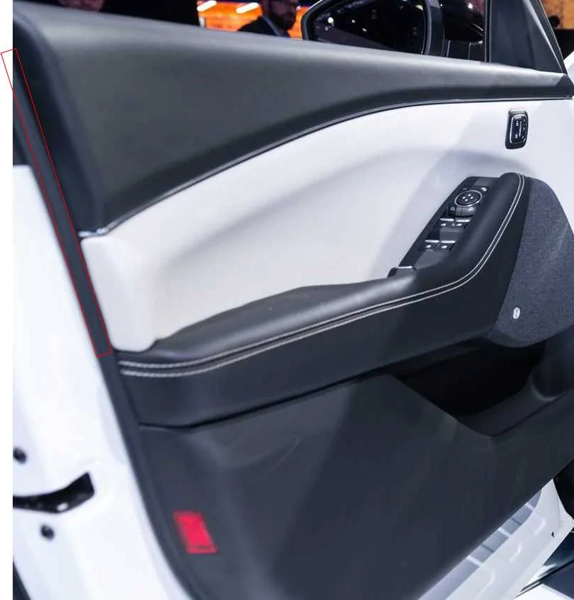

It is the driver door. Probably can't hear the sound on the passenger side. I like my car interior Rolls Royce quiet. I can't handle any of those interior rattling. Been trying to nail down which part for a while. No interior parts are loose. Finally got real close to the culprit. It was the door trim part hitting the door gasket. Once I put the finger between the gap, it stops the noise. I have been putting foam tapes around the door opening gaskets to seal the contact between the door trim and the gasket. Definitely half design issue, half bad luck. If the gap is any tighter or wider, there would not be such rattle sound.
OMG, I'm so glad I noticed this post. I have the same issue. It's a drivers-side sound that's close to the ear (very easy for driver to hear, but not passenger), and it sounds like something between a loose part and a rubber seal rubbing against something. For me it's intermittent, some drives it doesn't seem to be there at all while other times I need to play music to drown it out. Thank you for helping pin this down! I'm guessing the intermittent nature of it has something to do with how the gasket compresses when I close the door.
I got the problem fixed. I had to put foam tapes around different trim parts before I finally find the part causing the sound. It is the corner plastic trim hitting the gasket. I put a foam tape at the corner of the door trim and now it is all good. See image below.

Front passenger door? There is an unsecured something in there for sure.
Did you ever find fix or a source of this rattle? I opened up my door and it seems like something inside the inner (metal) panel. My hand is too big to fit inside the panel
