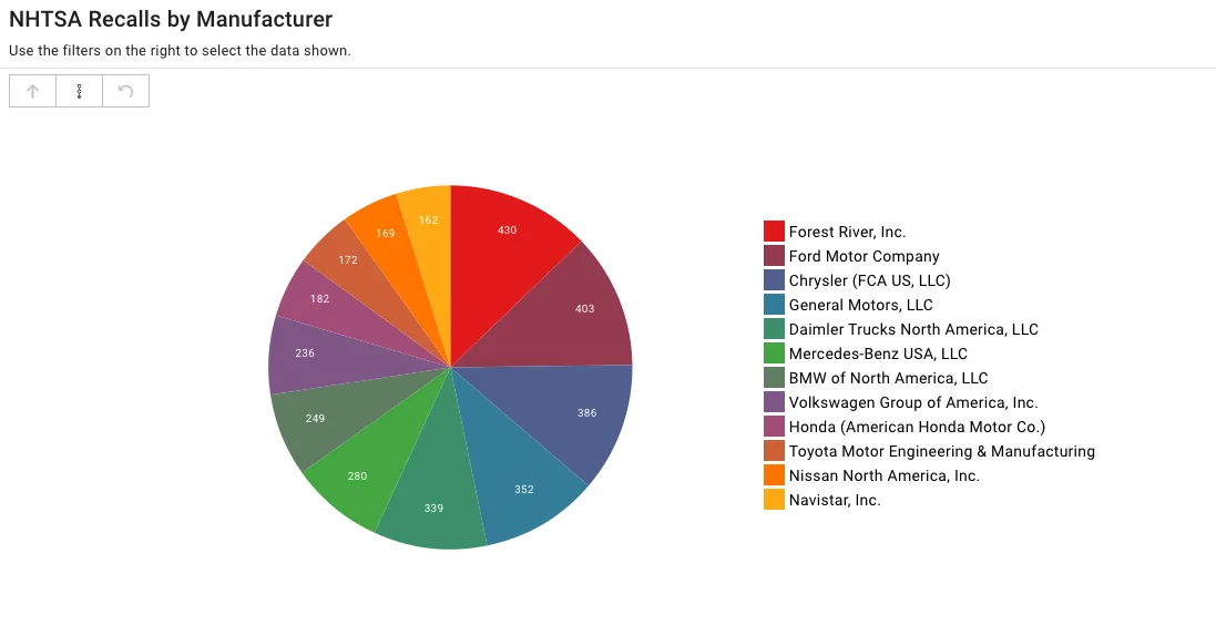

Ford has a quality issue per recall data from the NTSA over the last 10 years. The CEO has also said as much. Yes, other manufacturers have issues but not to the degree that Ford, GM and Chrysler do.
Ford Mustang Mach-E Goodbye Mach e 1660926020459
I have owned 2 Ford's and overall I like them, but the Japanese makers are much more reliable.
