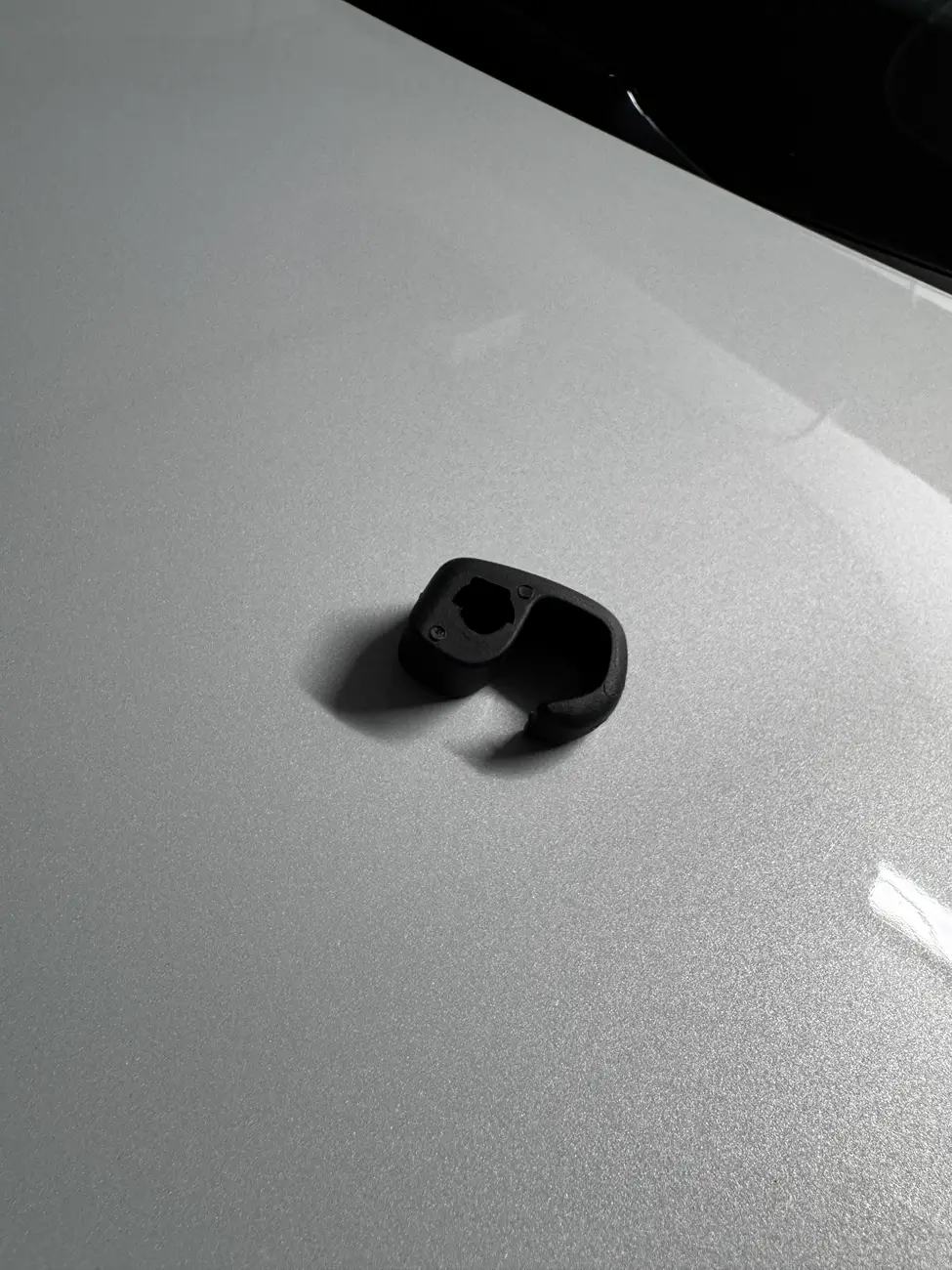

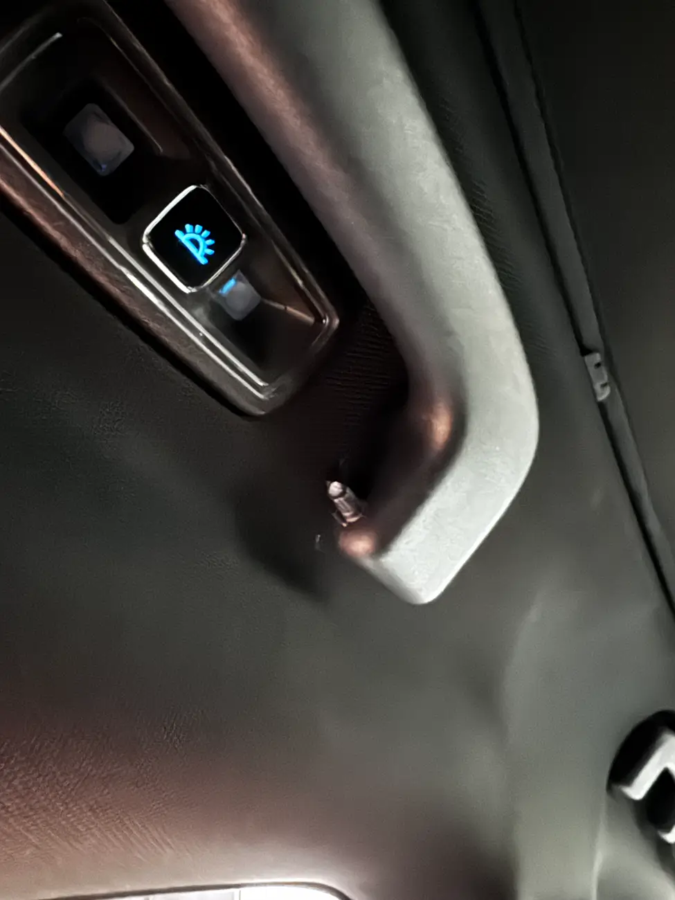

Does anyone have instructions for replacing the grab bar? My rear left grab bar coat hook broke off and I was hoping to fix it.
I've attached photos to show the coat hook and the grab bar after separation.
Ford Mustang Mach-E Grab Bar Replacement - Coat Hook Broken IMG_8306
Ford Mustang Mach-E Grab Bar Replacement - Coat Hook Broken IMG_8307
Edit: Found part numbers for 2022 Mach-E with Dark Interior
* Front (Left or Right): LC5Z-5831406-EG
* Rear left: LC5Z-5431407-BJ
* Rear right: LC5Z-5831406-BH

Ordered the replacement part LC5Z-5431407-BJ for approximately $54 including shipping.
It was super simple to replace, probably less than 5 minutes with a trim tool.
Steps:
  1. Pop off the trim from the replacement handle -- when I got it, it was already preassembled.
  2. Pop off the trim from the handle on the car.
  3. Pull off the old handle from the car. For me, the little metal clips got stuck in the car.
    • Pull out the metal clips out of the car.
  4. Push the new handle into the car.
  5. Press the trim pieces into the slots.
You really can't mess it up either. The trim pieces are specifically cut to the side that they can be inserted.
