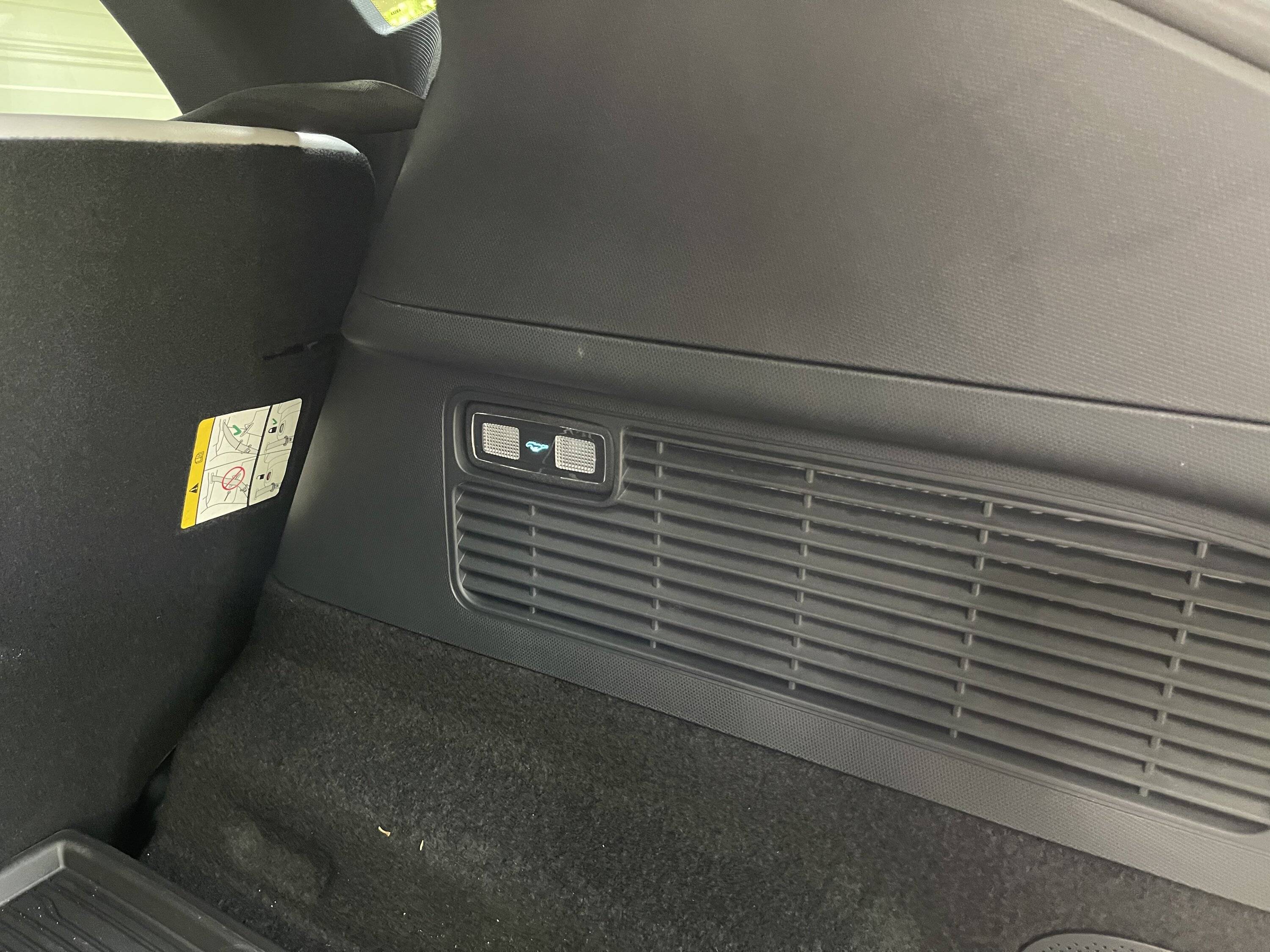

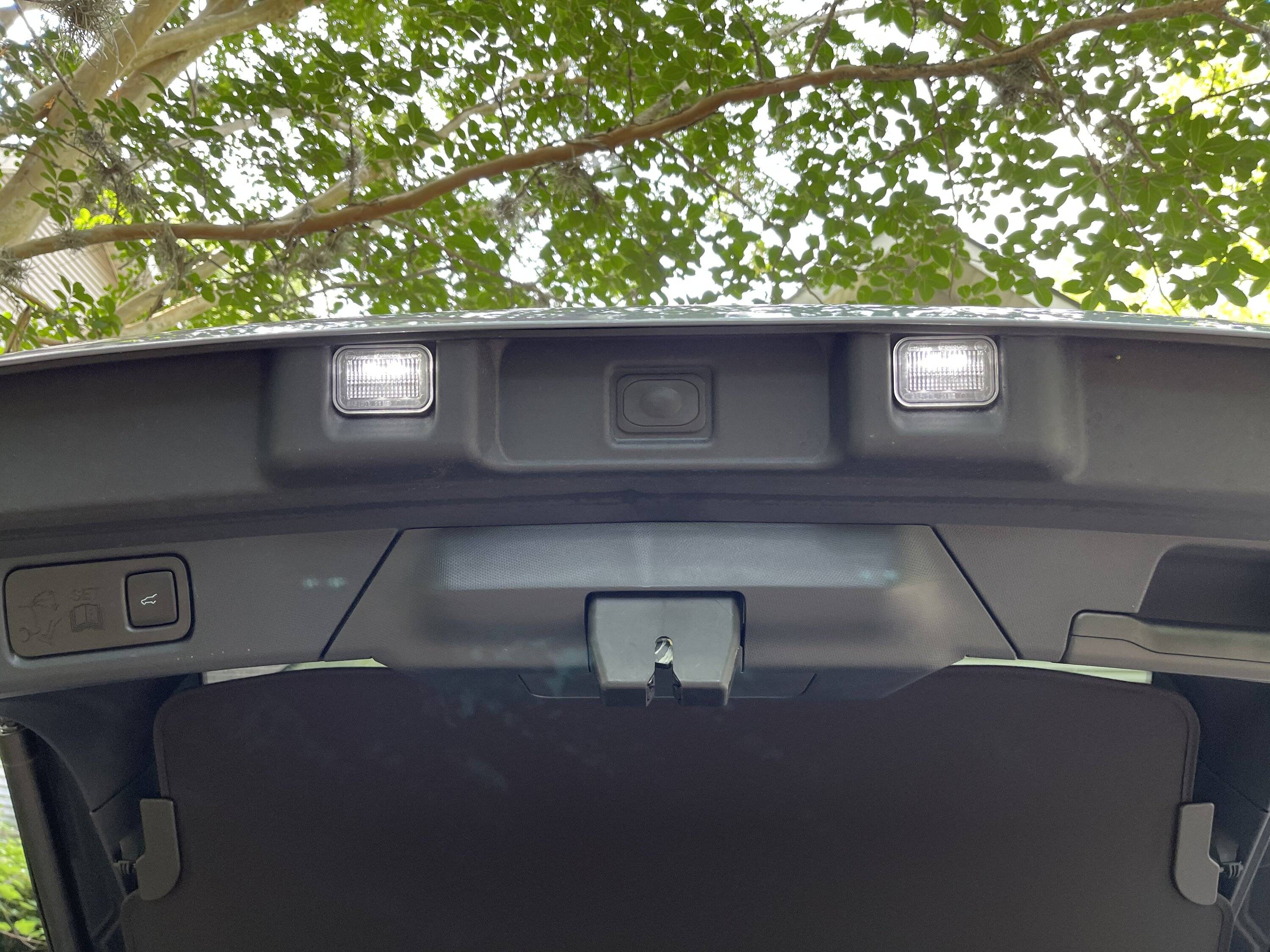

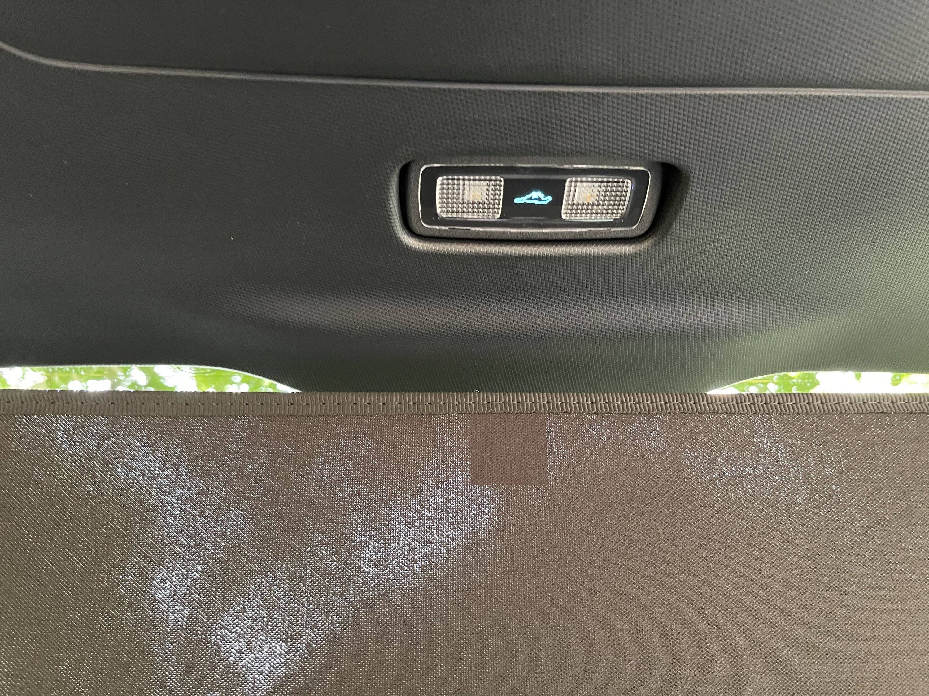

I have been trying to get interior lights on at night with no luck. Especially the ones in the trunk. Only the ones on the tailgate will illuminate. The ones that should illuminate the trunk area never illuminate.

I was able to turn on the trunk light using the overhead console button. I cannot get it to turn on when I open the trunk. This is absolutely stupid that the trunk lights only work if you punch the button on the overhead console.

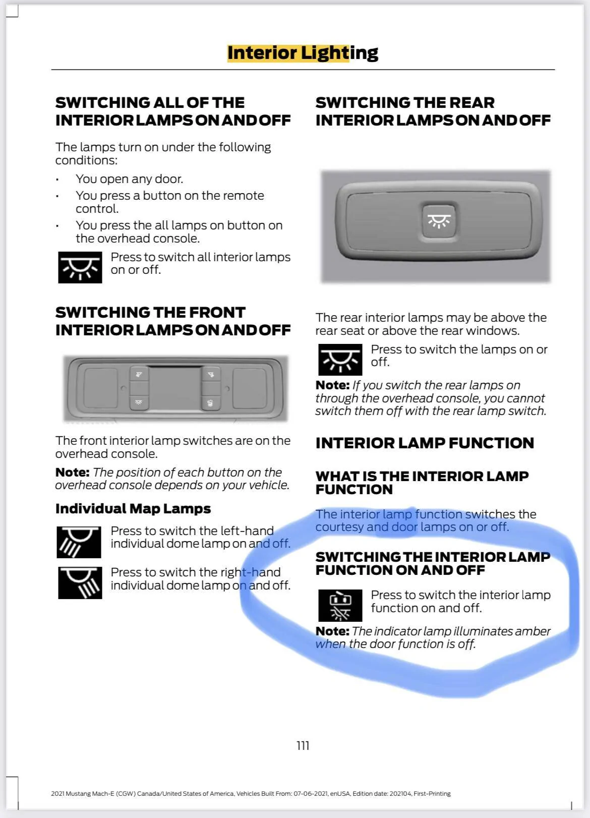

Do you have the button selected in the upper console?
When I was a kid and dinosaurs roamed the earth, this function was called "courtesy lights."
@Gullwingdmc has answered your question with a page from the manual. I applied this advice from the manual and got my courtesy lights to work when any door is opened, including the hatch. Got this working just last night as I had some tinkering to do in the trunk and needed some light. Caveat: the lights only stay on for a while and then you'll have to open a random door again.
Allow me to paraphrase the manual:
See the button circled in blue? It looks vaguely like a space alien with a feather in his/her cap dancing in a grass skirt wearing a bandolier across his (or maybe her) right shoulder and left hip. Look for that little button in your overhead console. If it is illuminated yellow or amber, press it. It will no longer be yellow/amber, and your courtesy lights including those in the trunk area will light up just like downtown when you open any door including the trunk hatch.
Easy-peasy.

I’m not venting, just trying to get it to work like I would expect. After reading P T Magoo I was able to make it work as I expected. Thanks for your help, PT
