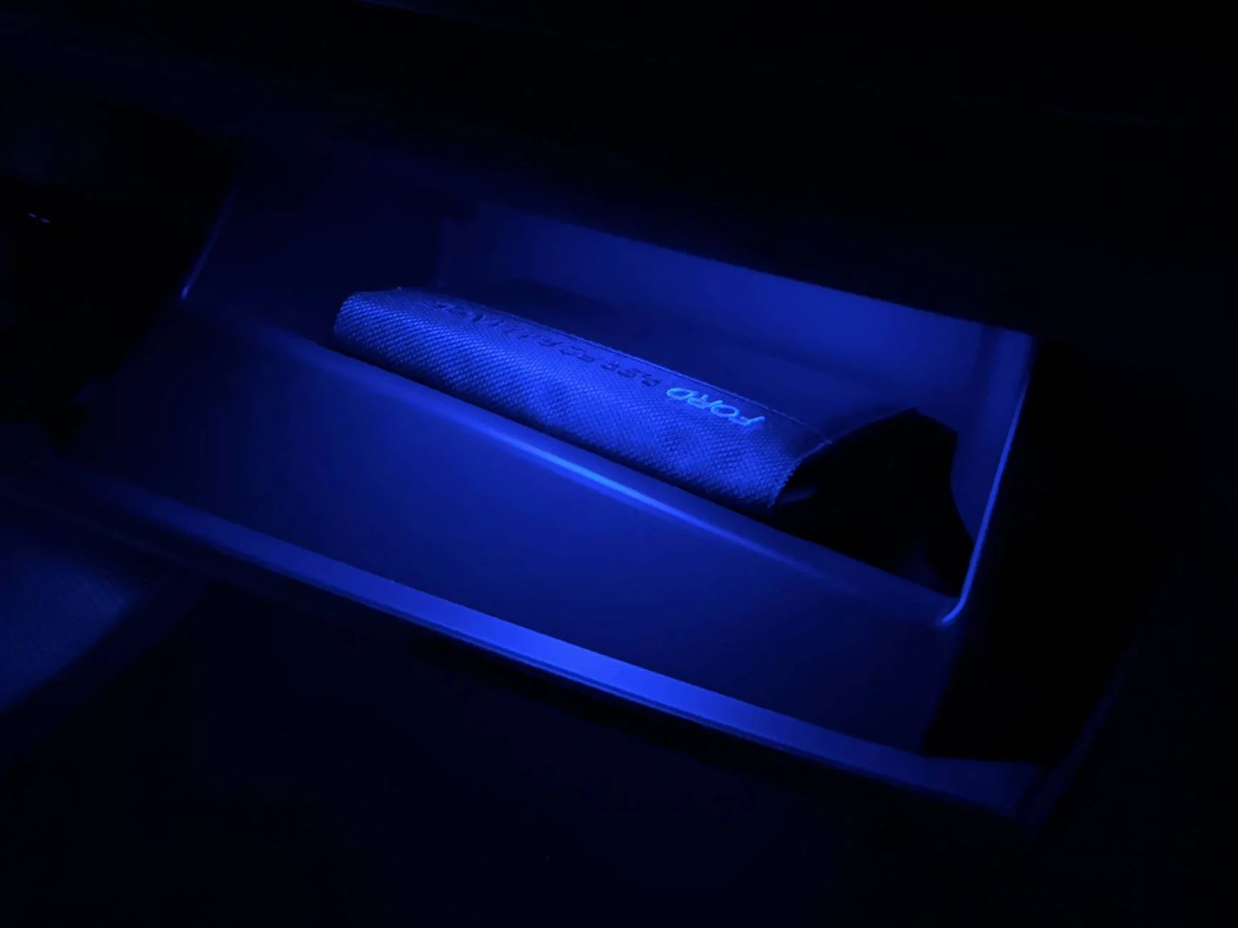

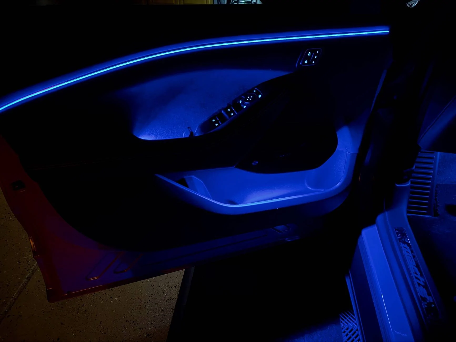

Had a bit more time yesterday and after thinking about it, I did not like the fact that the lighting I installed in the rear door storage pockets were brighter than the OEM front door storage pockets. So.... I replaced the OEM ones in the front doors with the ones from the kit. Now they all match. Then after it was all together, decided to pull off the doors again and install a light in the grab handle of each door to light the door release lever. Also added a light in the glove box. The kit comes with all of these in case you want to use them. So now the only lights I did not use out of the kit is for behind the speaker grills which I will not be installing.
Front door
Ford Mustang Mach-E Has anyone installed interior LED trim lights? IMG_3965 (1)
Rear door
Ford Mustang Mach-E Has anyone installed interior LED trim lights? IMG_3970 (1)
Glove box
Ford Mustang Mach-E Has anyone installed interior LED trim lights? IMG_3971 (1)
Front door
Rear door
Glove box

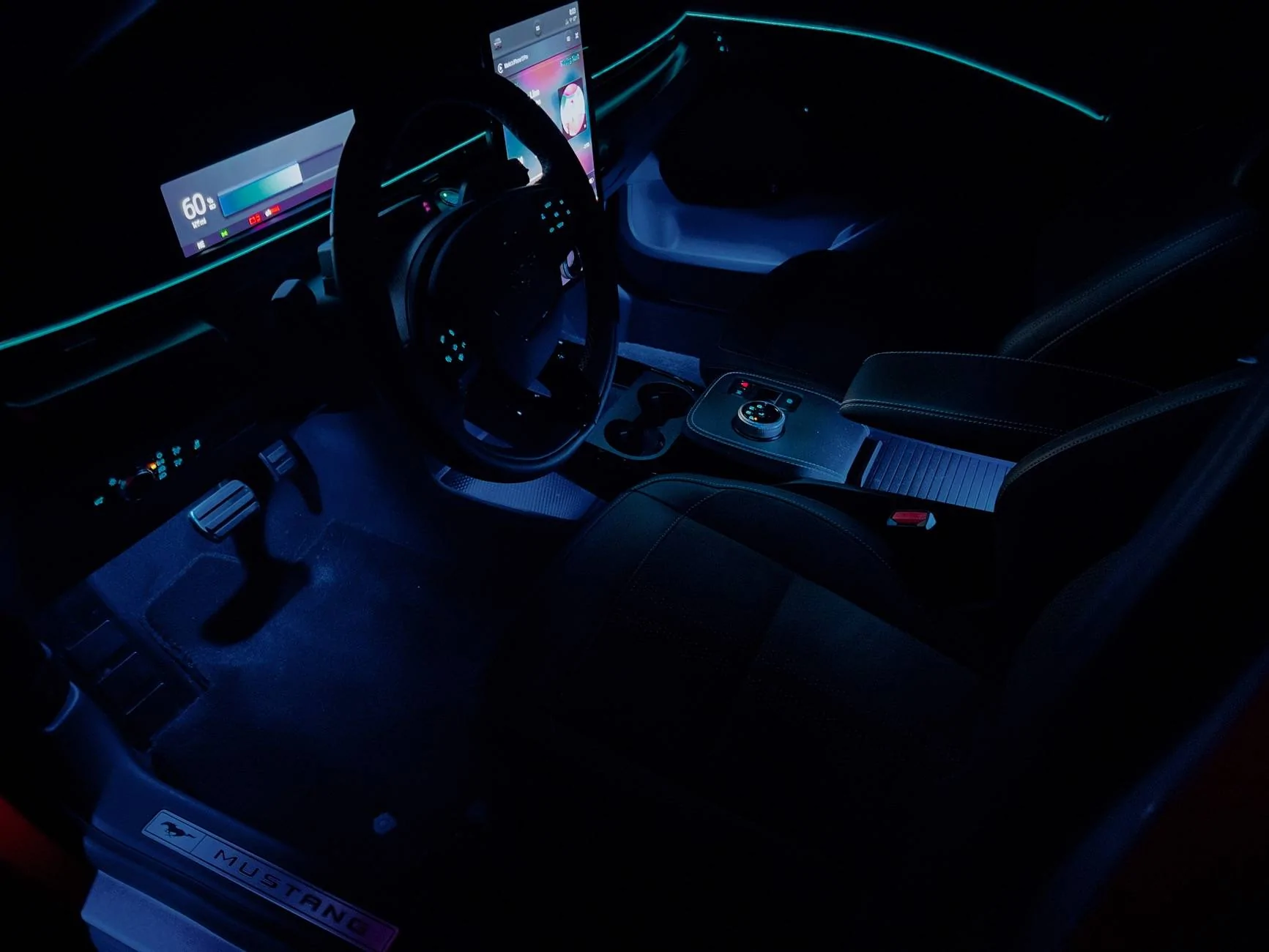

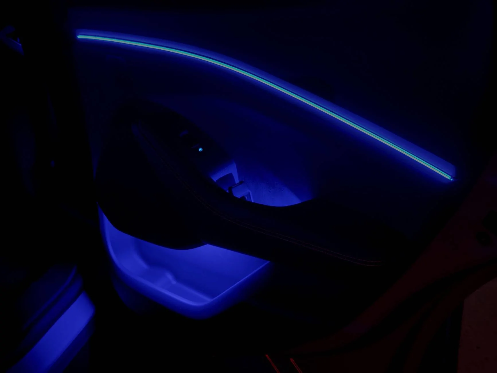

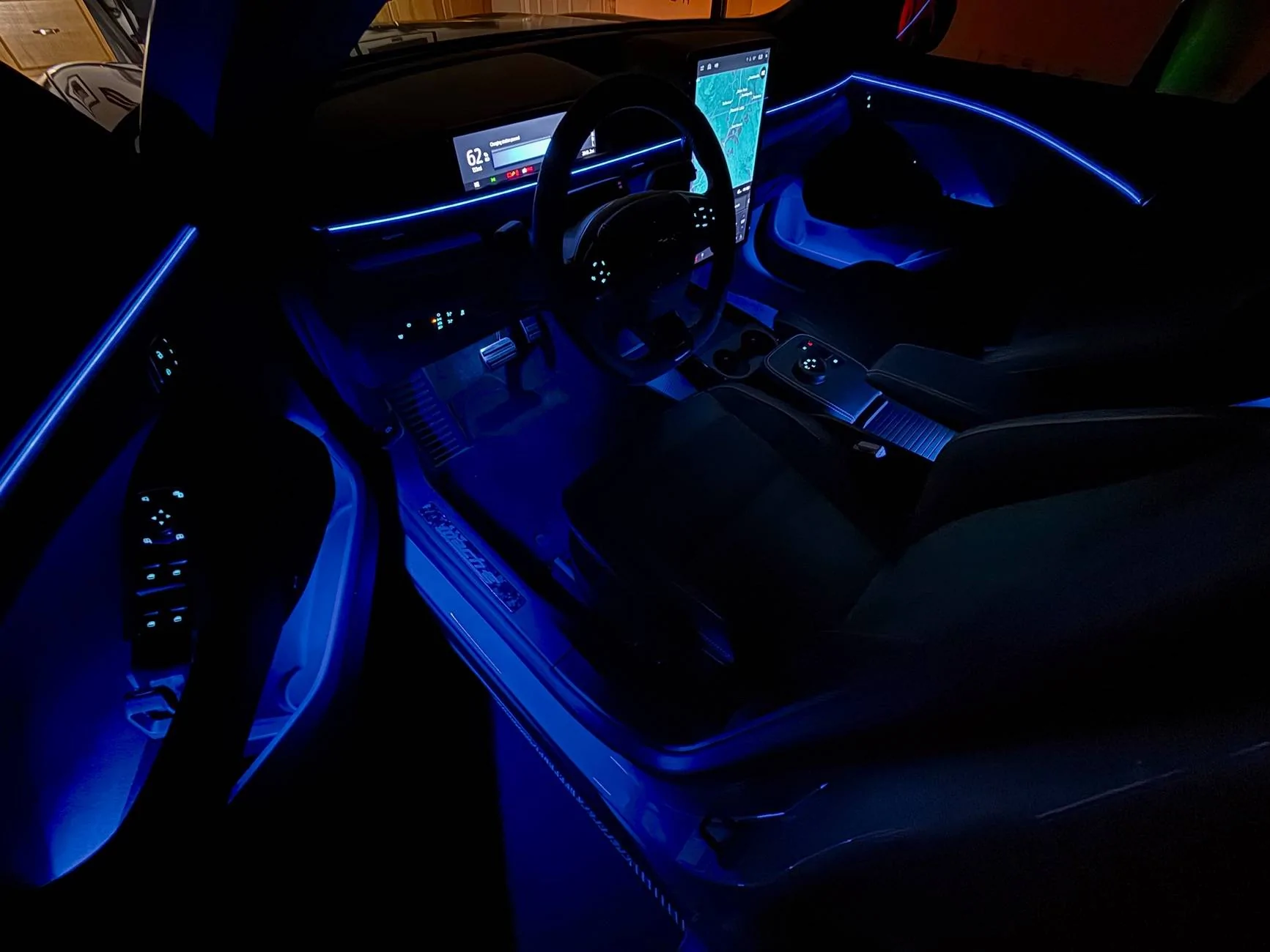

This is what mine looked like that I made up back three years ago and I hope to make it look similar.
Ford Mustang Mach-E Has anyone installed interior LED trim lights? IMG_0332D
Ford Mustang Mach-E Has anyone installed interior LED trim lights? IMG_6336

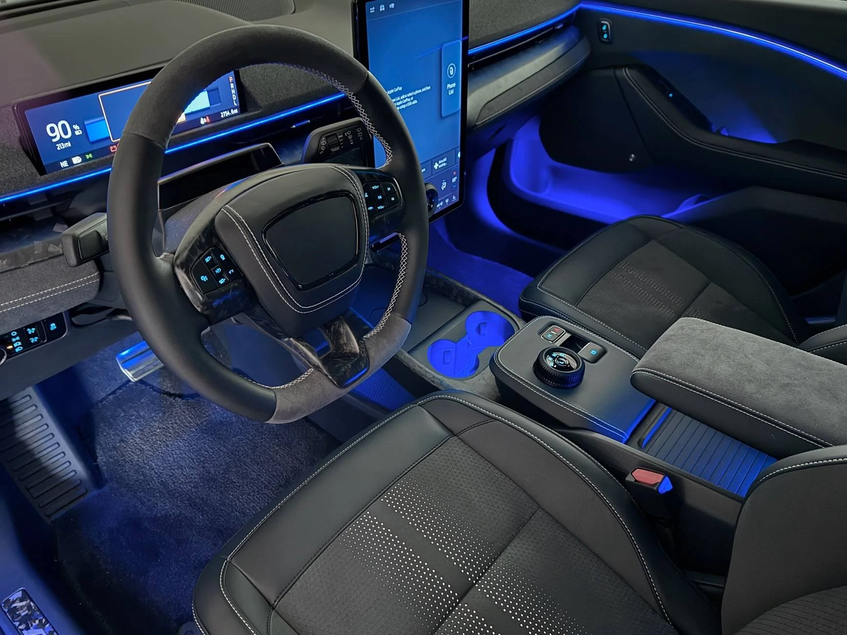

Ok Dan, here is your update ?
After working on a few modifications to get the dash light strip to look like it is a continuation of the door, I think I finally got it. I had to glue a thin support across the back where I would be mounting the LED strip light so that it is angled down to match the position of the door lighting. Then glued the light strip both on the support and dash trim. I used a hot glue gun. It was all kind of tricky. I tried different supports, adhesives, epoxies, etc. Took me most of a day to figure out the best solution.
While I got that in and done, I am not finished yet. The LED strip lights for the doors and dash are much brighter than the other lighting supplied with the kit. Even though you can dim the lighting using the Sync controls, if you dim the LED strips down to an acceptable level, then the door storage, floor lighting, etc is too dim. I am working on finding the proper resistors to dim only the LED strip lighting to more closely match the intensity of the other lights. Should have that figured out in a day or two if time permits.

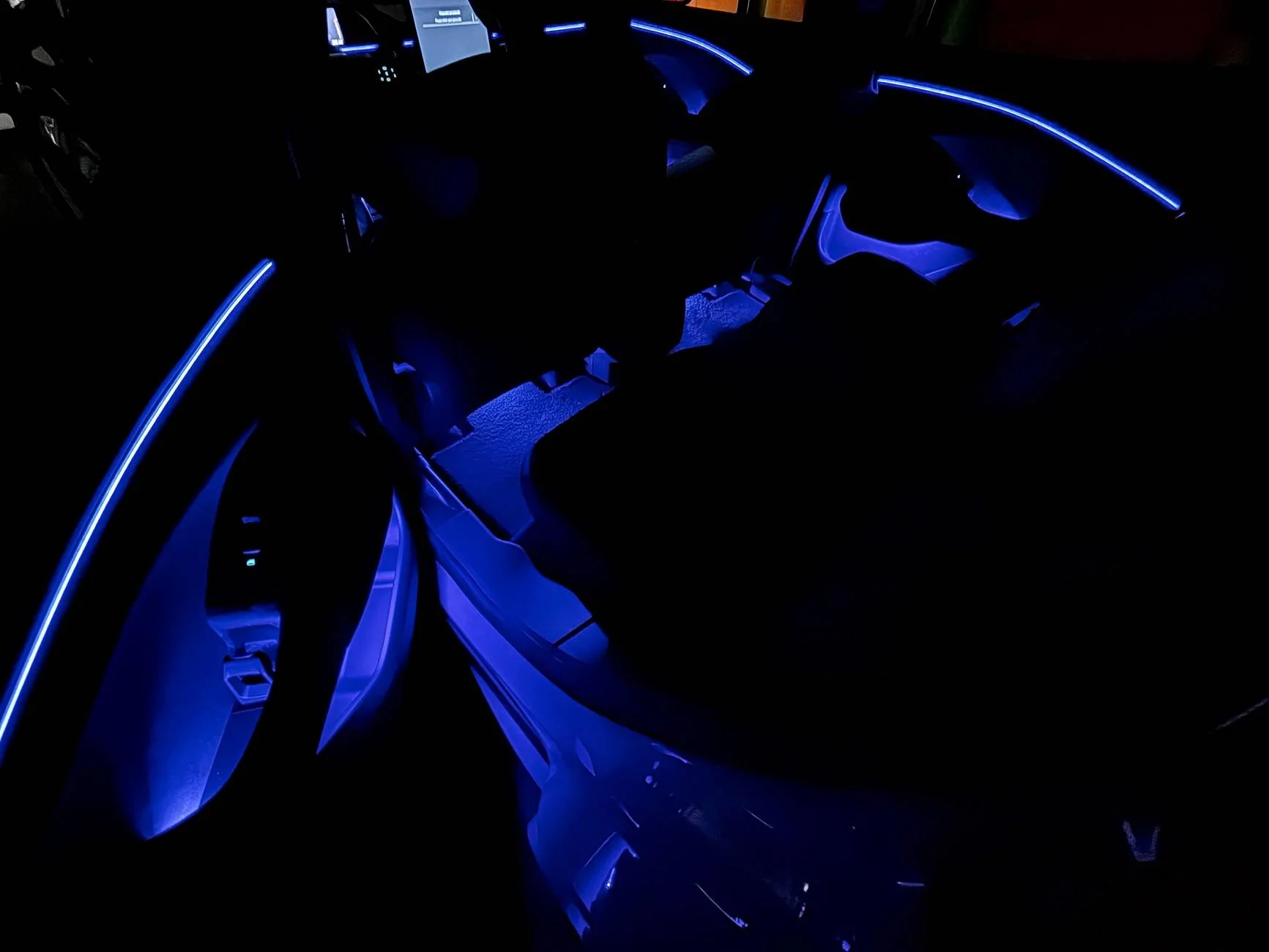

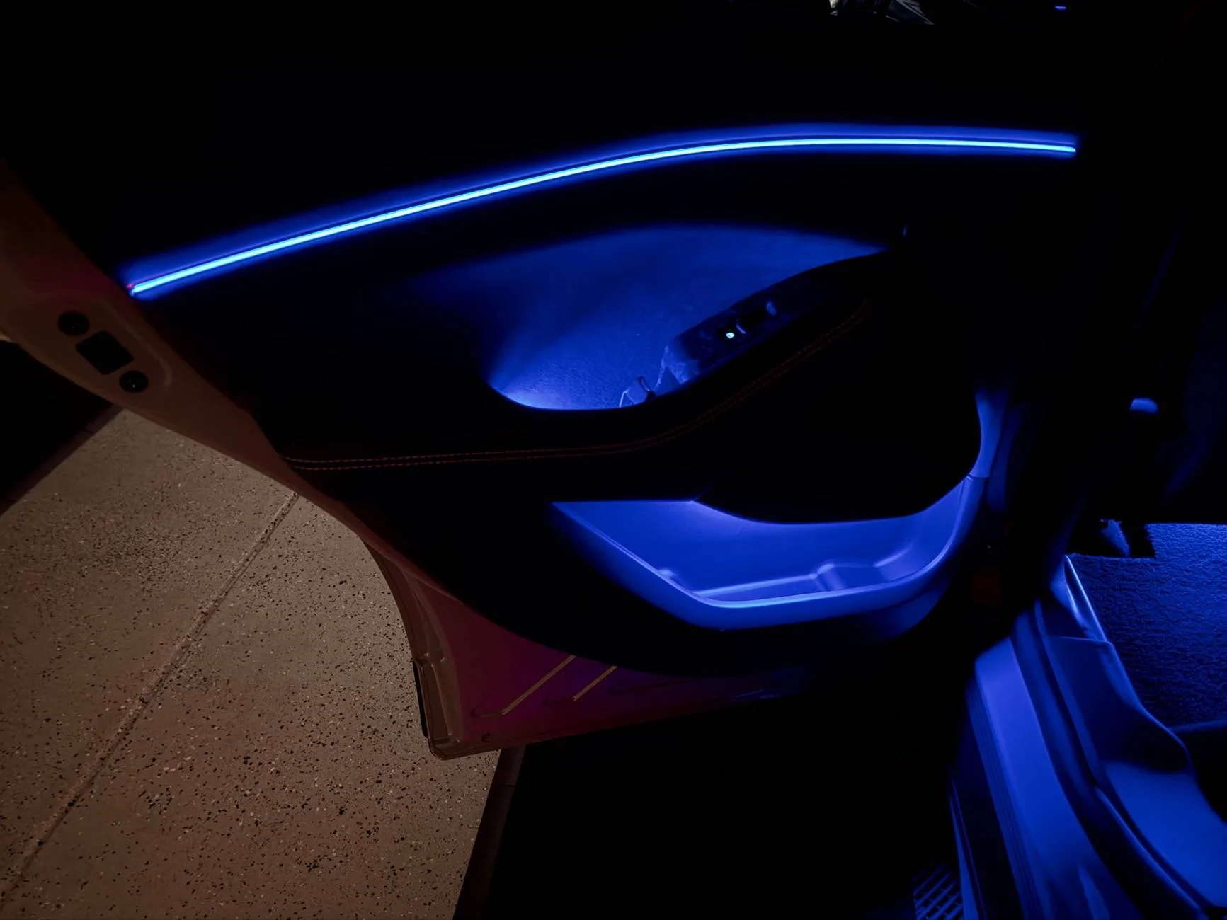

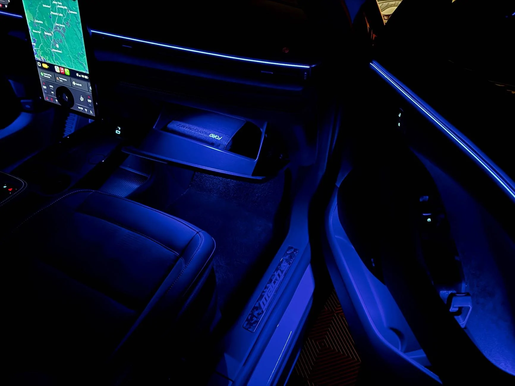

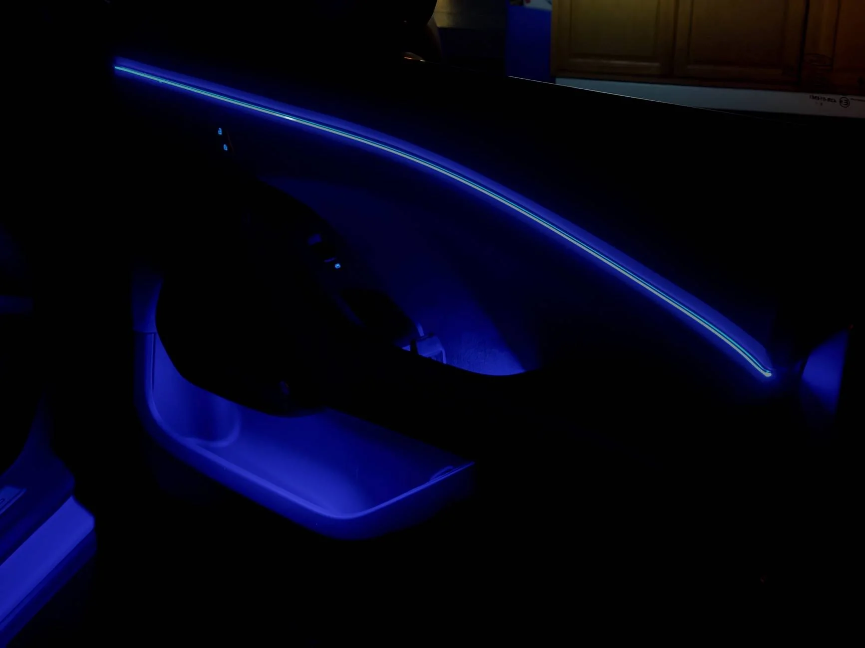

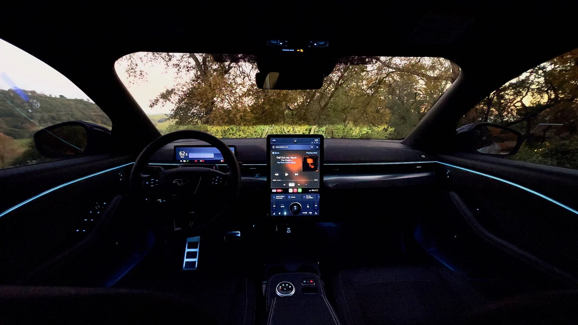

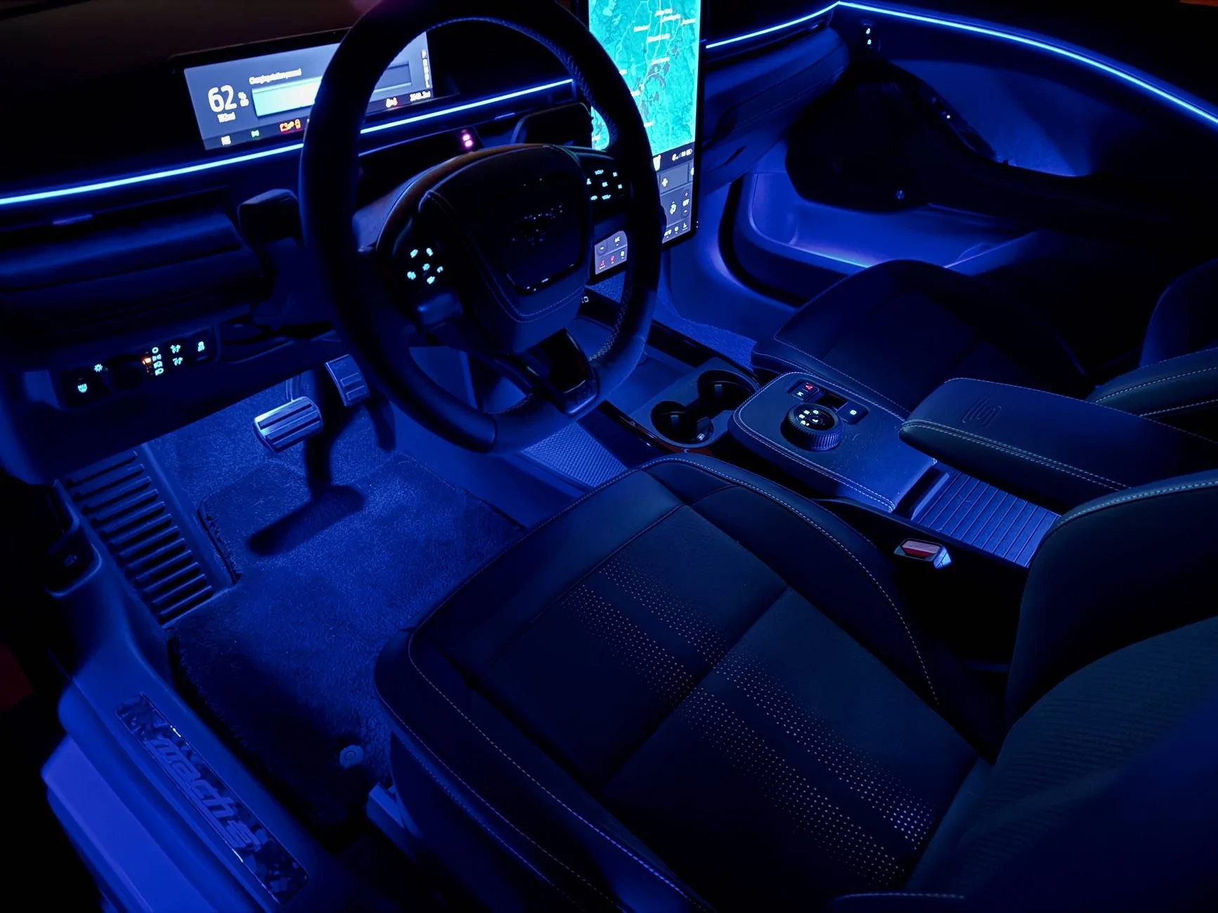

The strip lighting in on the doors and dash in the photos below are the same deep blue color as the rest of the ambient lighting. They just show up much lighter (more white) in the photos but they aren't.
Ford Mustang Mach-E Has anyone installed interior LED trim lights? IMG_4296
Ford Mustang Mach-E Has anyone installed interior LED trim lights? IMG_4299
Ford Mustang Mach-E Has anyone installed interior LED trim lights? IMG_4302
Ford Mustang Mach-E Has anyone installed interior LED trim lights? IMG_4301
Ford Mustang Mach-E Has anyone installed interior LED trim lights? IMG_4303
Ford Mustang Mach-E Has anyone installed interior LED trim lights? IMG_4305
Ford Mustang Mach-E Has anyone installed interior LED trim lights? IMG_4563
Ford Mustang Mach-E Has anyone installed interior LED trim lights? IMG_4579-30
