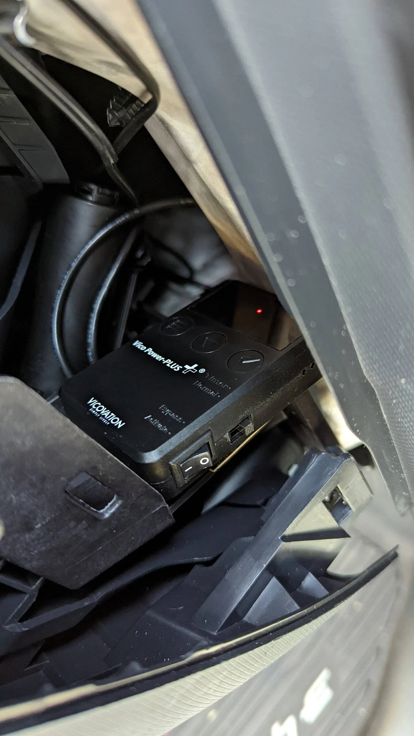

Received the Vico Power Plus and got it installed. Pretty neat little device with an LCD that shows current voltage as well.

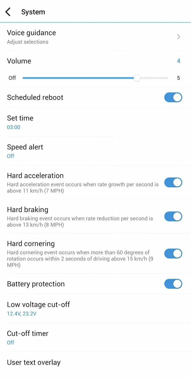

I think you are using a BlackVue, is that correct? Why do you need any extra device to change the cut-off voltage? It is under Settings->Firmware->System
That's only available on some models. I have the LTE version which I prefer because it will send notifications of impact when the car is turned off via Verizon Wireless (in my case). This makes it similar to sentry mode.
The LTE version doesn't have voltage and timer settings.
Got ya, I thought that was an app feature independent of the camera model. Good to know.

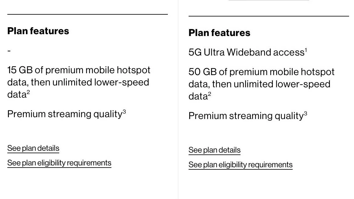

I prefer everything hidden as much as possible and I think the jetpack is more expensive than a data sim. The data sim with Verizon is unlimited for 10 a month.
Texas-E
May 16, 2021
284
499
Texas
2021 Mach-E
I understand. Assuming you have the DR750X-2CH LTE Plus, it didn't have Verizon as a carrier option when I looked that them, and I really wanted 4K. Since I have other Verizon phones, 15GB a month is $10, or 50GB a month is $20. They all say unlimited, but they are not... they throttle it back.
The DR900X-2CH Plus 4K has to have an add-on LTE module which is $169ish and still no Verizon... so a Jetpack on my plan was almost a wash in cost of the device (and I can use it someplace else).
I'm not busting on your choice, just explaining how it worked out to be a wash for me with the DR900X-2CH Plus 4K.
