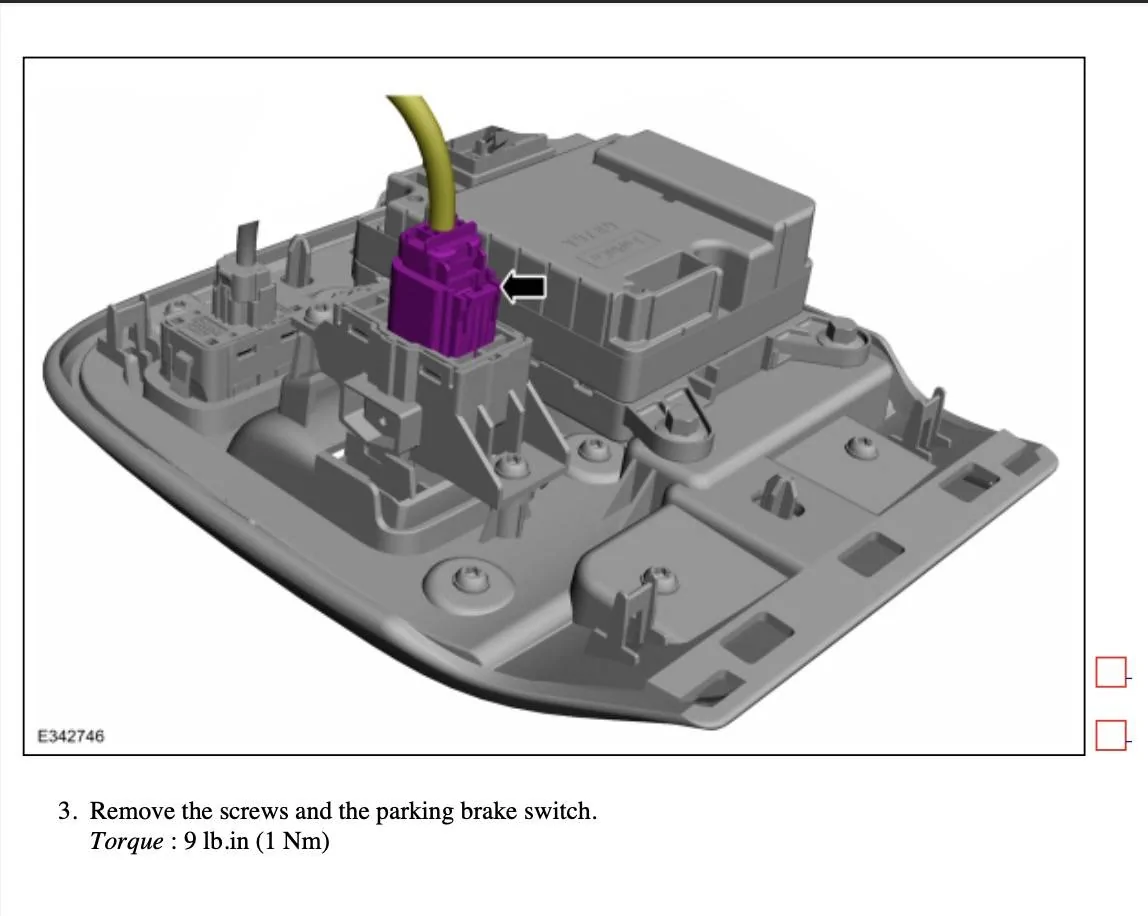

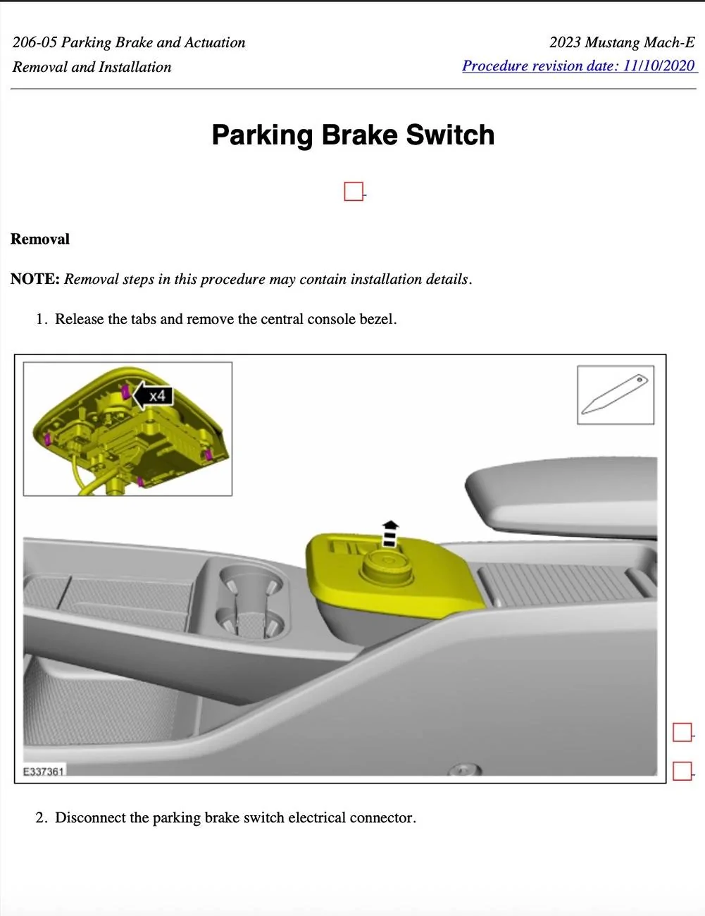

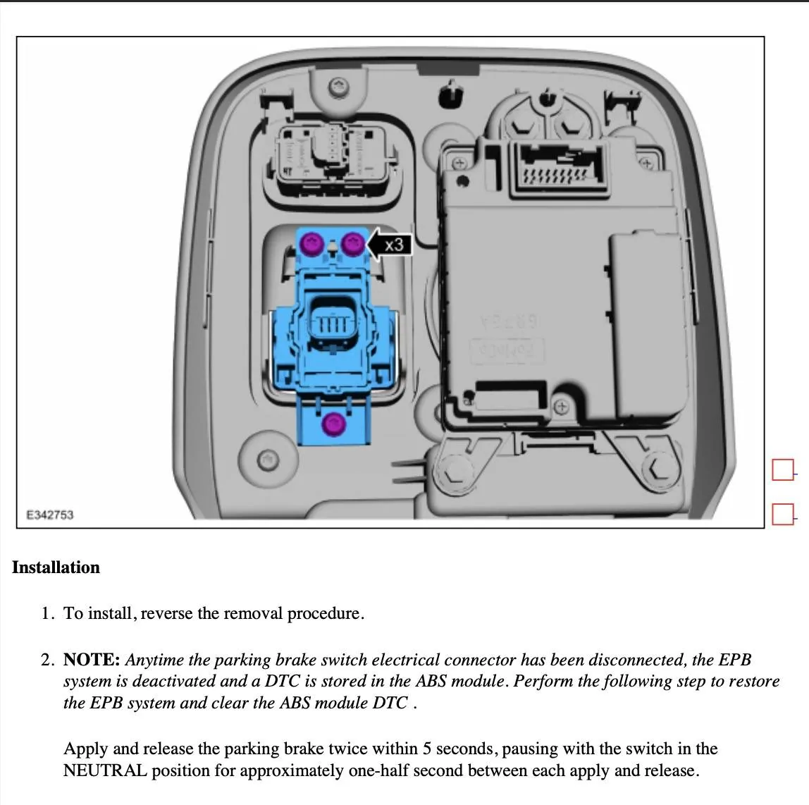

Mine somehow has a crack in it. No idea how as I’m gentle on the interior….
Here is how you do it if you are interested and the part number is GJ5Z-2B623-CB
Very very simple
Ford Mustang Mach-E Has anyone replaced the emergency brake button? Screenshot 2025-07-19 at 1.33.32 PM
Ford Mustang Mach-E Has anyone replaced the emergency brake button? Screenshot 2025-07-19 at 1.33.48 PM
Ford Mustang Mach-E Has anyone replaced the emergency brake button? Screenshot 2025-07-19 at 1.34.03 PM

Thank you! I was hoping it was just clips but I didn’t want to pull on it to hard.
You feel as if you are going to break it pulling that panel up but you won't. I always start in the upper right corner.
