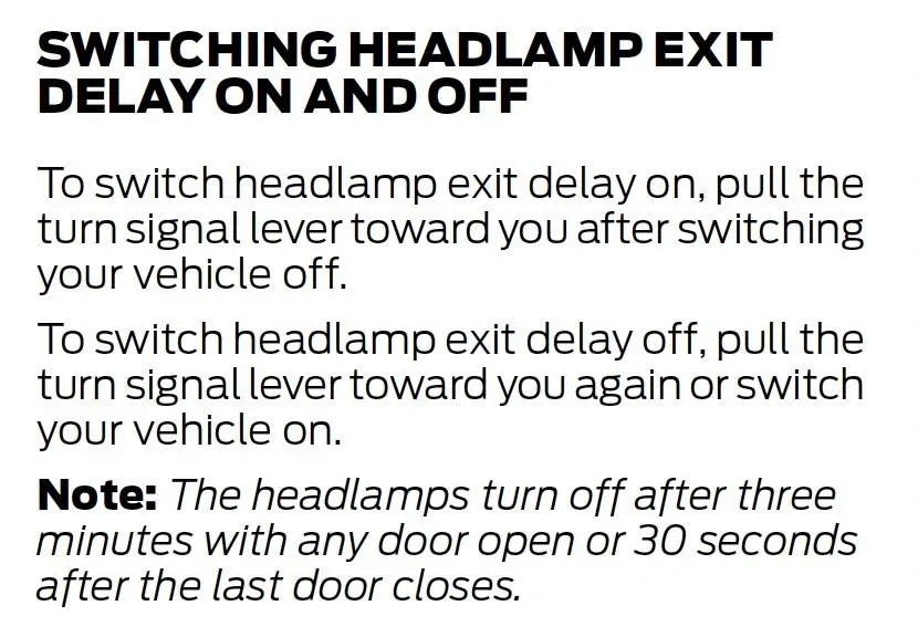

Whenever I shut off my MME in the evening the headlights stay on for 5-10 minutes. I asked the dealer about this and the response was "that's normal". The "fix" is to turn off the headlight after you've stopped but haven't shut off the vehicle. The MME puts the light switch to automatic upon start-up. If Forf monitors this forum how about a software update?

There is a delay timer in settings. If that isn't working, there is a known issue with the switch. If they don't turn off, rotate knob to off, then back to auto.
There is a new switch coming out in November or so.

TIL how you can enable/disable the headlight exit delay...
Ford Mustang Mach-E Headlight Delay Screen Shot 2022-09-19 at 11.56.30 AM
