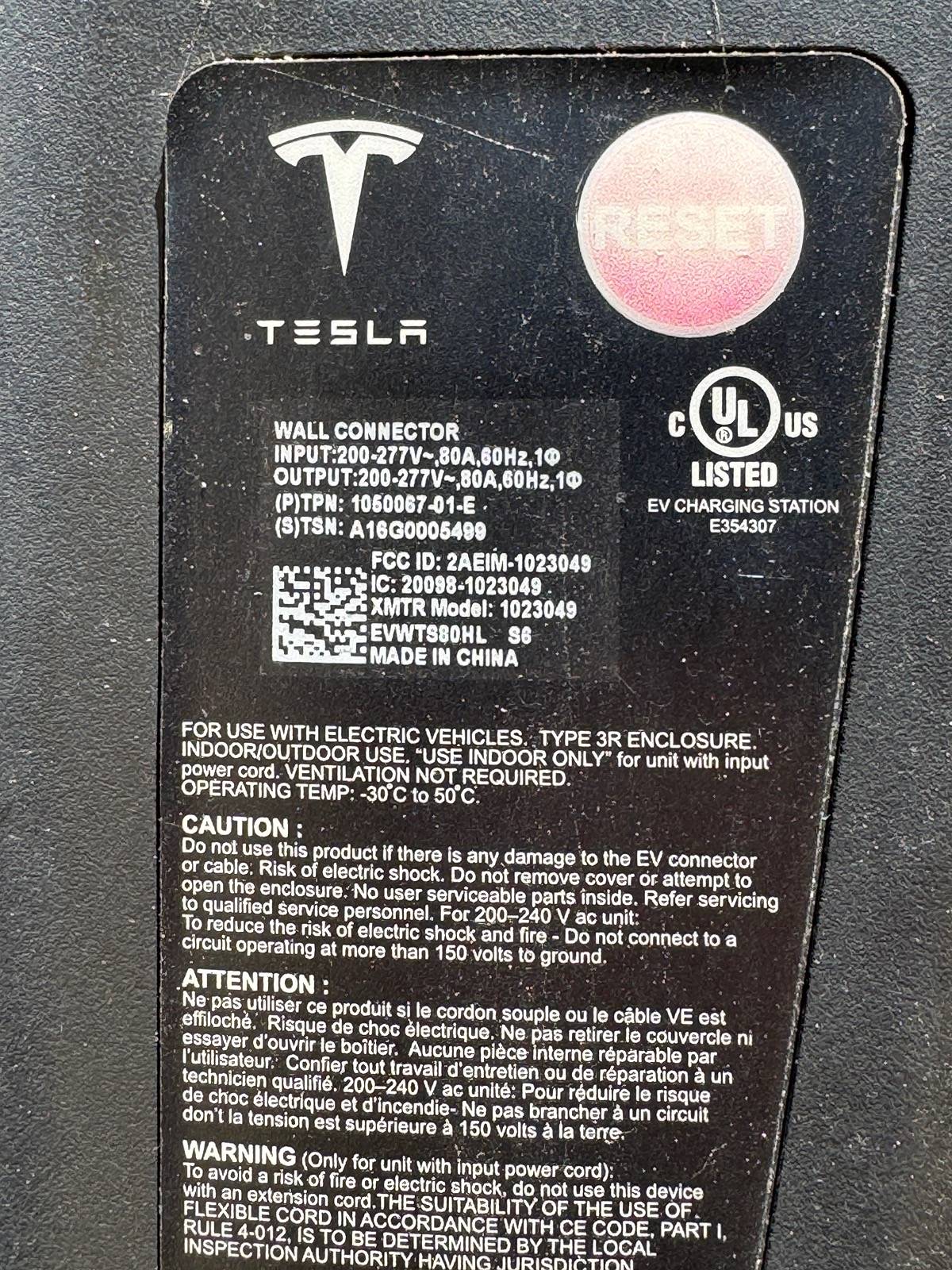

It’s a 1 or 2, has no internet/app capability. This is the sticker on it I took earlier today to read the manual.
I should ask, did you check your codes on your car to see what the exact charging fault was? Could be something odd like power quality or volt drop, Mach-E is more sensitive to those than other EVs.
That's a generation 2 wall connector. If you really want to hack it, there's a secret dip switch setting to force J1772. Remove the T10 screw on the bottom, pop off the faceplate, remove the T20 security screws, open the cover, and set dip switch #2 to off. That forces J1772 so it should work with all brands. Dip switch #1 should also be off on 240V in USA.

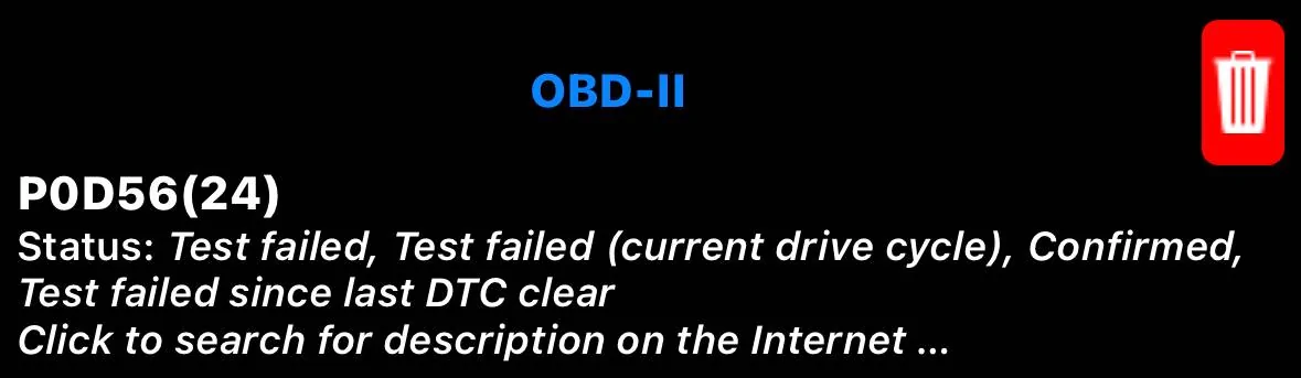

Ok I’ll try that. I tried a Charge Point just now. Same problem. This is the DTC I’m seeing. What a nightmare.
