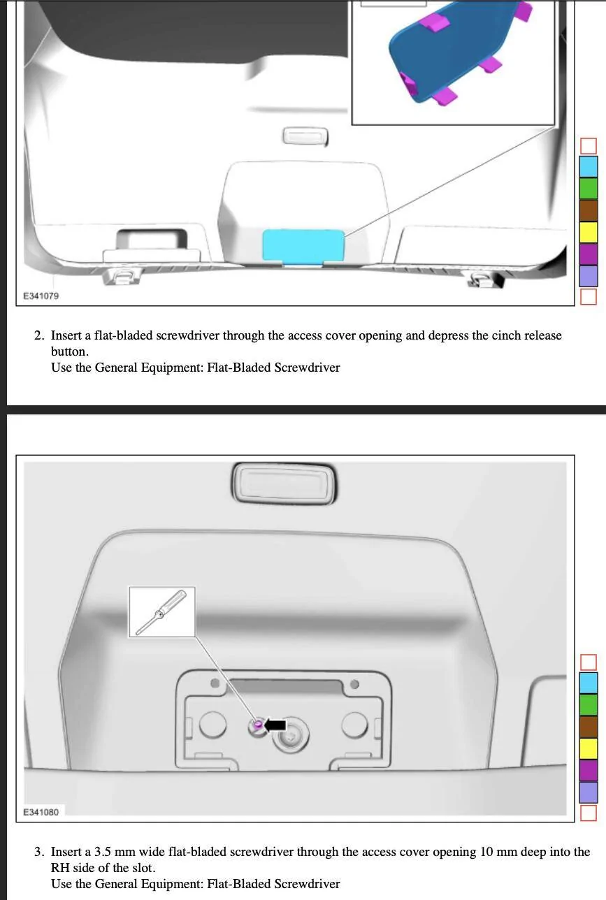

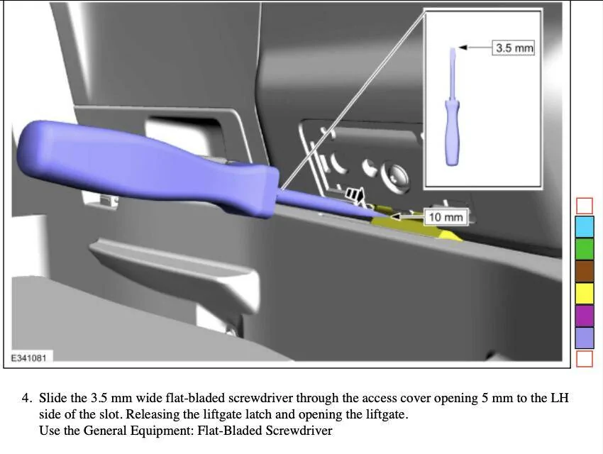

I posted a link to this above in post 9. ?
But I was so excited I could find this! (Not the 'how to remove liftgate tail lights' I was looking for and finally just tore it apart to find out.)
