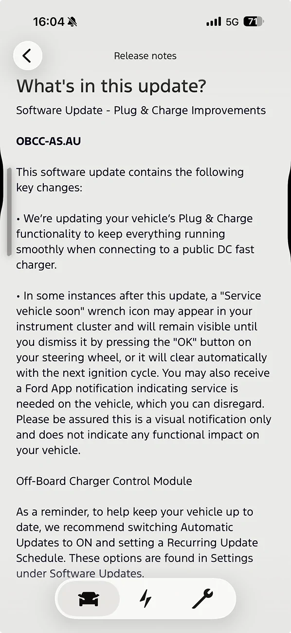

I was away for two weeks in the beginning of April. Upon my return I found that and OTA had taken place "successfully".

No idea about your specific faults but what was the OTA that installed? My last OTA had a warning about possible service vehicle soon messages after the update. For me it went smoothly and I had no such messages.

You mention that you believe these problems were caused by a recent OTA. Which OTA? Having only had one OTA a few weeks ago (after complaining to Ford due to no OTAs for at least 6 months), was when my faults appeared. My last OTA was OBCC-AS.AU (updating your vehicles Plug & Charge functionality etc).

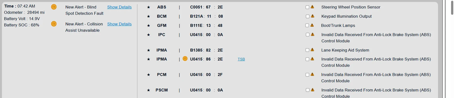

The issue(s) are not related to the OTA. That OTA was for the on-board charging controller which has nothing to do with your driver assist systems. Your car was reporting this internal electronic failure code intermitently since before you got the update sent:
Ford Mustang Mach-E HELP - Multiple fault warnings after latest OTA 1779292095556-0q
You also show this code in the BCM citing a bus/message signal failure between the BCM and the rain sensor:
Ford Mustang Mach-E HELP - Multiple fault warnings after latest OTA 1779292359197-j6
This morning, these are the codes the car reported when you say the warnings on the dash. While it is difficult to diagnose these things remotely, it seems like the issue is tied in to the ABS module being faulty or needing an update. The TSB referfenced by the IPMA U0415 is attached and does say an ABS module update is needed to address the problem.
Ford Mustang Mach-E HELP - Multiple fault warnings after latest OTA 1779292160723-a7
Your car is also intermittently reporting this code citing a short circuit to door control module F.

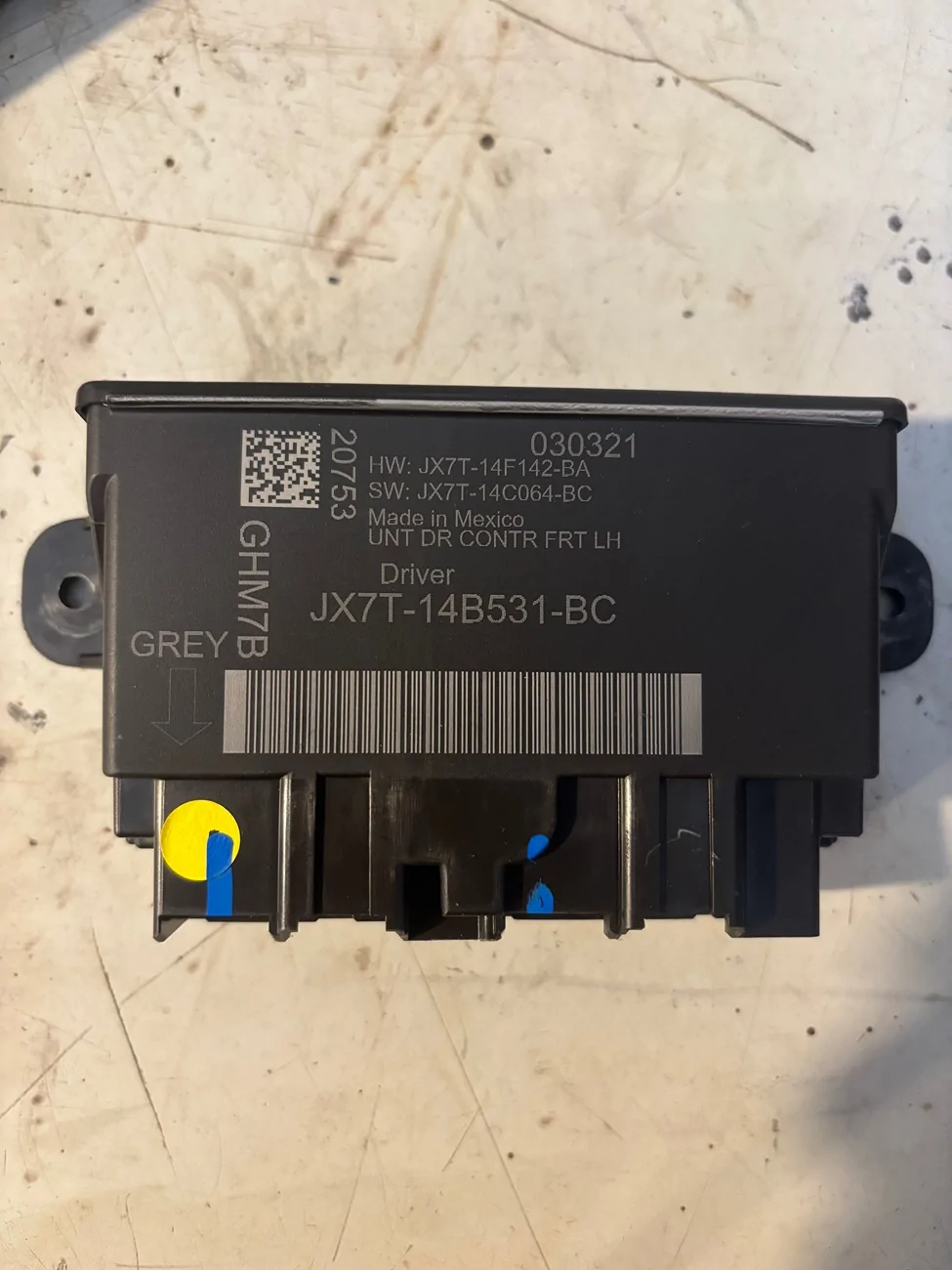

Took the door driver door panel off today and the internal panel. Couldn’t see anything physically wrong. Took the door control module off and removed the internal card, nothing appeared to be blown. Cleaned the contacts and put everything back together. Run FORscan but same faults indicating a problem with the door control module DCMF. Bought a second hand one online (£59) via a scrappy and will fit once it arrives 🤞.
It is a little strange as the writing on the module indicates it is for a LH door. Picture attached.

Hi Michael (@Michael MM)
Does the part number match the one that is in your car?
The photo is the module from my car. Hopefully the module from the scrappy will be the same (I uploaded the photo to the scrappy website so the one they send should be the same, I so hope so 🤔 🤞🤞)

I checked that part number and there were a few offers on eBay, same exact picture for Mach E
I have an FDRS license good through tomorrow. Once I am done doing what I need to do with it, I will get you the files in case you need to program it. Hopefully it doesn't ban my account before I get a chance to grab them.
Edit: I got the files. If the module is not on the AM strategy when you put it in, you should update it to the current version that the one that is in your car now is on. If that's the case, lmk and I'll walk you through it. You would need FORScan.
