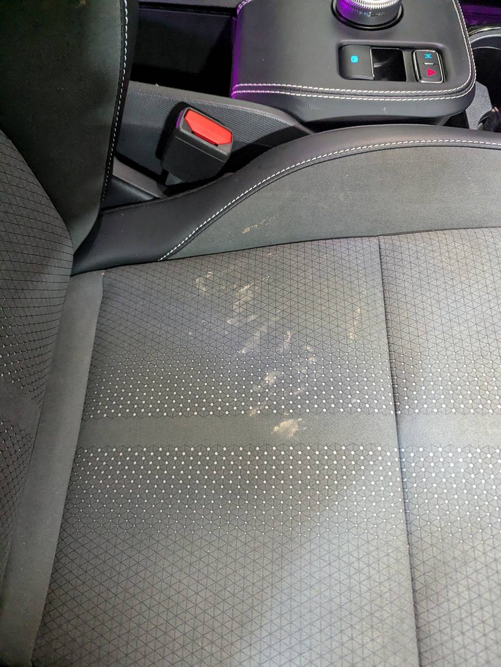

· Left my passenger seat with dirt on them ? Like seriously....

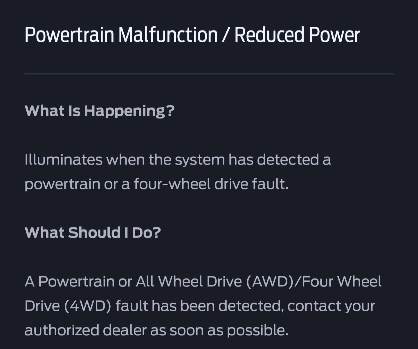

I first received an alert whilst driving. Wrench symbol in the heads up?
I was driving rural and this what showed on app.
Ford Mustang Mach-E High Voltage Battery Warning+Powertrain Malfunction 1000027324
Car continued to drive on reduced power, I had baby in back, so there was no pulling over - just straight home.

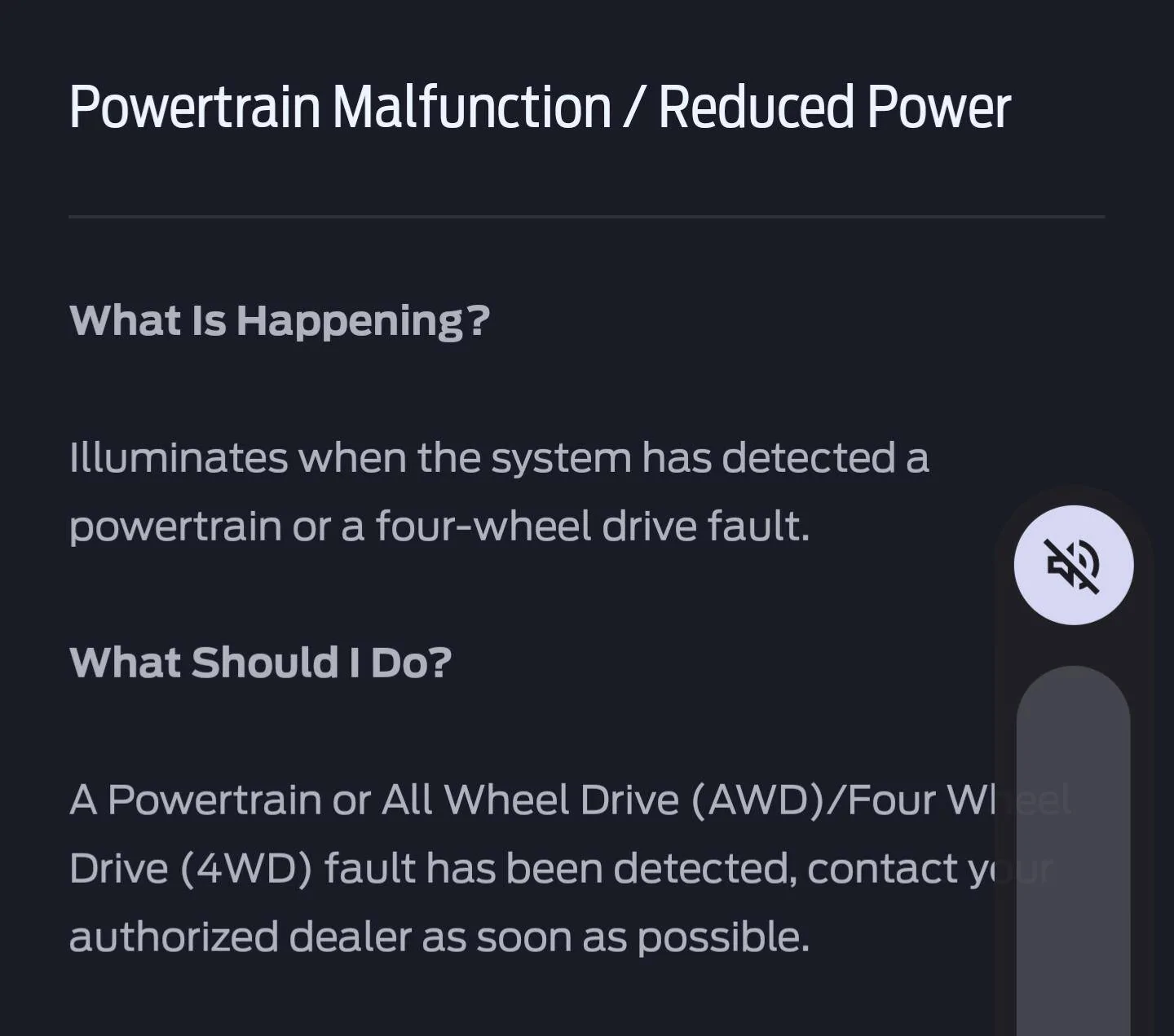

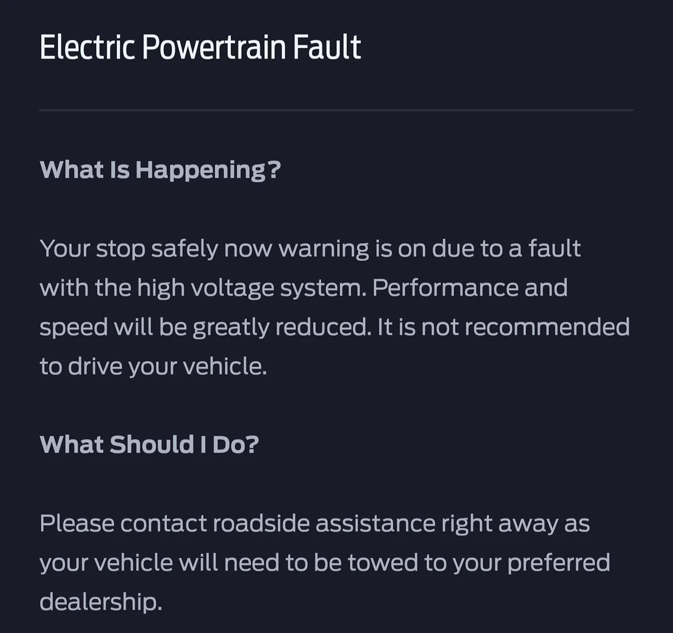

Presumably shortly after, unbeknownst while I was driving I received another prompt.
Ford Mustang Mach-E High Voltage Battery Warning+Powertrain Malfunction 1000027323
This was on the app when I got home. So I assumed it had to of warned me during my drive. Yet I knew the car drove...
Called roadside. They were prompt. However since I was home & there was a snow storm we mutually agreed to have car picked up the car next day.
