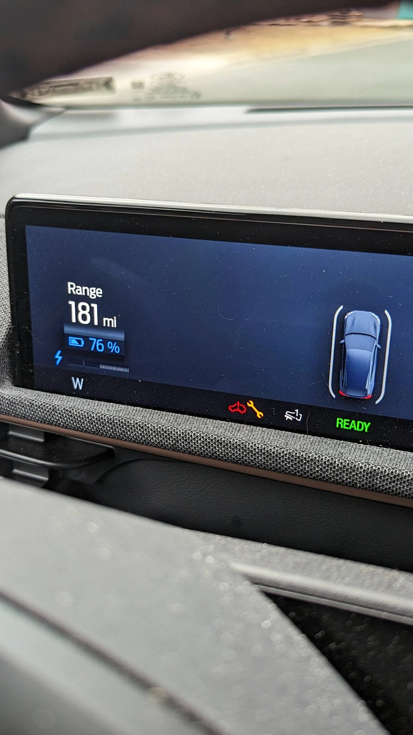

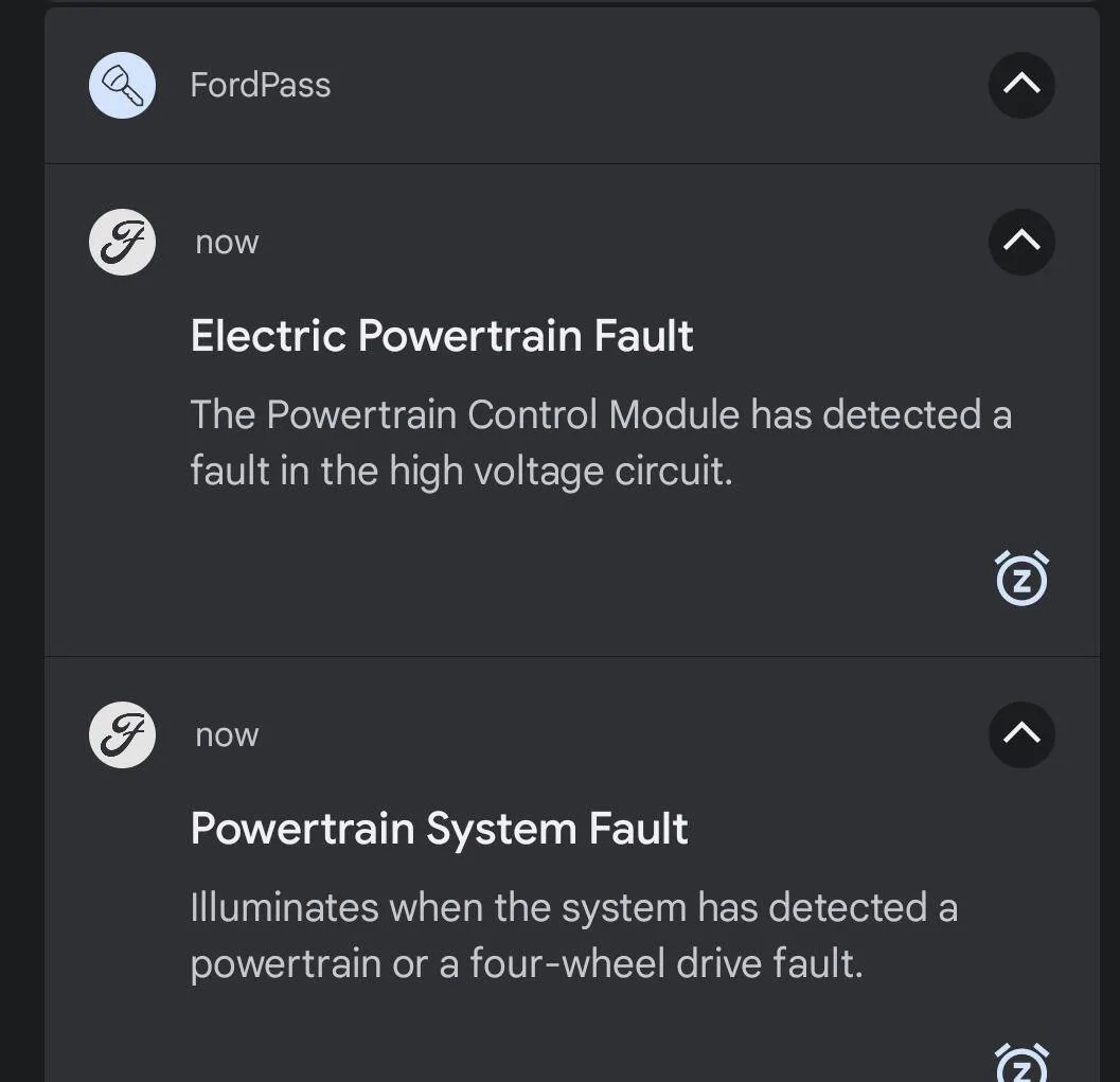

Ford Mustang Mach-E "HIGH-VOLTAGE BATTERY WARNING" - should I be worried Screenshot_20221103-125551~2
Popped up during my drive. Power is reduced. 76 percent battery. Afraid if I turn the car off it may not start again. Currently out and about.

You will need to see what codes are causing the warning messages to determine the severity of it.
If this turns out to be the HVBJB, you will still be under warranty for it since most of the high voltage battery electric system has an 8 year/100,000 mile warranty to it (the HVBJB is part of that warranty). Even if it turned out to be something else, your dealer can ask (or even self authorize) a goodwill repair since it is so close to warranty.
11,442
25,248
Yup, likely failing HVBJB based on what you've shown. It's covered by the 100k mile battery warranty. It should be okay to drive for the next few days until you can get it to the dealer.

I got it to the dealer yesterday, and it is a junction box issue. They have my car and have no idea when the part will come in as they have no ETA. I have a loaner...but a weird stipulation. I cant drive more than 500 miles. As a realtor who drives 3,000 a month and went electric to avoid gas prices, this whole situation is real crappy.
