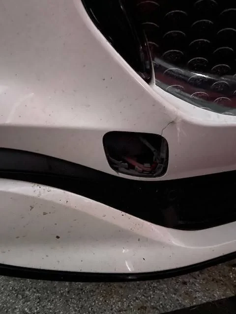

Hit a deer at the right front of the car, knocking out the "toggle" port. What is this called? And I have small crack, likely will have to replace the whole panel. Argh.

Ouch. Yes, you're looking at a few new panels there: the upper bumper piece that goes all the way across, the frunk access port, and the nose piece.

if it is me. i would buy that cover. Plug it on and call it a day. not worth it to start a claim for that little damage.

The 12v port cover can probably be ordered as a replacement part for a couple dollars at your local dealership.
if you want to try a repair of the crack rather than replacing the whole front piece .... find a roofer that installs heat-welded TPO, grind the crack to an open V with a dremel, and have them run a bead of ABS filler with air 'welder'..... then sand/prime/paint.
If you can't find a heat welder, dremel out the crack a bit, then drill very small (1/16" or 1/8") holes along the crack, and fill the crack with JB weld or some other sandable/paintable epoxy... pushing the epoxy into the holes to lock the filler on the front-side.
it will look 'fine from 5 feet', and cost maybe $200

That's my desired route, the dealer couldn't identify the piece, so thanks for that! I'm hoping it will "pop" into place and the "holders" didn't break too.
