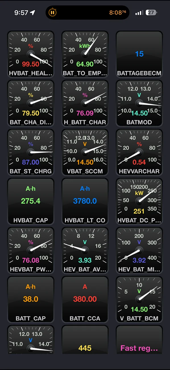

sergiomo
Sergio
Sep 1, 2025
42
62
2025 Premium RWD ER
Is HV SOH actually available for 2025 models? I have carscanner and a Bluetooth OBD plug and many of the properties are encrypted as of the 2025 model year. If there's updated hardware that allows access to those settings, I'd love to learn about it.
Yes. This is FORScan Lite. Not sure about other software.
