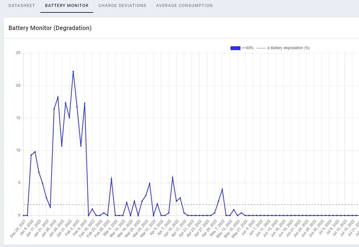

Tronity also provides this. Tronity used my user ID and PW to get to my data, which I should have been more careful about as others have noted.
Regardless, the graph doesn't seem right to me. Does it really vary like that over time? And then it flat-lined after the cold temperatures passed and never changed again. I removed my car to unlock my Ford user account, so no new data to see what happens this winter.

As far as I know, Li-Ion battery degradation isn’t reversible. Looks like crap data, IMO.
