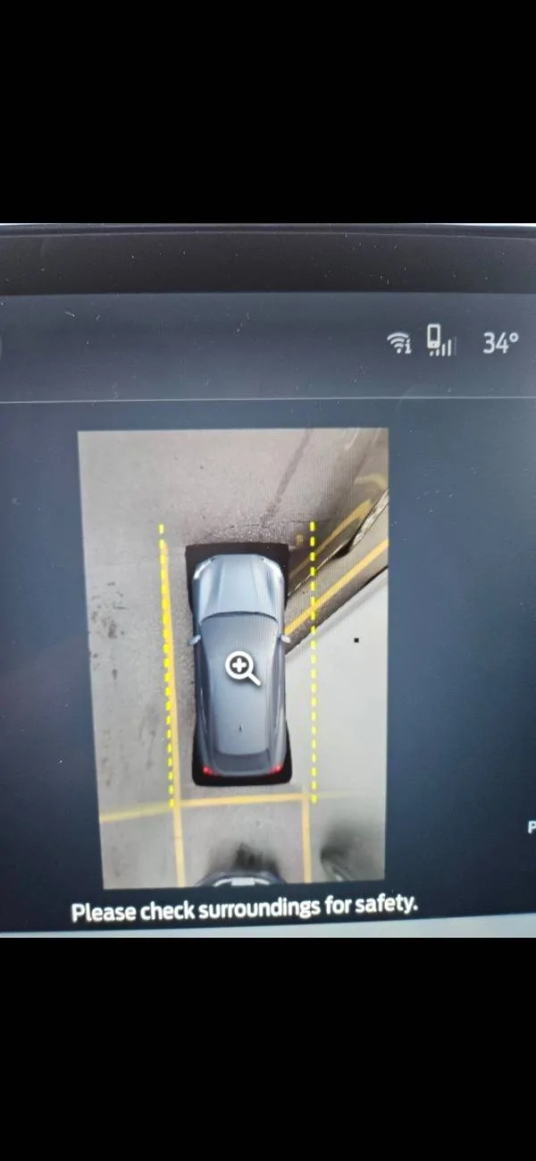

It seems the right camera is messed up. Nothing blocking or obstructing it. Tried turning the car on and off. Tried soft reset of SYNC twice but still the same. Take it to the dealership?

Is your right mirror folded out? They do move in both directions.
11,421
25,197
No although the view looks like that is the problem. I tried toggling the mirror folding button too
The doors were closed, right?
If it's still screwed up with the doors closed and mirrors unfolded, then the 360º camera/IPMA needs to be recalibrated, which the dealer can do.
