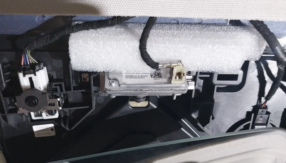

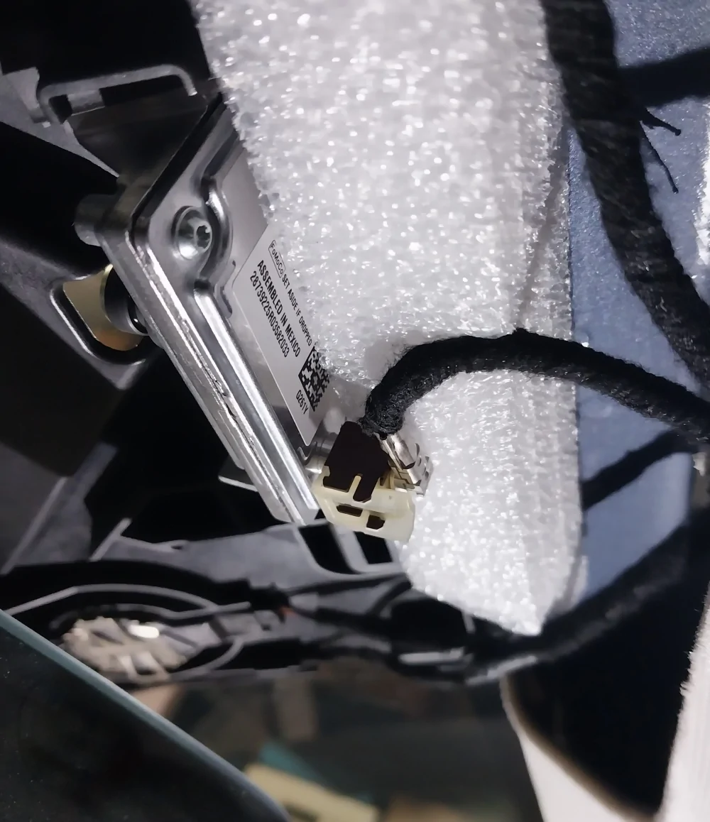

I have not replaced the cable, but I did insert a piece of closed cell foam behind the cable to pre-load the mini-coax connector and prevent jiggling. So far working well to prevent the random blinks on the highway.

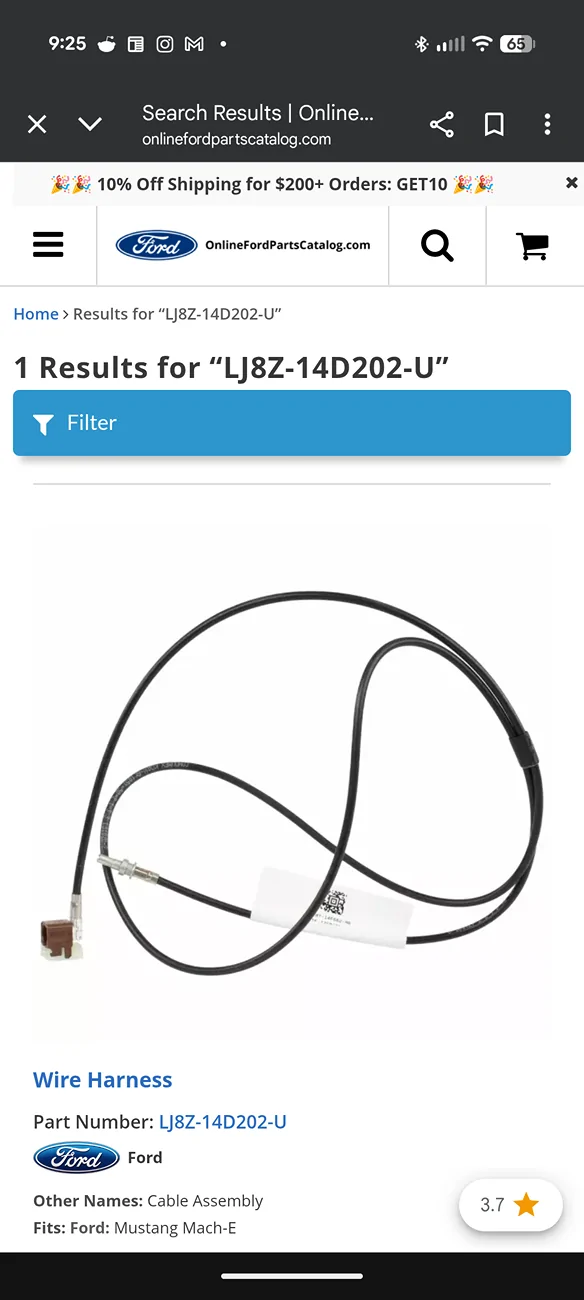

@someone22 - As you say, next steps, if you take it to a dealership, can be expensive. However if you are the least bit handy with tools and comfortable working on automotive interiors, taking one last step yourself could be as inexpensive as US$ 17-20. Replacing the short cable between the camera and the A-pillar connector is what finally fixed it for me. The cable is part number LJ8Z-14D202-U. At my local dealership it cost me $15. Please look at post #56 of this thread for pictures of my replacement. The most tricky part of the whole thing is getting the A-pillar cover off and back on, and opening up the A-pillar connector to get the new cable end installed. You don't have to drop the headliner because there is a small space between the windshield and the headliner which is just enough room to push the new cable into. And you don't have to remove the old cable.. Simply cut off the ends of the old cable and leave it in place, and lay the new cable in beside it.

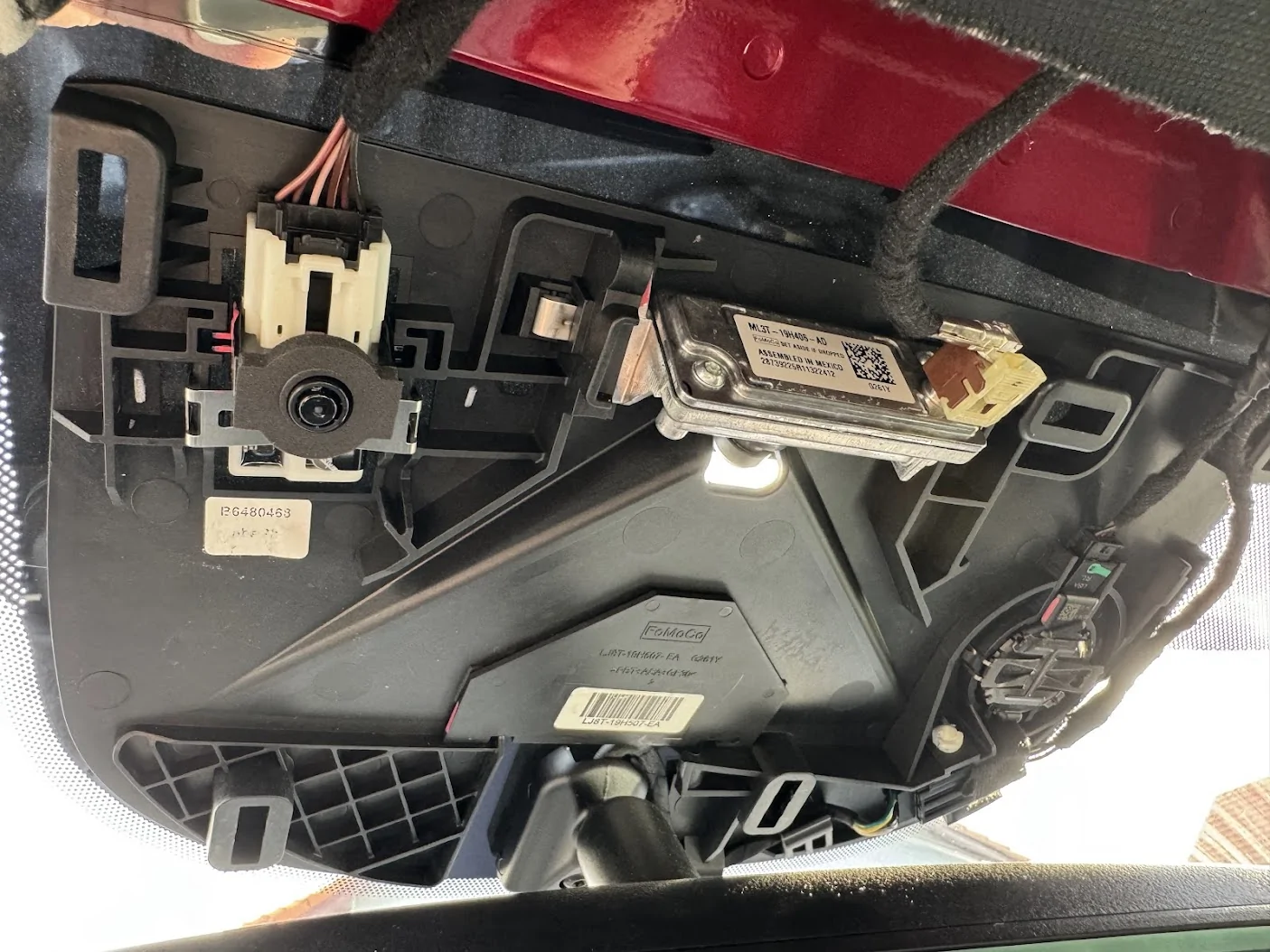

Thank you! I don't think my windshield was ever replaced but the car was bought used. Weird that your cable seems to go to the left but mine seems to go to the right A-pillar. I have the premium model with the glass sunroof, could that be the difference? Also don't have those buttons there (garage remote?).
Does the camera get power from the coax? I mean, it is possible but I've rarely seen it done in the automotive world.

@someone22 - The cable from the camera runs immediately into a wiring harness with other wires and goes along the very front of the headliner over to the driver-side A-pillar. My car is the same as yours: glass sunroof.
And to answer your coax question, yes the power and video signal run through the same single coax cable. There is no separate power connection. So if the slightest thing is wrong with that cable, power and video signal are both affected.
When I first purchased my GT (also used), it had a big chip in the windshield and the dealer agreed to replace it. Prior to replace the windshield, the vision system was working perfectly. When the windshield was replaced, the glass tech broke the first new one during installation and so had to order a new one. After they finally got the second one in without breaking it is when my camera faults started happening. The cable got damaged during that process, even though it looked normal. I tried all of the other things to get it to work, but no joy. I just decided to switch out the cable and that's what finally did the trick. Over 2000 miles now with no camera faults. Took about 2 hours.
Good luck!

@someone22 - I ordered one from onlinefordpartscatalog.com. US$ 11.56.
LJ8Z-14D202-U
My local Ford dealership also had these in stock.
