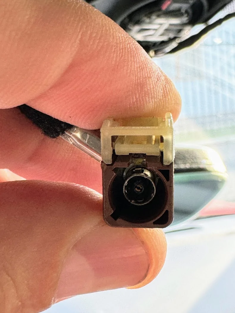

I'm having this problem at an increasing rate on my 2021 GTPE. At one point last summer, I pulled the lower cover off of the camera mount and straightened out the coax cable connected to the camera. Once put all back together, no more faults for about 3 weeks. But now the problem is back and getting worse. It may work for an hour but then fault when gong over railroad tracks, it may fault 3 times and clear itself in quick succession while taking a 10 minute drive to the store. This is literally the only thing wrong with the car. Very frustrating.
So in an effort to take another look at it and perhaps try the foam sandwich fix, I attempted to remove the cover again. This time, the plastic piece that is glued to the windshield broke off completely. So now I need to reattach that piece before I can proceed. I need to say here that my windshield has been replaced 2x.
@Mach-Lee perhaps you can answer a couple of questions for me.
I ran across a video of a MME windshield replacement. In the video, a picture of the new windshield showed that the plastic piece that holds the camera and a couple of other sensors was pre-attached to the windshield. Is this true?
I am debating trying to reattach this piece myself (3M Extreme double sticky tape or Epoxy putty), or taking the car to a glass shop and paying them to do it with some super-dooper adhesive. If it is true that all new windshields come with this plastic piece already attached, perhaps the glass shop has never had to remove and reattach this piece and would not know how to do this operation. Advise please.
Question number 2: How does the coax cable attach to the camera? Like many others here I've tried pulling on it with moderate force with no success. The metal termination of the coax cable rotates freely in the camera body but is tightly surrounded by plastic bits. Is there a way to unlock the coax cable by removing a plastic clip or must one simply pull on the coax real seriously? If this is a plastic locking clip, how does is come apart? Being an electronics technician for 20 years and a Quality Engineer for 20 more leaves me very comfortable with coax and connectors and electronics in general but I've never seen a connector like this one. How does this thing come apart?
My reason for wanting to disconnect this piece is to look it over for any possibility of an intermittent connection, either in the center conductor or the shield. Signal integrity being a key point here, many including myself, report that hitting bumps, temperature changes, strain on the cable and whatnot can cause the fault. All of these things smack of intermittent connection and fluctuating signal integrity.
Any suggestion you might have greatly appreciated. Thx in advance.

Found this thread quite late, but there is a small clip that you need to press before pulling on the camera connector.
Ford Mustang Mach-E Front camera fault fixed? 1780496855092-st
