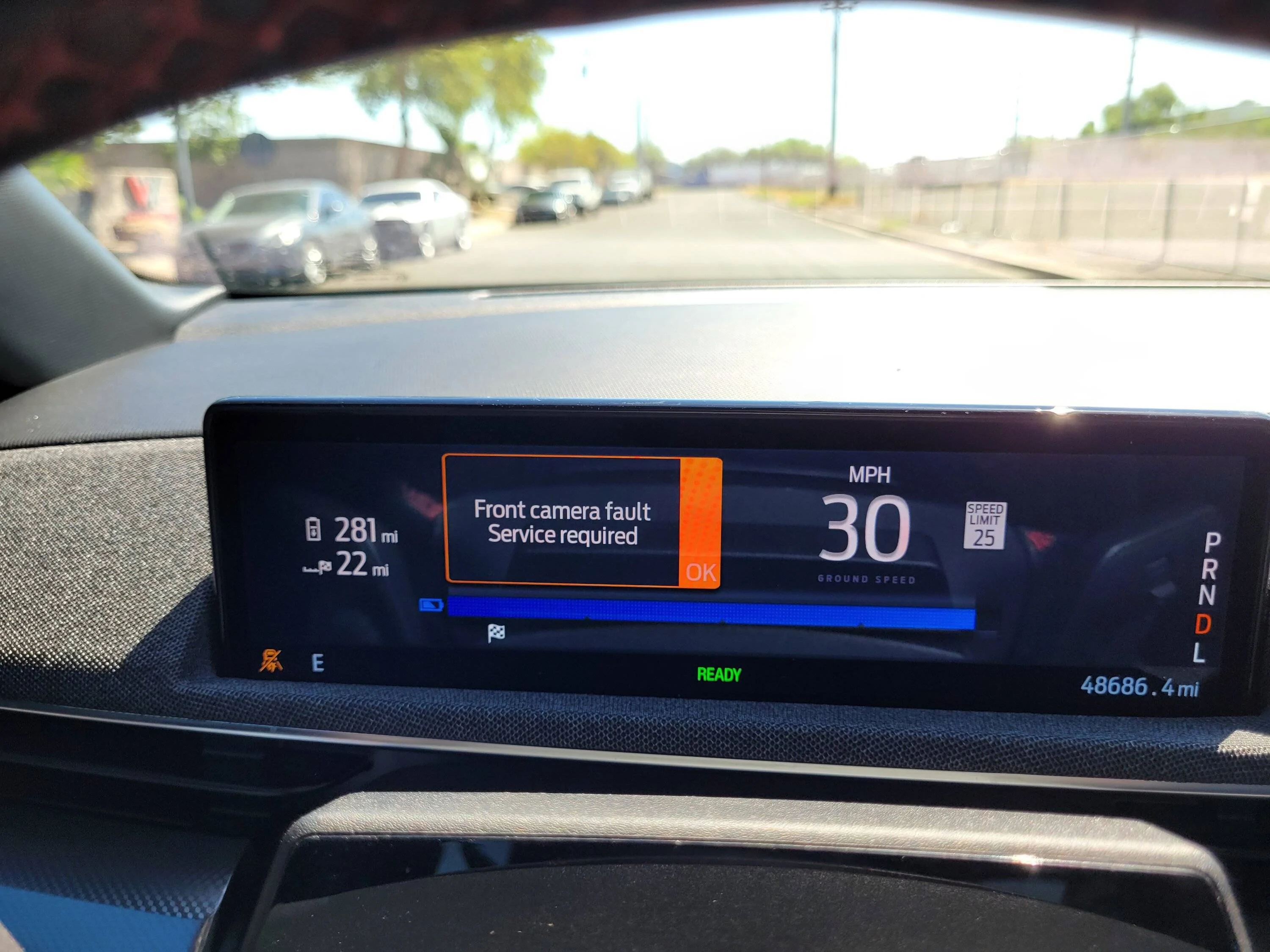

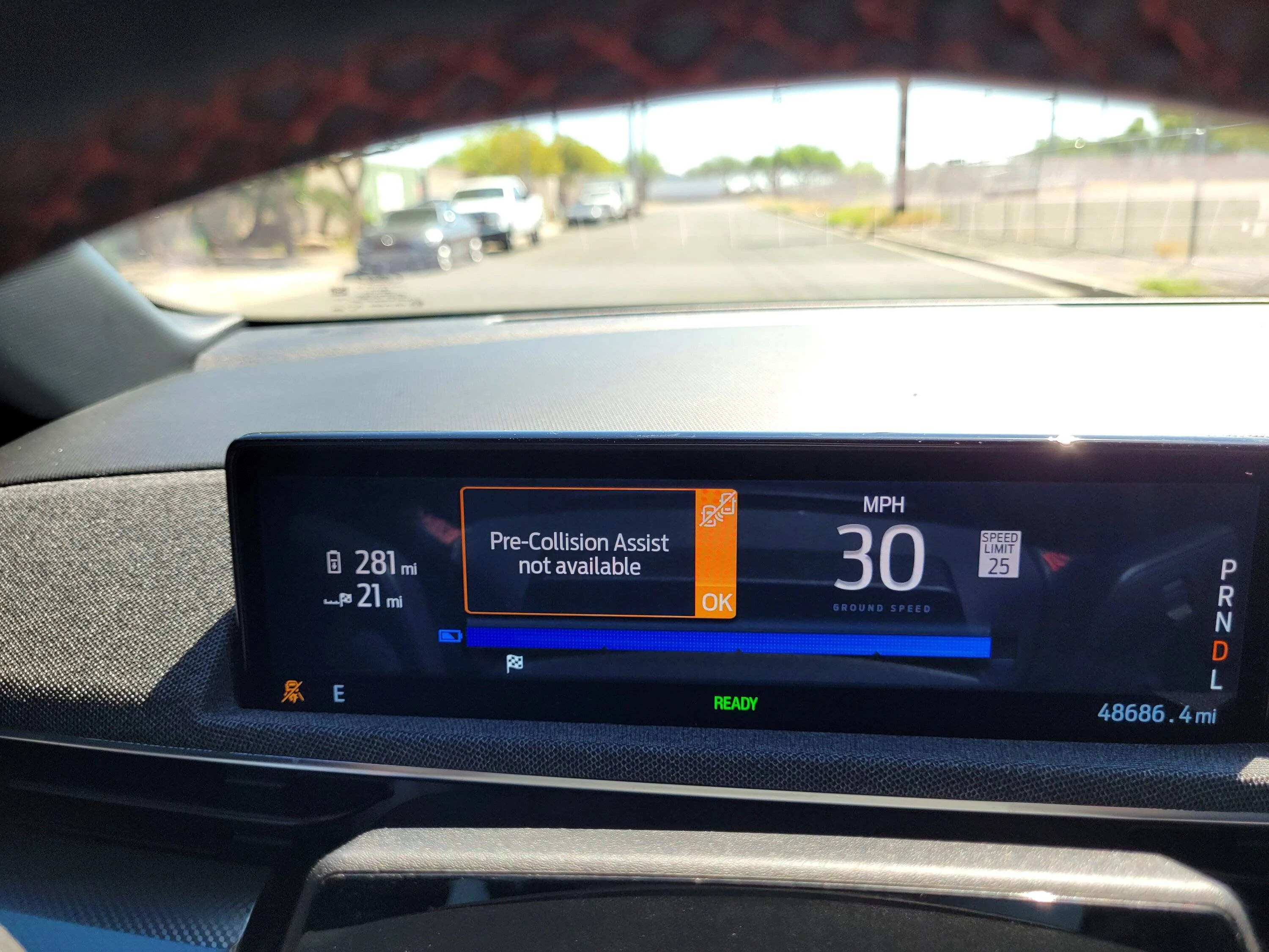

My Mach E has been in the shop for 3 weeks for the recall along with the front camera fault. The module was replaced and it still giving alerts that’s pre collision is unavailable and that the camera is out. Dealership has no idea what to do and this is my second time bringing it in for the same issue. I’m seriously close to trading it in. The recalls aren’t a problem for me it’s just that’s no one can figure out how to fix the problem so it’s just sitting at the dealership. Anyone have success with fixing the problem?
My 2021 mach e select has a front camera fault at 35k miles , it says service is required. I think it sucks that there's no solution yet for others with the same problem. Because of what i've read on forum i've decided to drive it as is for now. I have a gas car but gas is like $6.89 cents to fill up right now around San Diego. I will keep reading thread to see if someone found a dealer that could fix the problem.
