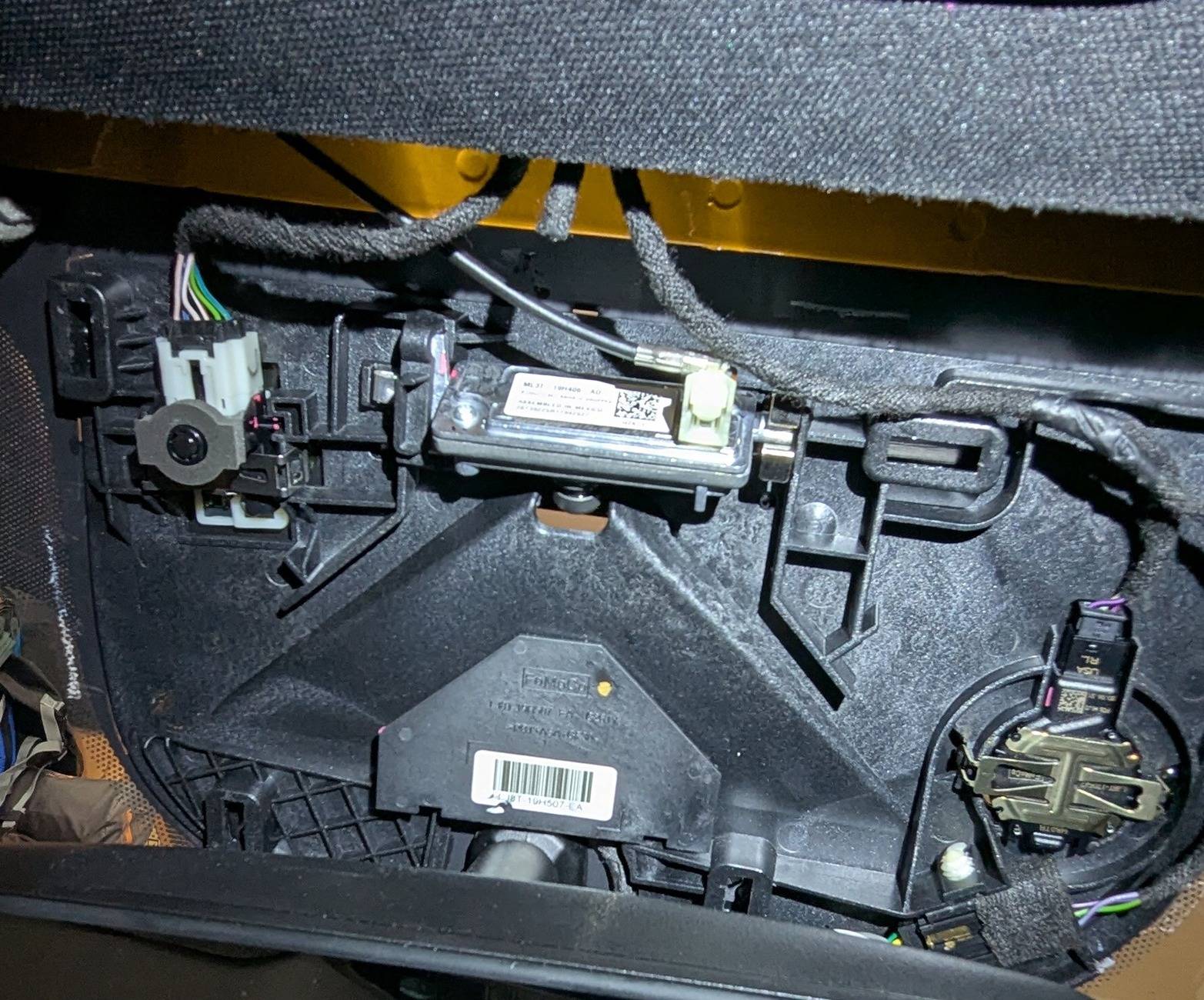

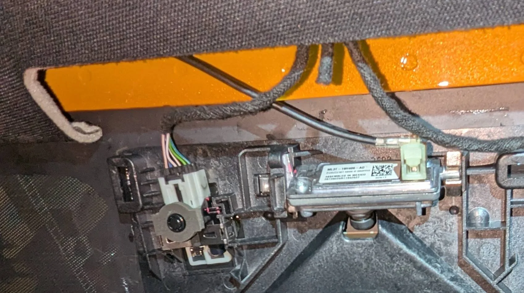

Okay, I installed a new coax cable today from camera to A-pillar. This turned out to be less of a job than I had imagined. I was surprised. The only tricky part was getting the coax cable out of the white connector in the A-pillar. I've attached a few snaps of the process.

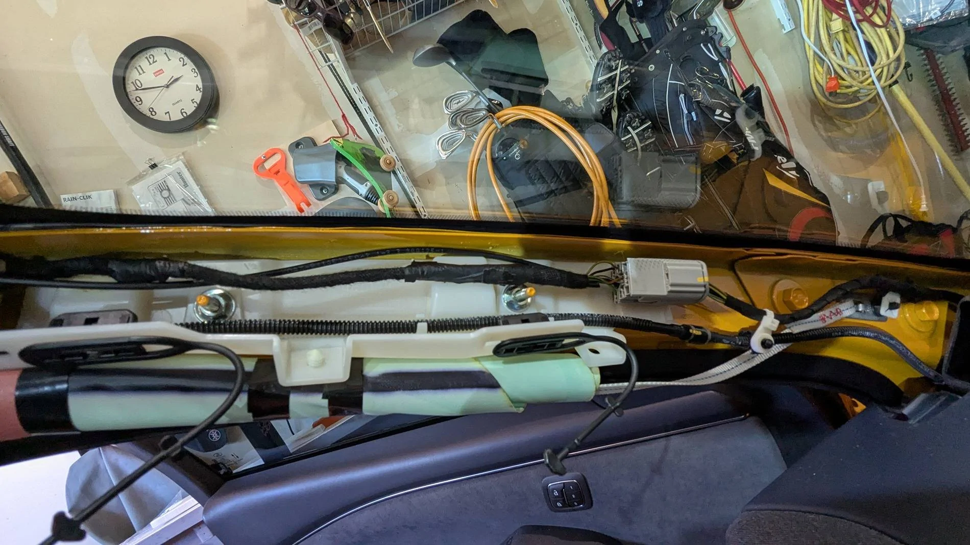

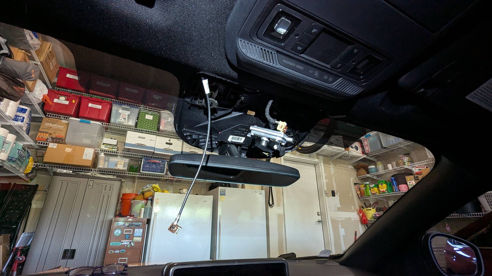

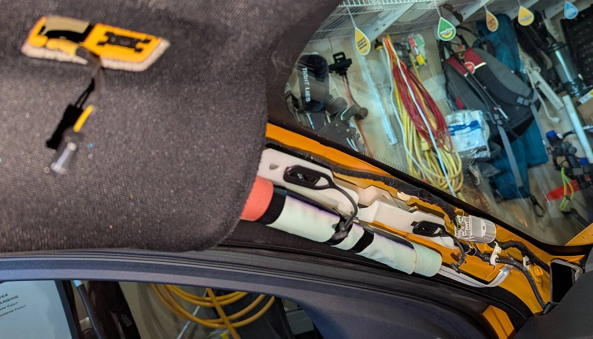

First I removed the cover from the A-pillar and the cover under the camera (rear-view mirror). Also removed the driver's side visor to make it a bit easier to deflect the headliner down.
There is already a gap in between the front edge of the headliner and the windshield. The new cable can lay right beside the old cable (which is wrapped in a harness). I just pushed the new cable up into this gap and the free ends came out of the headliner by the camera and down into the A-pillar. Having the visor off helps as the gap there is tighter.

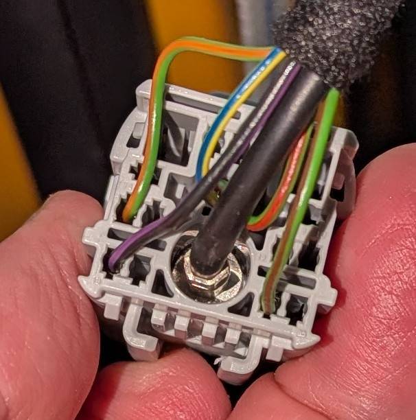

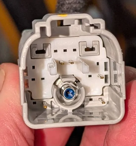

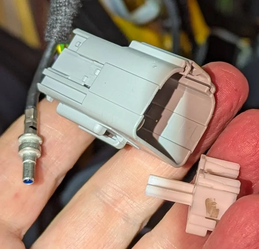

Once the cable is routed, you need to extract the old coax cable from the white C900 connector in the A-pillar. Not so easy. It's a custom FoMoCo connector and it's a puzzle. Separating the two halves of the connector is straightforward. Press a tab and pull. To get the coax cable to back-out of the connector, you have to remove a white plastic block from inside the connector to access 2 little spring clips that retain the coax. Unnecessarily complex and not for everyone. After getting the coax out, reverse the process and snap everything back together: coax, white connector block, 2 connector halves. Then reattach the connector body to its A-pillar mounting point. Be careful to run the new cable behind and out of the way of the airbag and up into the headliner.
Disconnect the other end of the old cable from the camera and connect the end of the new cable to the camera. Before putting the covers back on, cut the connectors off of the old coax, both ends.
No need to remove the old coax from the car. Just leave it there. It's wrapped in a harness anyway and hard to remove. Keep all cable bends as smooth as possible.
This project took about 2 hours. Fully a third of that time was spent figuring out how to separate the coax from C900 and not break anything. If doing it again, I think I could do it in under an hour.
I took the car out for a couple of errands and a total of 28 miles and so far, no camera faults.
As before, I will not call it "fixed" until a week or 2 or a month goes by with no faults. Fingers crossed. I'll update in a week. Questions, Let me know.

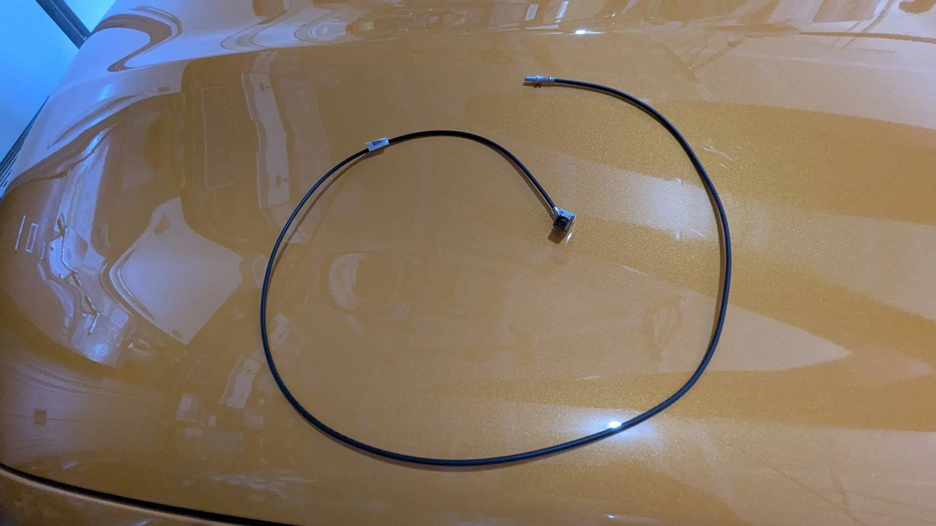

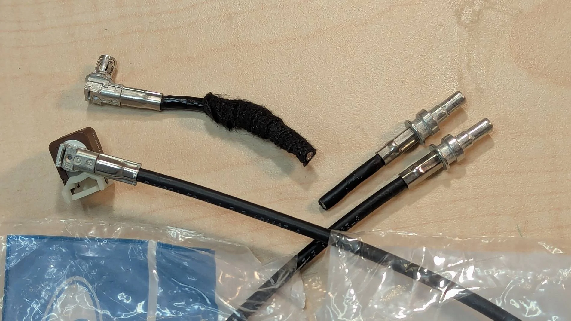

I hesitate to report (because the front camera fault gods are watching. They're always watching) that I've driven 250 miles in the week since replacing the camera to A-pillar coax and have had no faults. It's been great not having that stupid fault message every time I drive the car! I've even gone out of my way a couple of times to get on some rough roads. Encouraging.
If anyone else wants to try this, attached is a snap of the Ford part.

I may have missed it in this thread, but does this part seem improved in any way vs. the original? I know you didn't remove the original but was wondering if you noticed any difference. I too am having front camera fault issues and have tried to get it fixed under warranty, which did work for a time. Now the car is off initial factory so I'll probably be doing the same. Thanks!
GT-Papa
GT-Papa
Nov 15, 2023
174
232
Denver CO
2021 Mach-e GTPE
Retired Quality Engineer
@bergmi
Just in looking at the part, it did not appear any different except that the original is enclosed in a cloth wrap at the camera. Under the cloth wrap, the cable looked the same, and the connectors on either end were exactly the same.
Not an improved part, but rather you are replacing the damaged cable on your vehicle, which fixes the problem.
