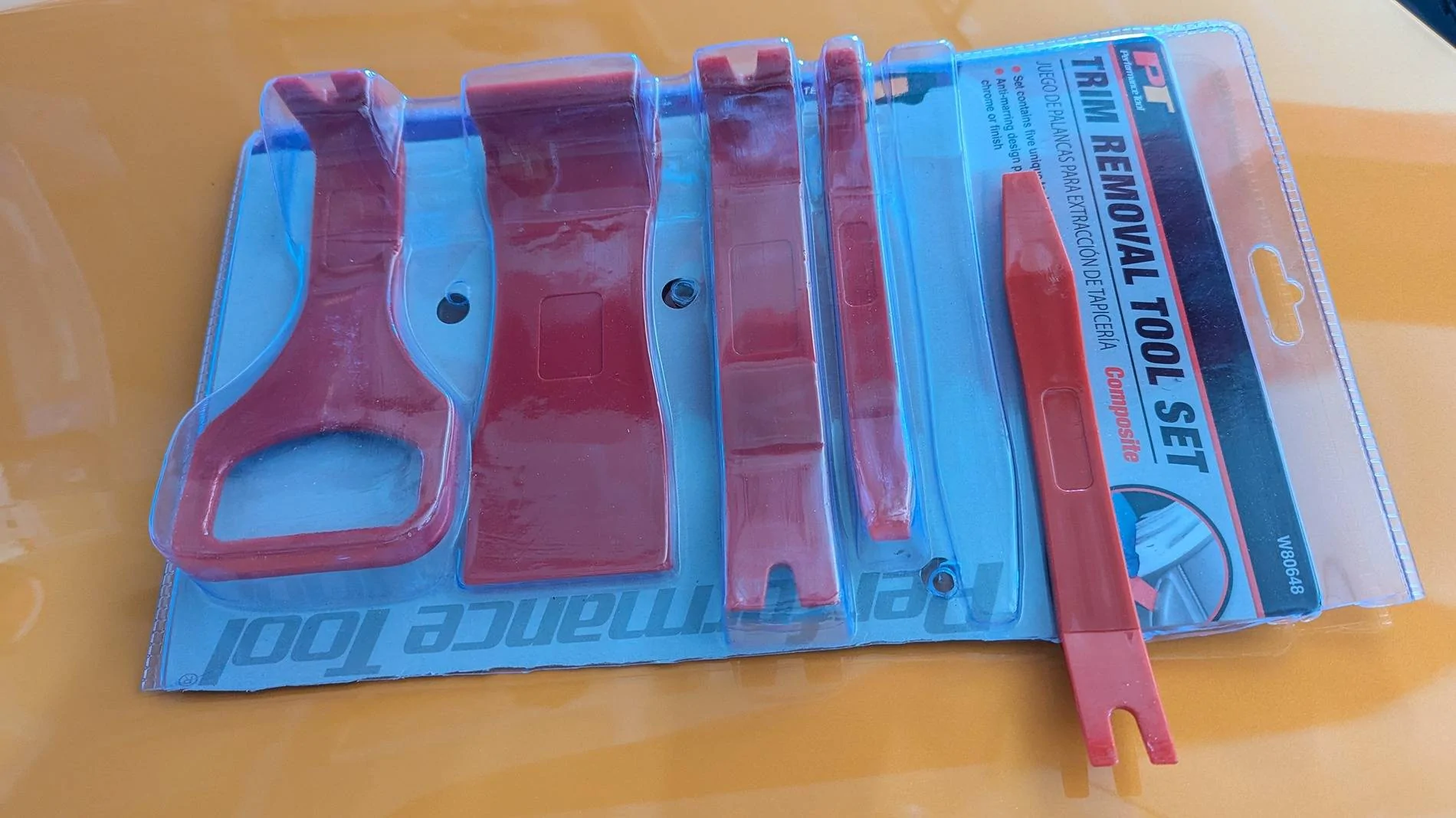

Does anyone have recommendations on how to remove the plastic covering without breaking anything?

A trim removal tool like the one on the right works great. Cheep on Amazon or probably readily available at any auto parts store.

I popped it off with my fingers. Starting at the sunglasses area, pulling towards the center console. then just worked around in a circle until the panel came off. This would be one of the easier panels to pull if I must say.
it just pops straight away perpendicular to windsheild... not too bad if you pry close to the tabs, you won't break anything...
